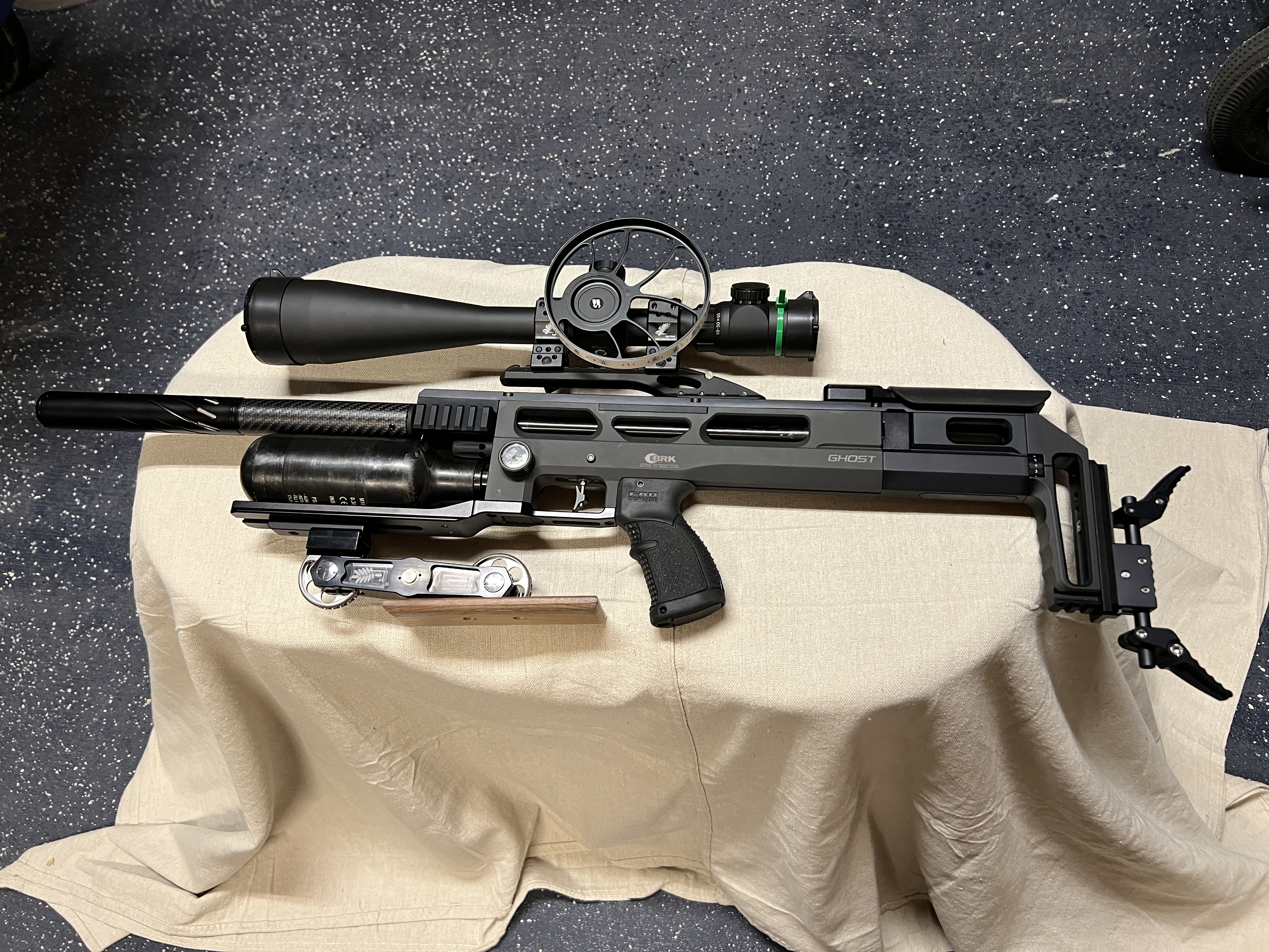

I've become obsessed (kind of) with creating the better / best / bestest ever barricade stop.
Typically i have to scrounge around to find something that will adapt either a pic rail widget, or a UIT rail widget or an Arca rail widget because my airgun collection has all these options... Wondering what all you creative airgunners have come up with
my discipline is HFT so i don't get to use a clamp or screw in type bipod / tripod ---- it has to fall away from the sticks when lifted... dems da rules and it can't be lower than 6 inches below center of barrel forward of the trigger guard. Knee risers or hamsters create other challenges.
I shoot mostly off of trigger sticks.

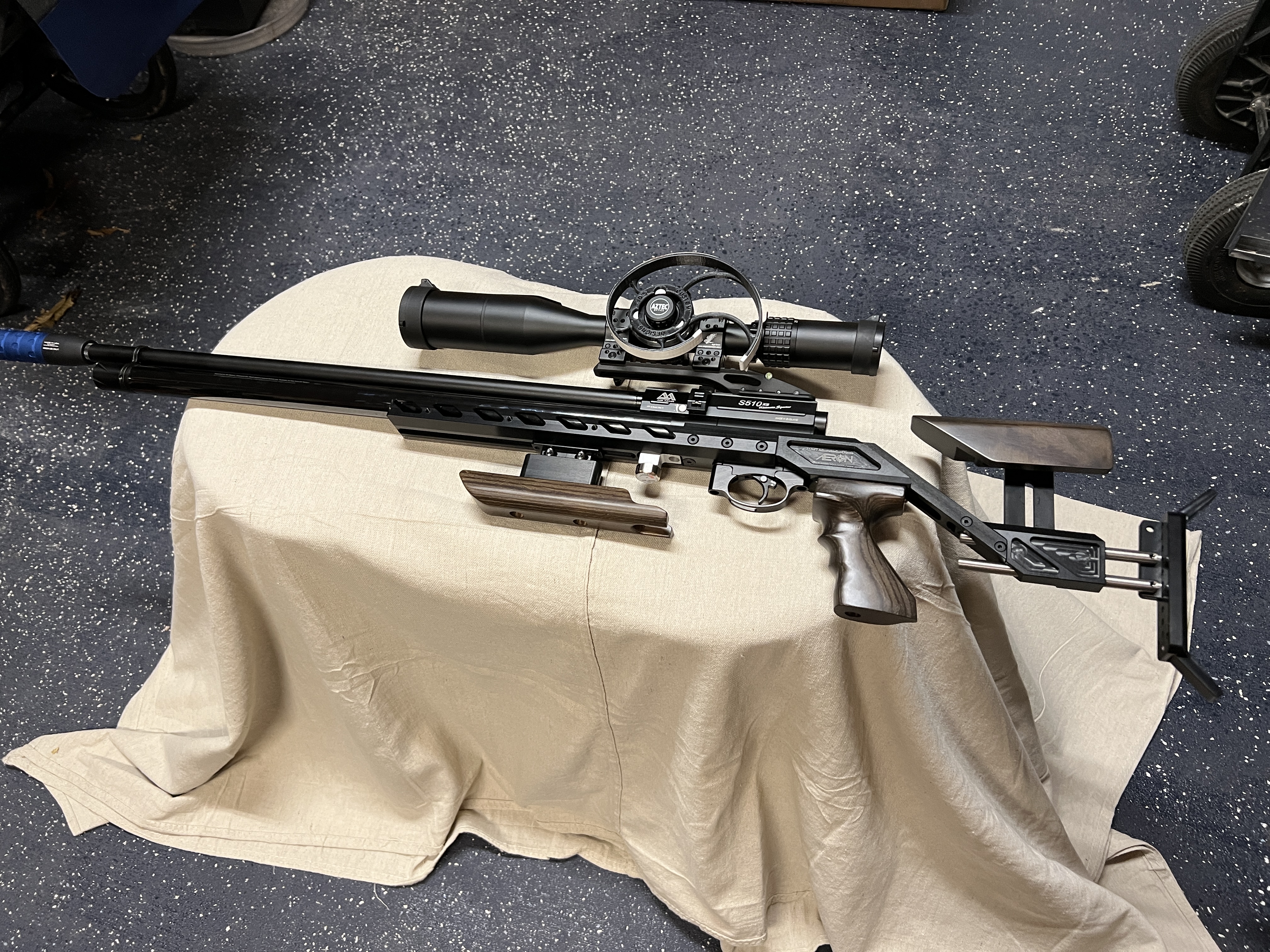

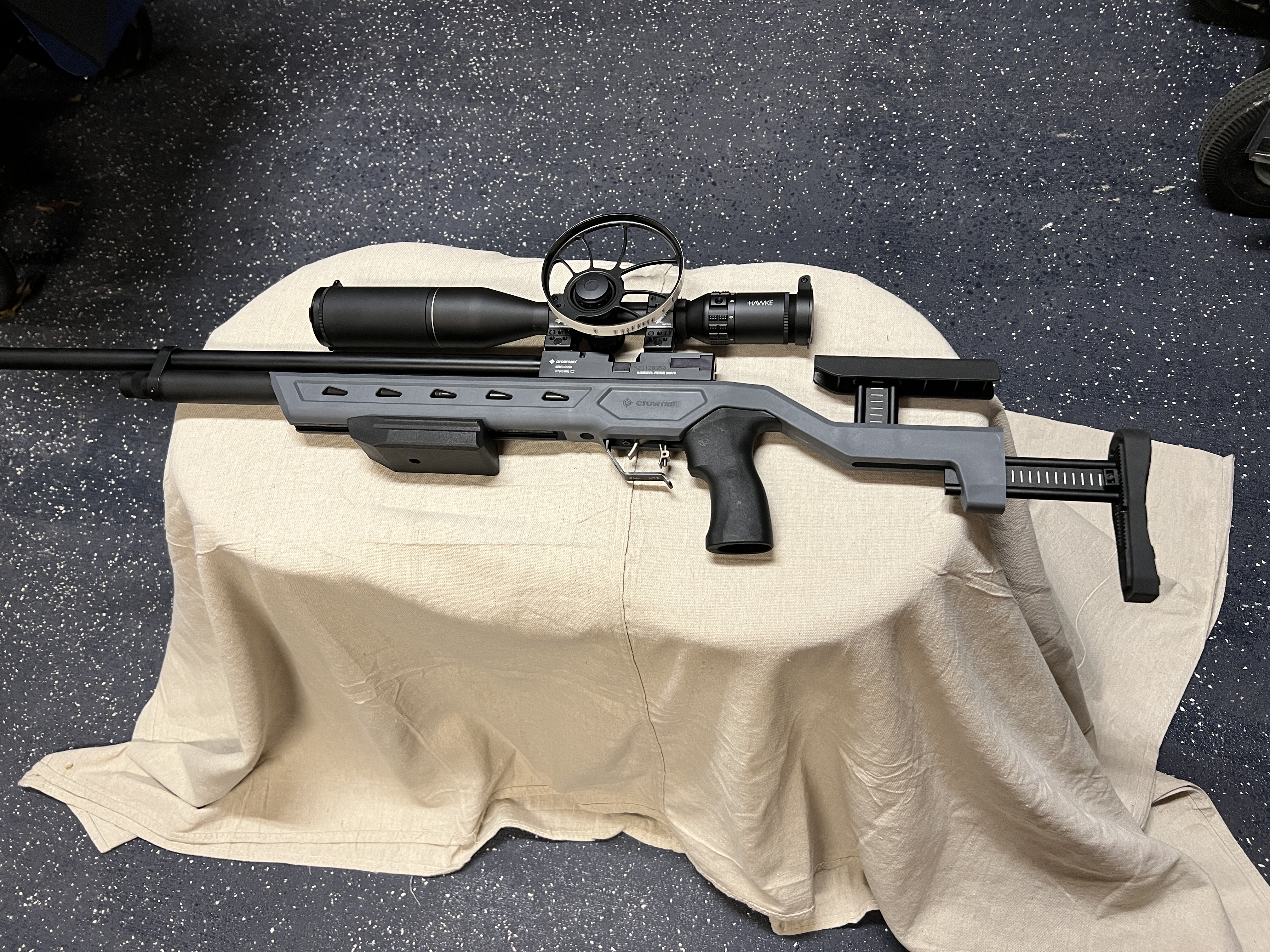

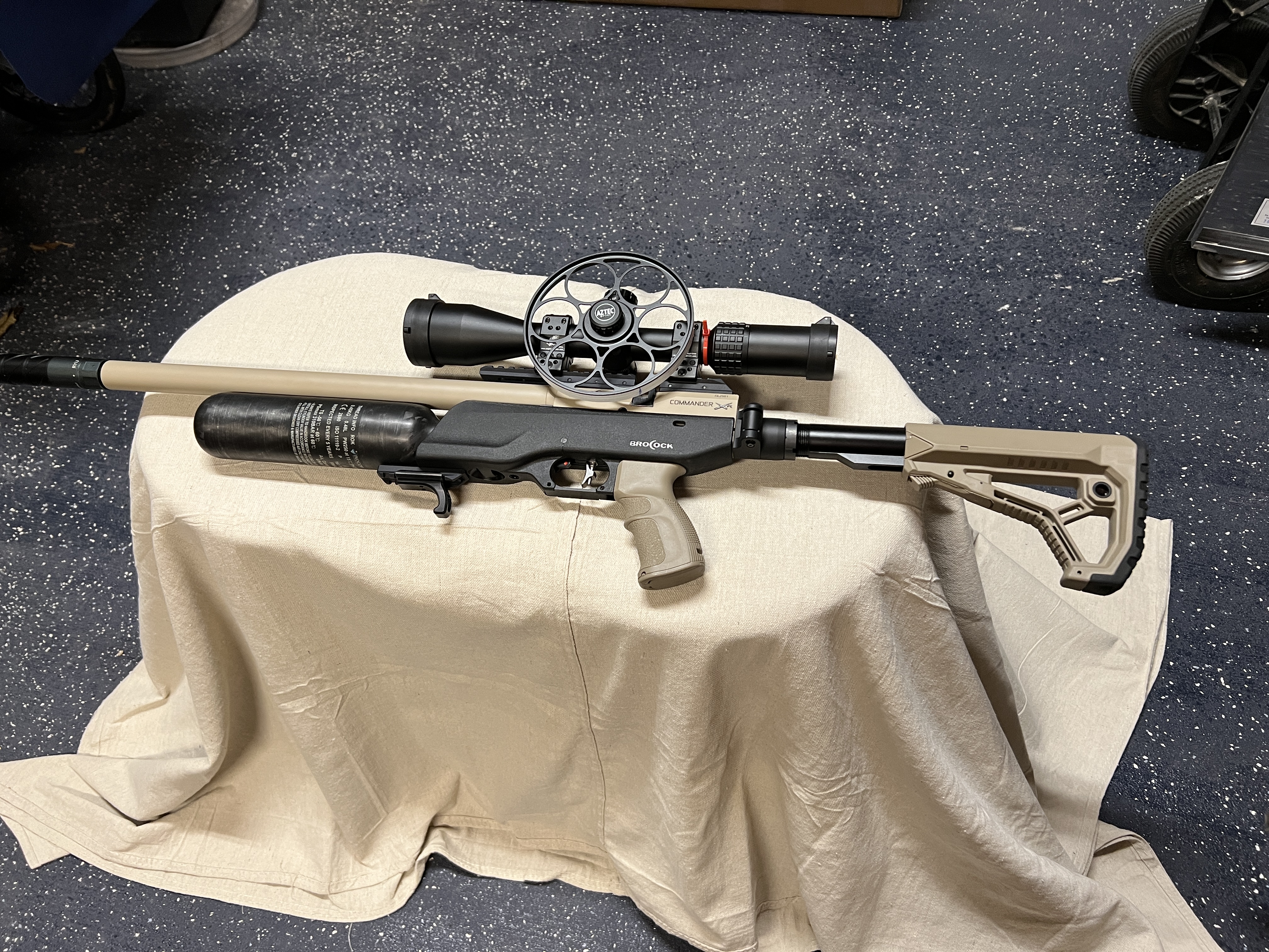

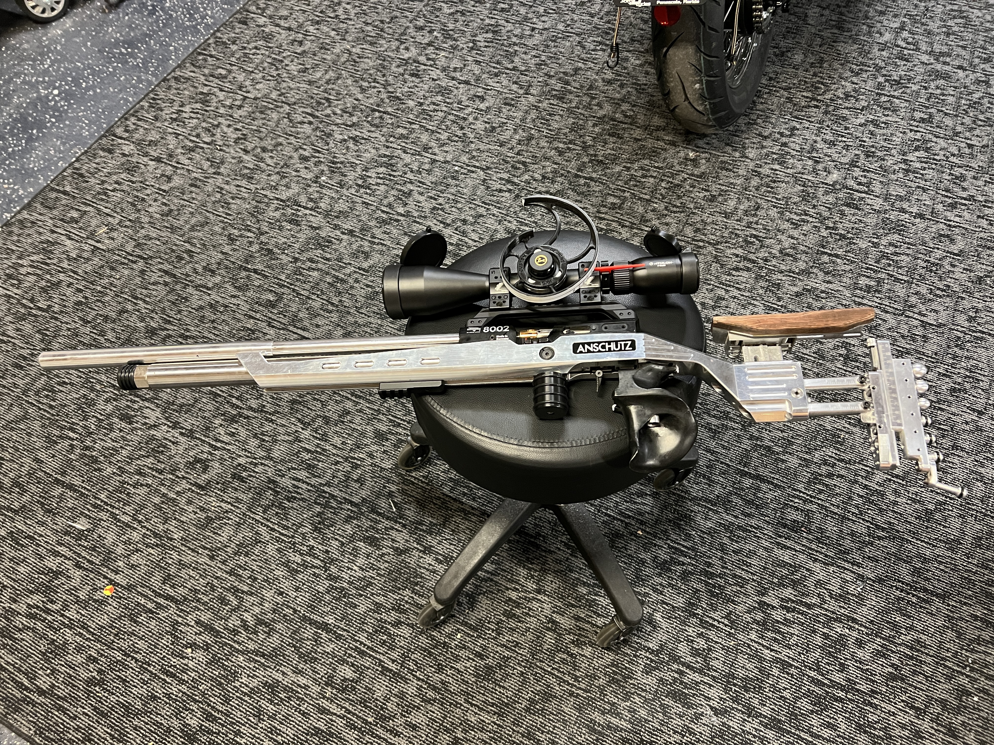

first is a picture of how i stop my sticks for my HFT TM pistol using kinetic M-lok QD's one on each side of the chassis, second is a pic of how i stop my sticks on my Anschutz 8002 using a PRS UIT type gizmo. Third pic is the hamster/stick stop combo that comes stock with the Crossman HFT Challenger. fourth pic is my Ghost carbine with a Rowan hamster and custom plate to comply with da rules.
my discipline in HFT so i don't get to use a screw in type bipod/tripod ---- it has to fall away from the sticks when lifted... dems da rules and it can't be lower than 6 inches below center of barrel forward of the trigger guard.
I shoot mostly off of trigger sticks. first is a picture of how i stop my sticks for my HFT TM pistol, second is a pic of how i stop my sticks on my Anschutz 8002 using a PRS UIT type gizmo,

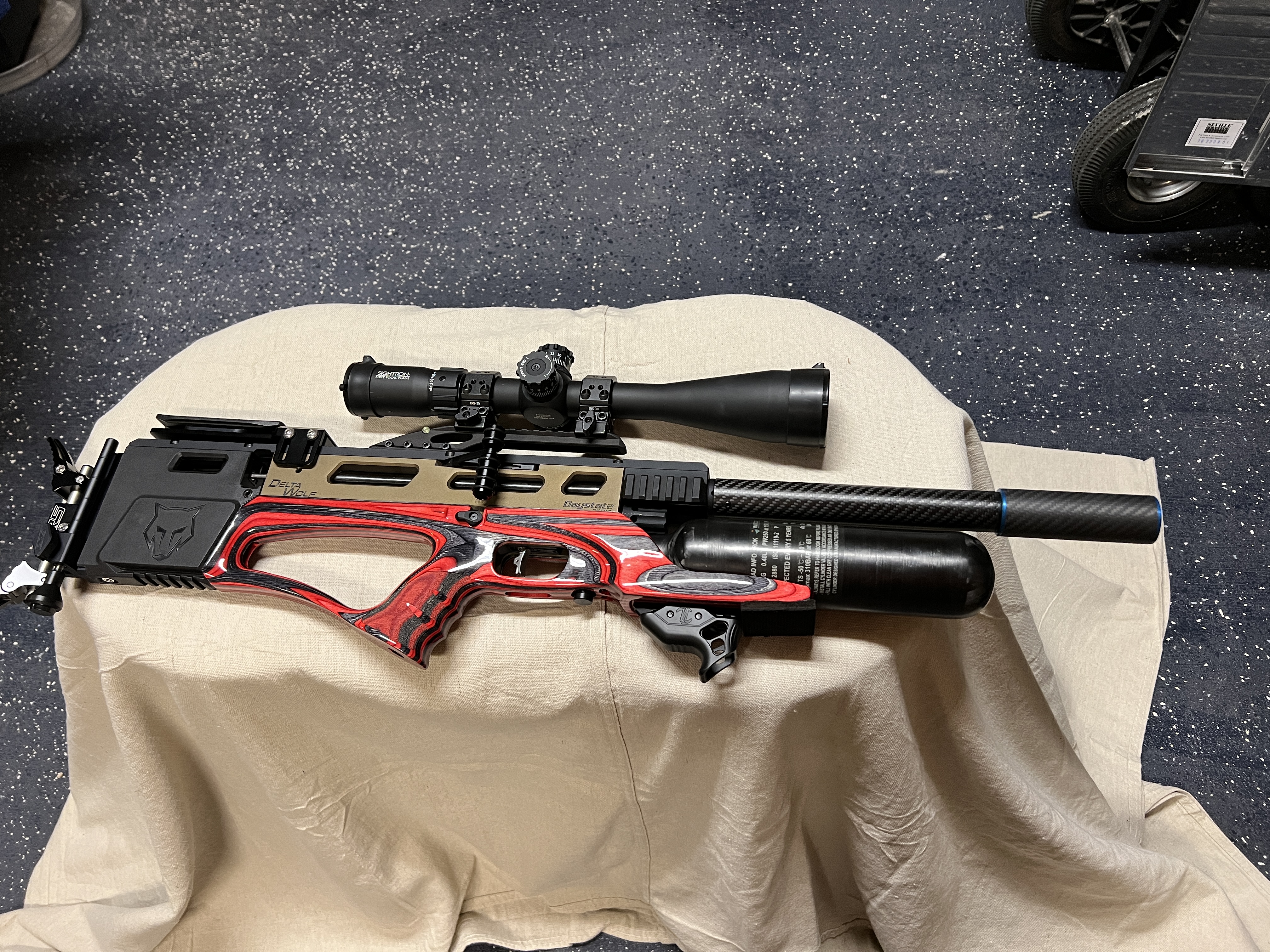

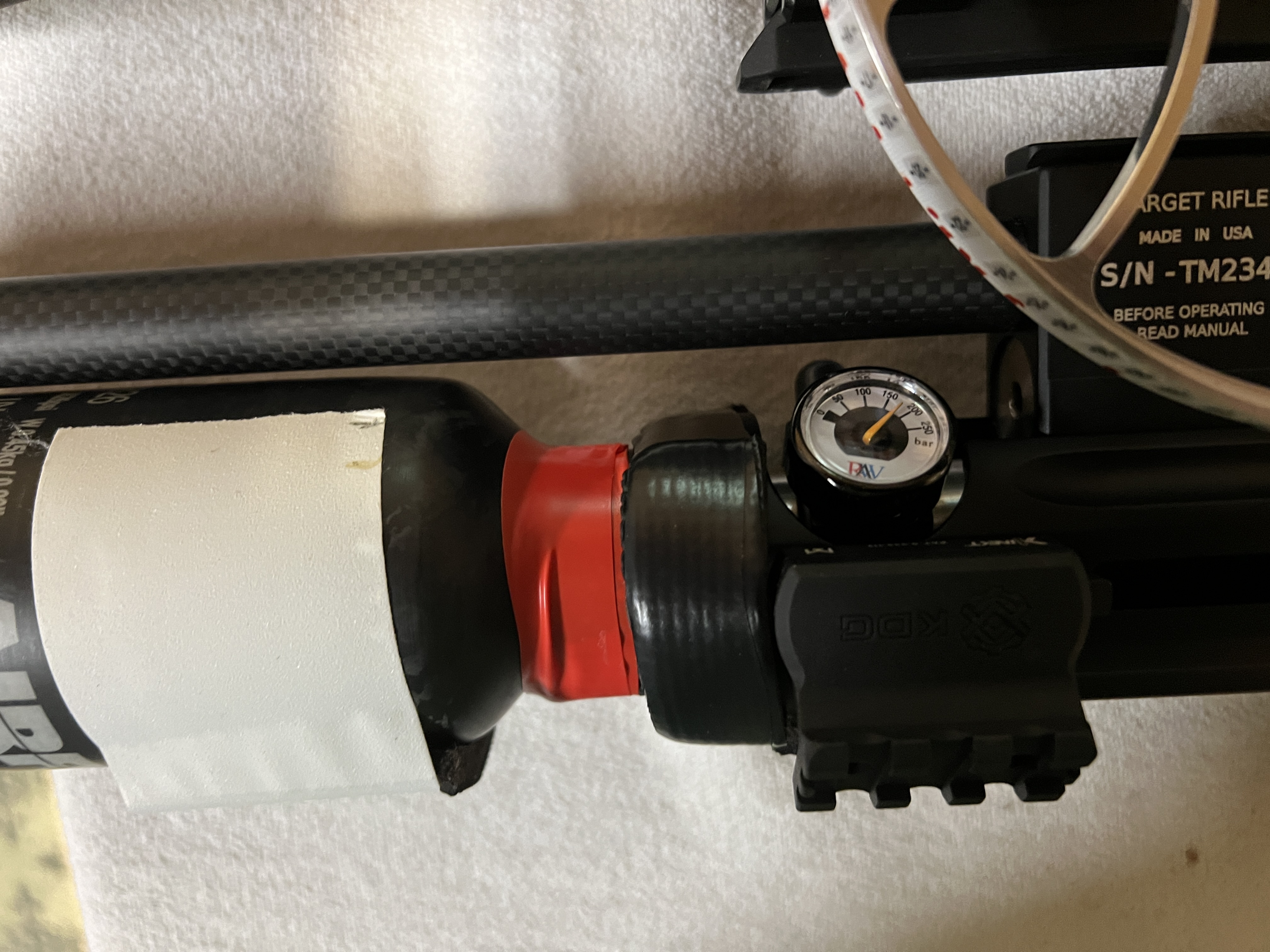

the below Pic accessory installed on my BRK Commander XR is perhaps the most simple and i like that it keeps the weight off the bottles neck and yet keeps the fill port accesible
the below Pic accessory is perhaps the most simple and i like that it keeps the weight off the bottles neck and yet keeps the fill port accesible
but the same type item on my Daystate Revere puts the weight too far forward of center of balance and isn't as stable.

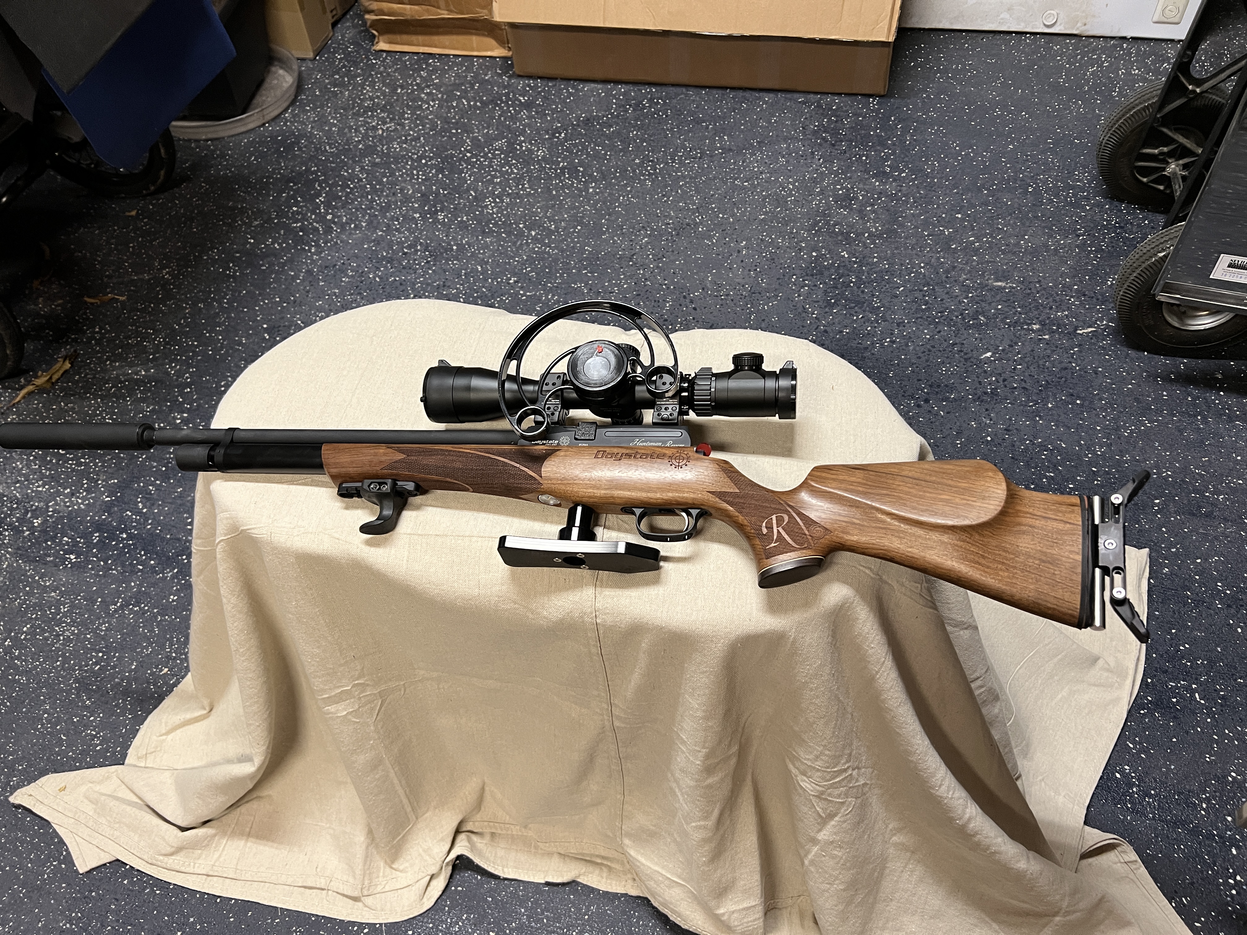

One more - installed on my Deltawolf in Alphawolf clothiing, using pic rail but i had to add some neoprene as i do NOT like the way the sticks would mar the finish of the stock if i used that point with no protection. I could also reverse the direction this accessory faces but that raises the resting point and the gun becomes tippy in the sticks....

That Anschutz make me think of some sort of plasma rifle in the 20 KW range.
It was a 6 ftlb gun AZ converted to 16 ftlbs but we set to 12 ftlbs for WFTF purposes... it's in a rare precision stock and used to belong to the 2012 olympic gold medal 3 position champion!
One more - installed on my Deltawolf in Alphawolf clothiing, using pic rail but i had to add some neoprene as i do NOT like the way the sticks would mar the finish of the stock if i used that point with no protection. I could also reverse the direction this accessory faces but that raises the resting point and the gun becomes tippy in the sticks....tView attachment 435661
The below pic shows how i interfaced a TM1000 in a chassis form using Kinetic 45 degree QD points with M-lok interface - one on each side
Plus i also added an M-Lok barricade stop at the bottom of the chassis. looks cool but in this configuration the gun behaved tippy as not enough weight was below center of gravity; notice also that the verticle stop didn't allow the sticks to snug up to the trigger stick yoke.

this Crossman 1720T suffers in the sticks because the pic rail is too far forward of center of gravity and balance point to sit nicely in the sticks.
Ideal weight distribution would suggest the sticks sit right under the forward scope ring.

The Crossman HFT Challenger uses a plastic block which i'm still trying to find the best position for - i' thinking more toward the trigger guard?
