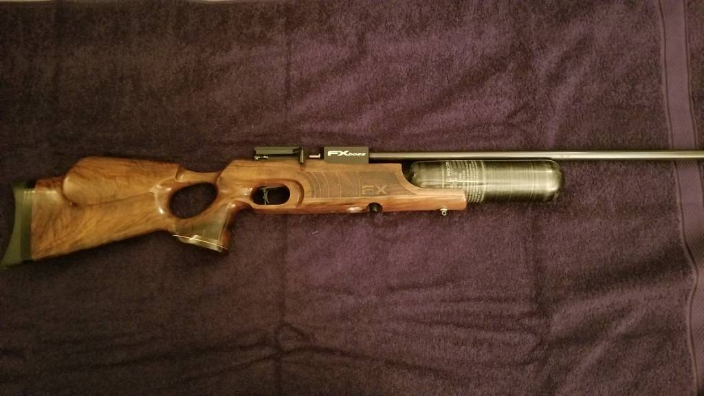

The rifle in it's present form is extremely accurate with pellets, which is ok if you're hunting feral beer cans or poking holes in paper targets. I have two choices, sell the Boss and buy something like a Kral Bighorn .30cal or find a barrel for the Boss that will shoot pellets and slugs.
Whenever I try to shoot slugs with the smooth twist, I can literally watch them corkscrew down range.

If you're prepared to spend 250-300 or so and want that route I'd say do the Boss with an unchoked .30. With a 28 inch barrel and running 170-180 with a Huma or even a stock one at 170 it'll make near or at 100fpe, maybe smooth the turn on the brass inlet or use one of those new modified ones with the bridge would be better for slugs anyways.
If they can do the crown at the machine shop great but it can be done at home but the leade is important too so maybe a gunsmith would be best. Finding a good shop is an important step the rest is easy.

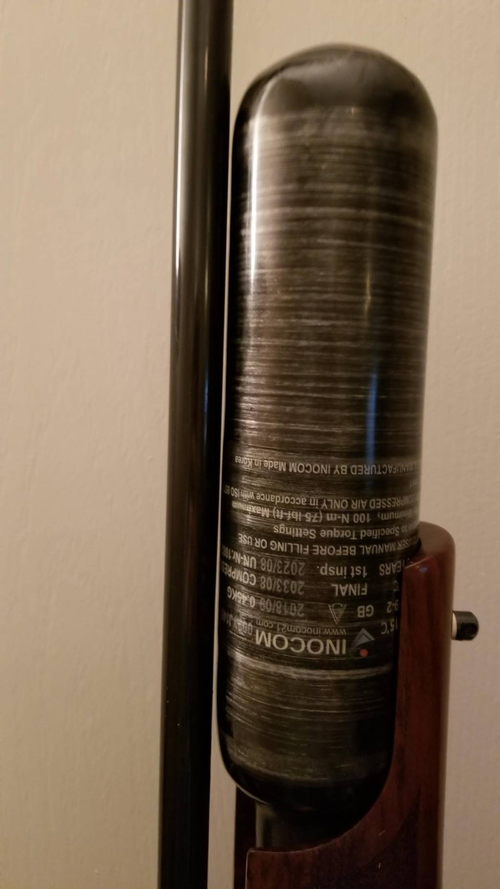

Also the OD is very close and depending on your bottle (CF or aluminum) it might touch so getting maybe 1mm taken from the OD would be a good idea. I had to remove a small amount from the barrel in one spot to make it not touch the bottle there.
Boss can be setup in other calibers using the cocking parts from a Royale (probe etc) This is a .22 LW poly unchoked and the same OD. It'll be raw steel so you'll need to blue it or something. I used birchwood casey cold blue and it's pretty good. Not as good as a pro bluing job but you can redo it until you're happy with the results and can be touched up anytime with some sanding and another application. It blends very well.
And all this does nothing to the gun itself, you'll always have that smooth twist barrel you can slide back in and it'll be the same as it ever was. Does nothing negative to the gun.
*And make sure you have the crown and work done on the correct end of the barrel it is possible to do, even an unchoked barrel has a muzzle end.
Well, the way I look at it, if I sell the Boss I'll lose about $400. Even though I bought it new 4/5 months ago, it will still have to be sold as used. If I get a replacement barrel for it I'll have spent about $400 ( when you ad up the costs - buying the barrel, machine work, bluing ). So no matter what, I'm out about $400ish.

Thanks for the reminder on barrel to bottle clearance, I had over looked that. The stock barrel is .57" and the LW replacement barrel is .67" so that definately makes sense.
I received my LW barrel today. Now I just need to find a machine shop willing to do the work for me, one shop not far from me manufactures AR uppers w/barrels and another shop makes reloadable shells for grenade launchers ( man I love living in Florida ). wish me luck.
Haha awesome,
I'd take the brass inlet off your Boss barrel and bring the barrel with you if you're shopping around for machine shops. Make sure they know the barrel blank even if unchoked has a muzzle end. I believe the end with the caliber stamped in it is the breech end. But I would verify with LW (its important)
