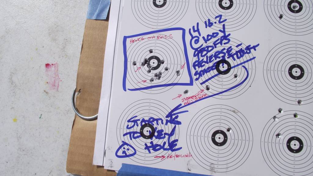

Well the rains stopped and wind laid down this morning. Paper target stand set out at 100 yards, few sighters to tweak the scope back to a rough zero and we're off to the races !!
Using the JSB BEAST 16.2 grain pellet at @ 980 fps, shooting off bags on a table, this is 14 consecutive shots taken @ 5-8 seconds apart.
While NOT MOA accurate and sadly not as accurate as my other 19" LW conventional / choked barrel ( which does > 1 MOA ) it is not bad and seen a lot worse at this distance.
So it does work to a point but as noted on targets there are tell tail signs these pellets were DESTABILIZING showing signs of KEY HOLING with a few holes having lead smears in a slightly oblong created hole.
Next test was SLOWING THINGS DOWN while also trying some lighter pellets ( Ran the 16.2's down to @ 800 fps, 13.4's in @ 930's and 10.3's in @1040 ish ...... Things actually deteriorated and groups opened up dramatically
Not worth showing honestly.
SO WE'RE DONE ...... Have no parts and pieces I'm willing to chop up for variations of rifled to smooth ratios ..... This was fun, was bored and now off to do something else.
