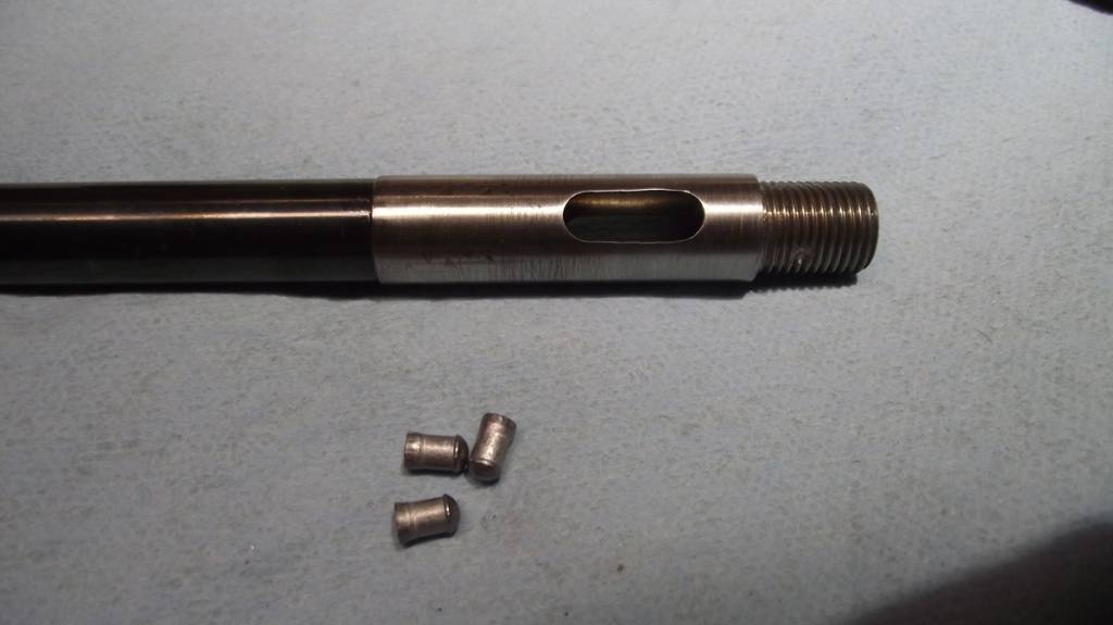

Painstakingly indexed the bore center line of the rifled stub to an @ .0015 TIR, then bored it out @ .700" deep to receive the Smooth bore barrel.
Same was done to get the Smooth barrel within the same TIR and turned the O.D. to fit the rifled stub with light interference fit.
Tad bit of feathered leade on the Smooth barrel and a good crown job on the exit of the rifled short, Some loc-tite 680 sleeve retainer and they get pressed together to made 1 barrel of @ 24 3/4"

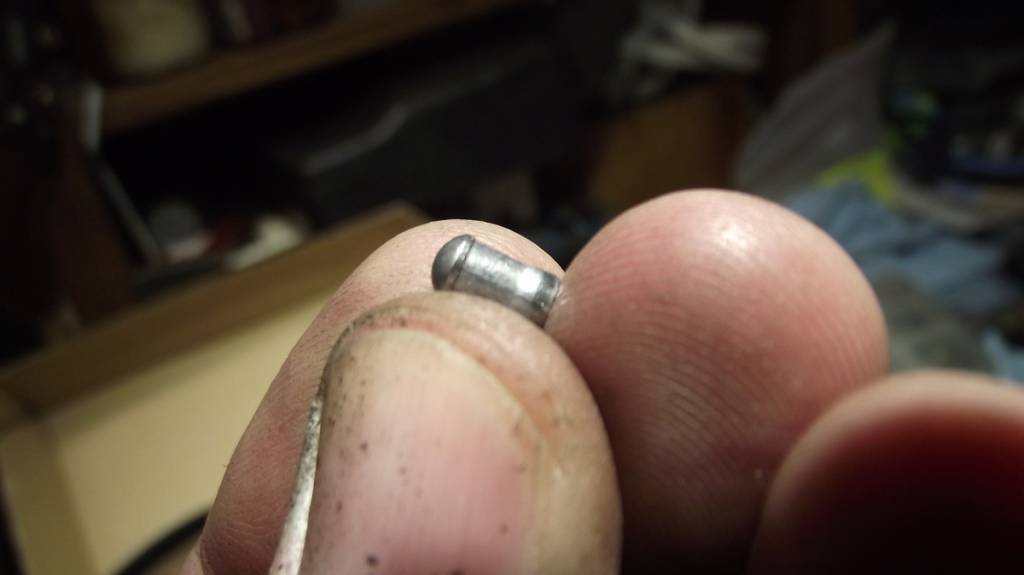

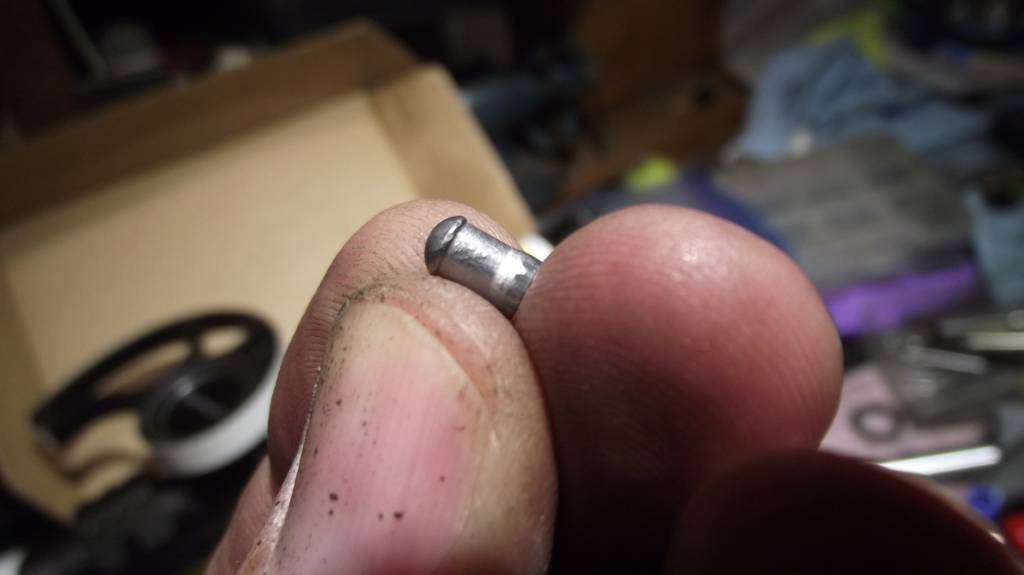

( Pics 1 & 2 )
What a JSB 16.2 grain Beast Exact looks like Exited from Rifled then Exit from Smooth ( Pics 3 & 4 )
As you can note the rifling is impressed well and upon exiting the smooth is nearly gone having been smoothed back out ..... Pretty cool

* Got the air stripper made and installed so it can get a shroud and be tensioned.
