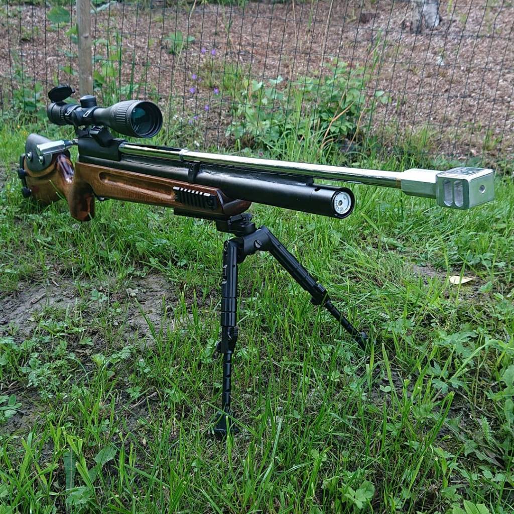

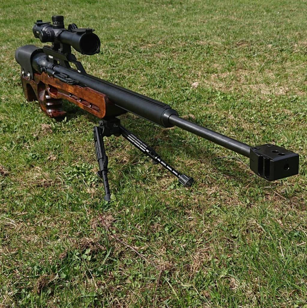

They work on air rifles, too. As already stated, you can tune an air rifle velocity to minimize your vertical spread, but tuning weights can be used in conjunction to change the frequency of vibration to something more favorable than the naked barrel. This Beggs type tuning weight is on a thread so it can be moved fore and aft. This barrel is .900” diameter.
Mike
