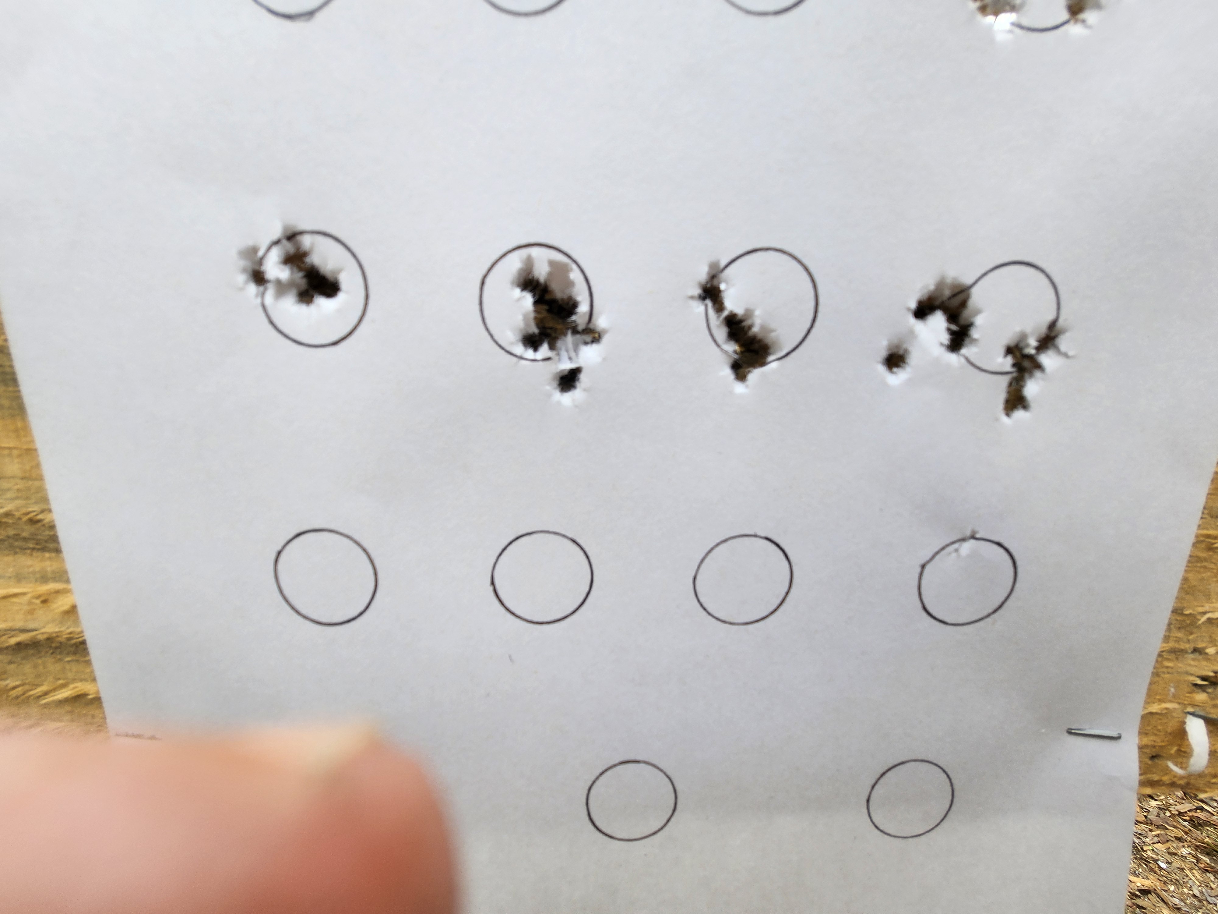

My Daystate Pulsar is down so was curious to see if the barrel would fit my Redwolf and of course it did. The Pulsar barrel is a lot better barrel than the one I have my Redwolf!!!! Unfortunately when I called AOA about barrels for the Redwolf they are not sure when or if they will get any. But anyway I am liking the results from the barrel swap....it's liking a lot more pellet choices a lot!!!! Shooting the FX 18.1, 34, JTS 34, 21,22 very well at 50 yards...the numbers are even better on mid power

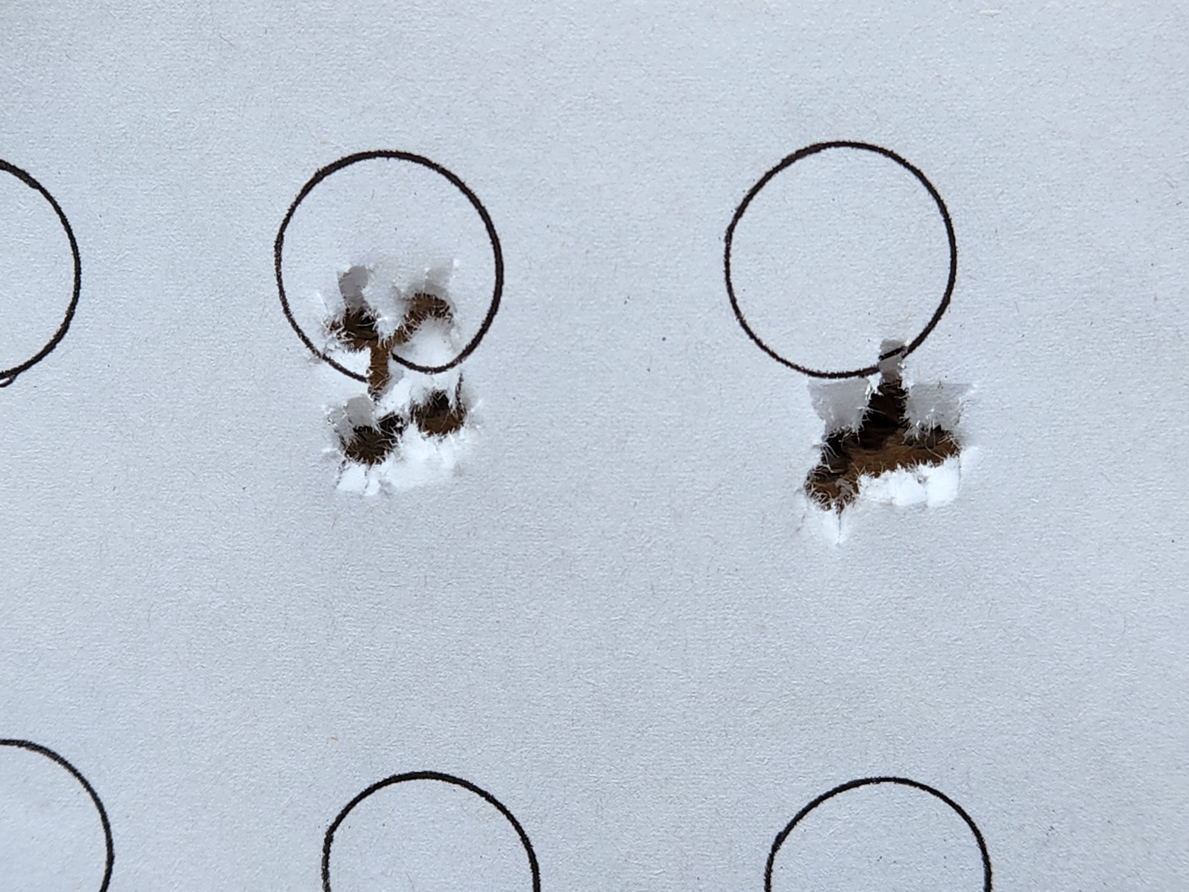

FX pellets 34gr at 50 yards 10 shot groups.

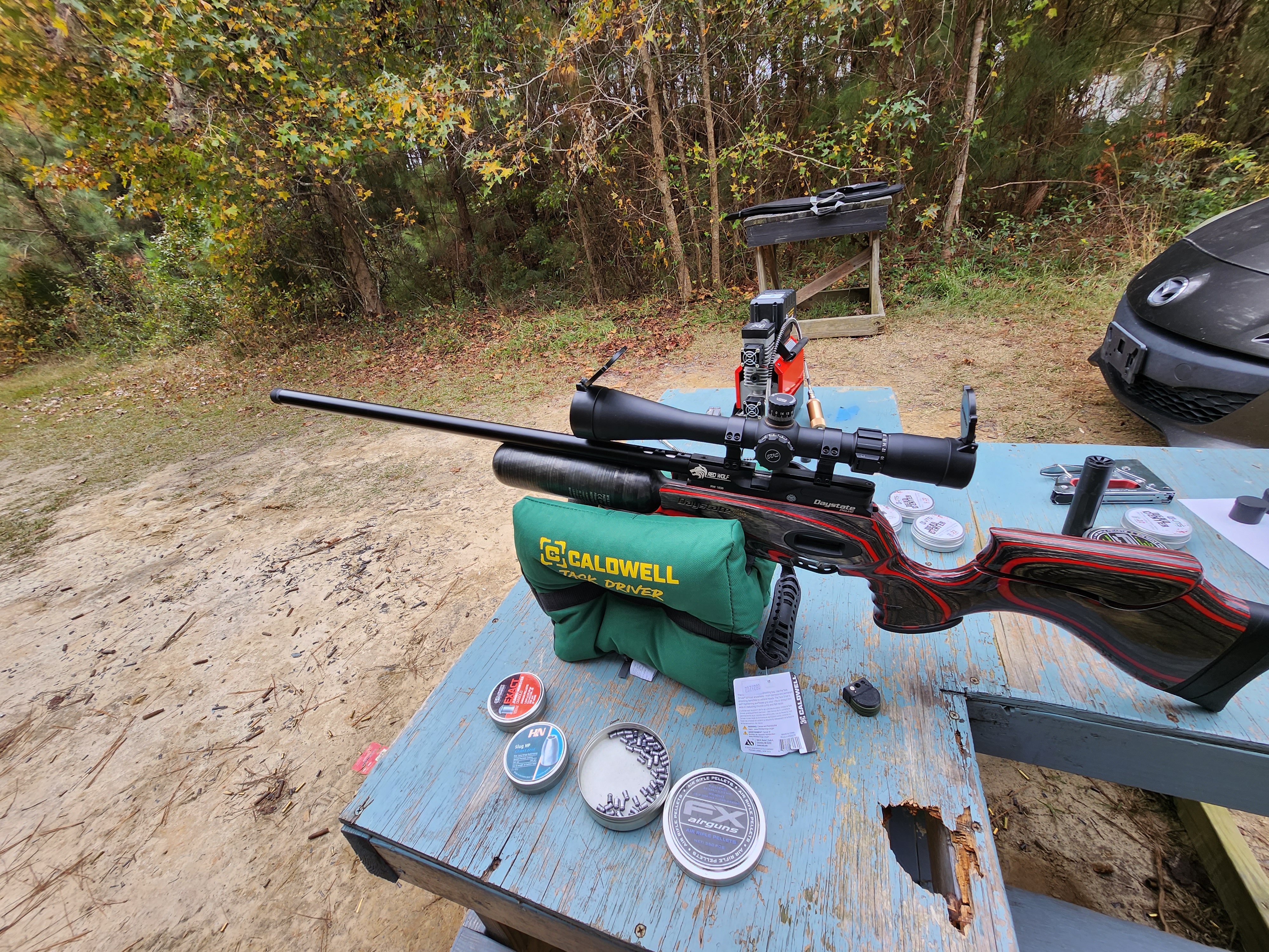

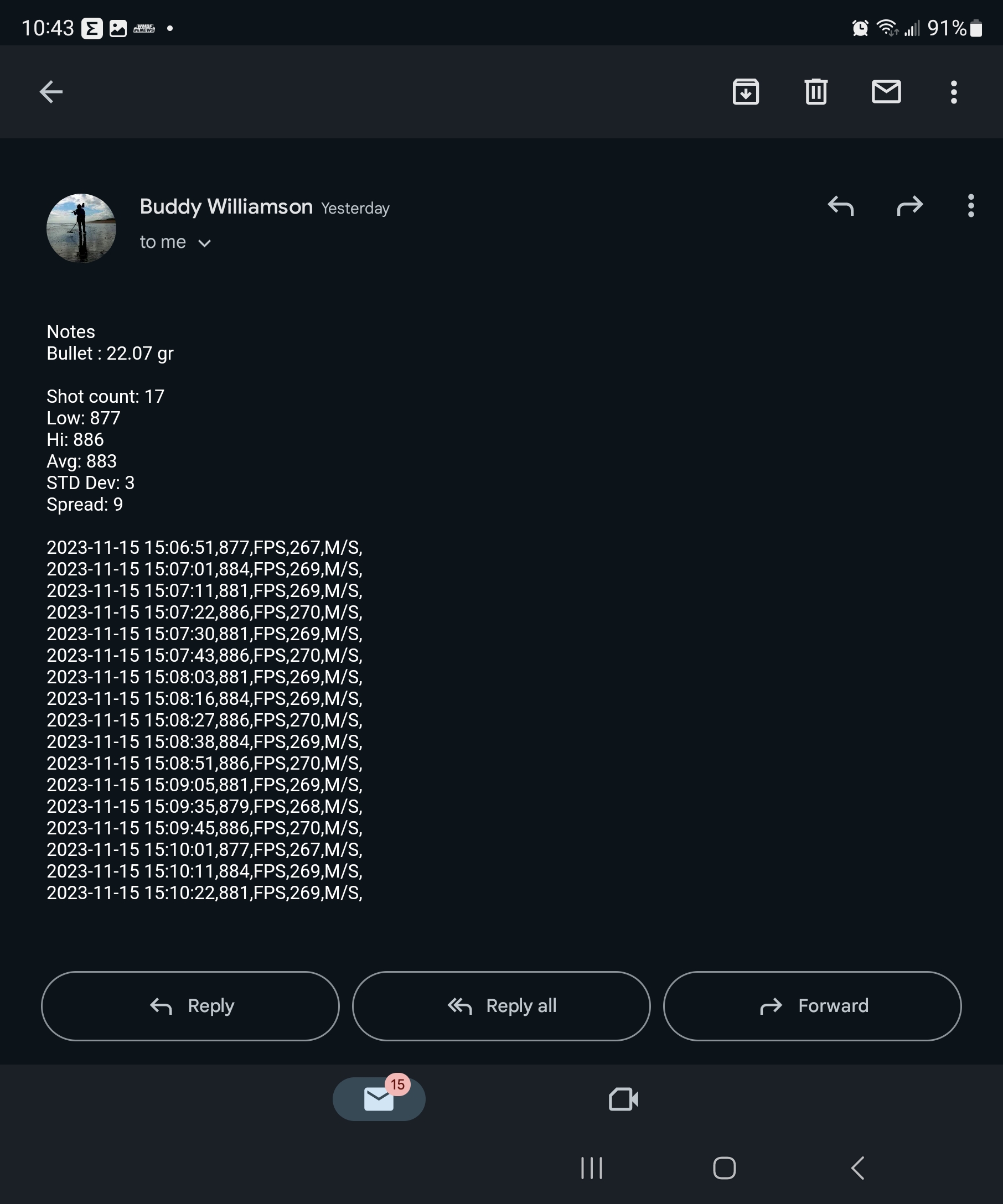

These are all mid power results......on low power shooting 18.1 at 858-865 fps.
FX 18.1 low power.....50 yards 10 shot groups
