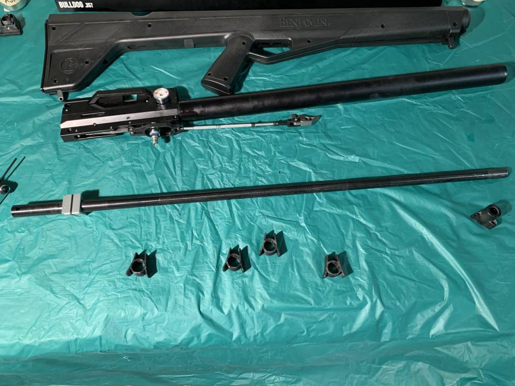

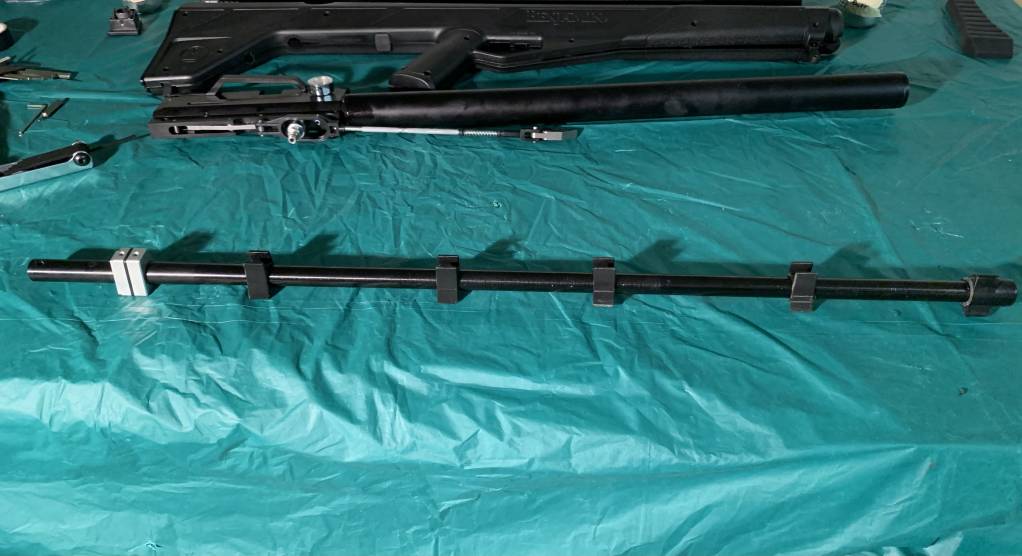

@HPAman I purchased a 3D printed plastic set from Pitbull Airguns for my Bulldog. I think you saw the thread where I tried to figure out how install them and finally got it with help from AGN members. However, I haven’t gotten a chance to test them yet. Have an alternate machined set on the way from elsewhere. I plan to test the sets against one another. The machined set is said to have been designed specifically for reducing harmonics or something or other that improves barrel stability in the Bulldog. The smith used unfamiliar terminology while explaining. He did explain in a way that made sense, I just don’t recall the exact details. I’ll have more input once I get a feel for them. What are you using or thinking of using? Have you encountered barrel stability issues with one of your airguns?

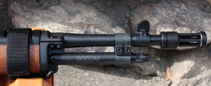

A sorbothane X-Ring Deresonator on my FN FAL reduced group size by about 30%. It damps out harmonics in the steel barrel which travel up and down the barrel at about 20,000 feet per second. It works by mass dampening since it does not bear against anything but is just a cylindrical piece of sorbothane that fits around the barrel. I had my doubts at first, but it actually did some good.
