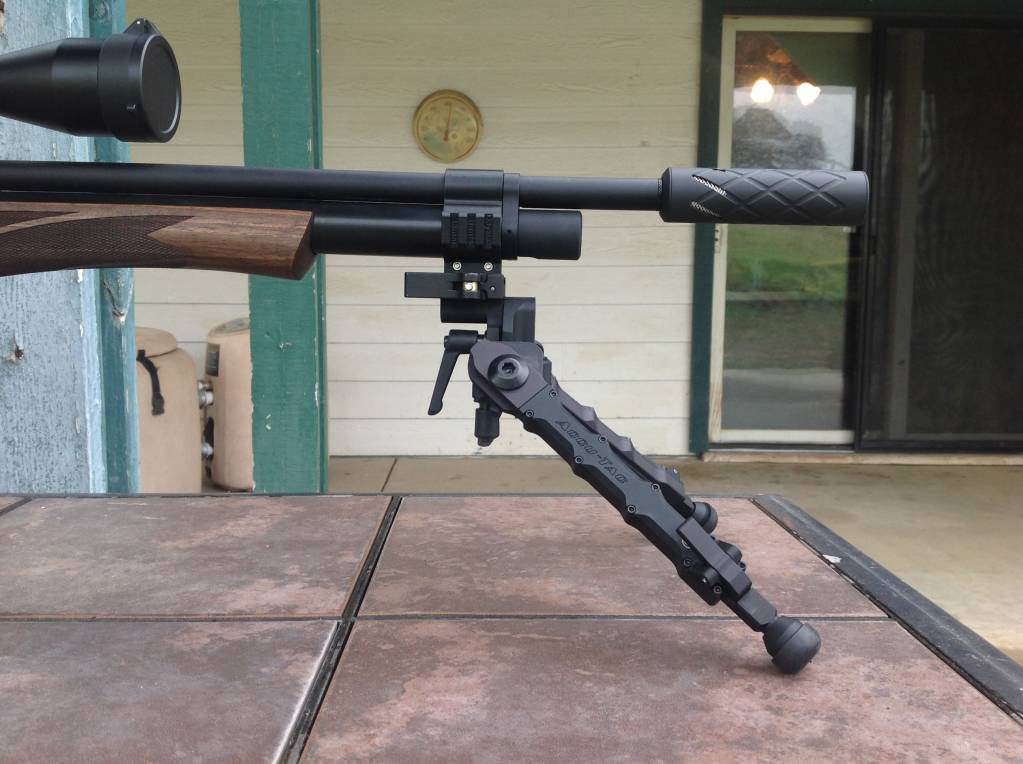

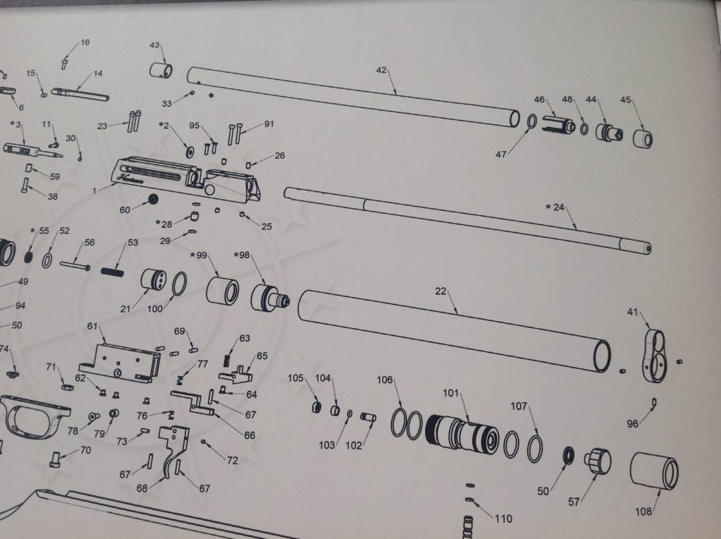

When looking at my Daystate Huntsman Revere barrel shroud #42 I notice that it's just floating in the barrel band part #41 and has some movement, if the end of the barrel #24 is attached to the shroud thats able to move does that mean it can move the barrel.
The reason I'm asking is if my bipod mount is wrapping around the shroud and if the mount was to move the shroud will that move the barrel and affect accuracy, or is the barrel very ridged and can't move, and is the shroud just floating.
Barrel band just has a little bit of clearance so the shroud and barrel cannot move too far to Change POI. That way you can lean the gun up against a tree or some thing and it won’t move the barrel too far to able to do that. It doesn’t hurt if the shrouded barrel moves just a tiny bit because it will go back in it’s rested position once the pressure is off of it.If that bipod clamp is mounted tight to the air tube, I think you will be OK.That being said, you don’t want that clamp to be able to move. It would Be better for the bipod clamp to not even touch the shroud and only the air tube though (just like the factory barrel band is )in my opinion.On mine the barrel band just barely touches the Shroud it’s self. I could loosen the barrel band and just move it slightly so it would not touch at all but I don’t have any problems with accuracy issues. So I just leave it alone. Some people like Barrel bands and some don’t. Mine doesn’t clang around either when I bump it. Some guns if you bump the barrel it will change POI.And that’s why I prefer them on some of my guns.
I removed the band from my Revere, got tired of hearing it rattle with each little bump or movement. I don't know why they put a band on it, it's not supporting anything. And yes, the barrel will move with the shroud, because of the air stripper attached at the muzzle. I prefer not to clamp anything to either the cylinder or the shroud, it's another variable that will affect harmonics. Since the Revere is not a benchrest rifle, I just use a Harris bipod and sling swivel stud.

If the assembly of your rifle is like mine, the barrel shroud floats within the barrel ring, which is why you hear the rattle. It's also clear evidence that the ring is doing nothing. I suppose that is better than having it in contact with the shroud, as that would be placing uneven pressure on the shroud, since it could only contact it on one side. And no, placing an o ring or anything in there would only create another point of possible harmonic interference. As with many rifles, IMO, the barrel needs to float, as mine does, with or without the barrel ring. So I removed it, and the rattle, and it is one of my best shooting rifles. I suppose Daystate might say that the ring is there to protect from a substantial impact. But, it is at no greater risk than my other rifles without such a contraption. Also, should the rifle sustain a large bump at that point, there is the chance of the ring shifting on the air cylinder, in which case it would prevent the barrel/shroud from returning to its centered position. I brought this up to a tech at a major Daystate distributor, and he agreed, said just remove it. So, I believe the answer to "why", is tradition. Apparently, some of the folks at Daystate believe the ring adds to the aesthetics of a traditional sporter-style rifle. On my HW100, there is a similar ring, but it is firmly attached to the stock, and offers support to the air cylinder, and there is sufficient clearance around the barrel to prevent interference, or rattle. Maybe an example of English vs. German engineering, form vs. function?
