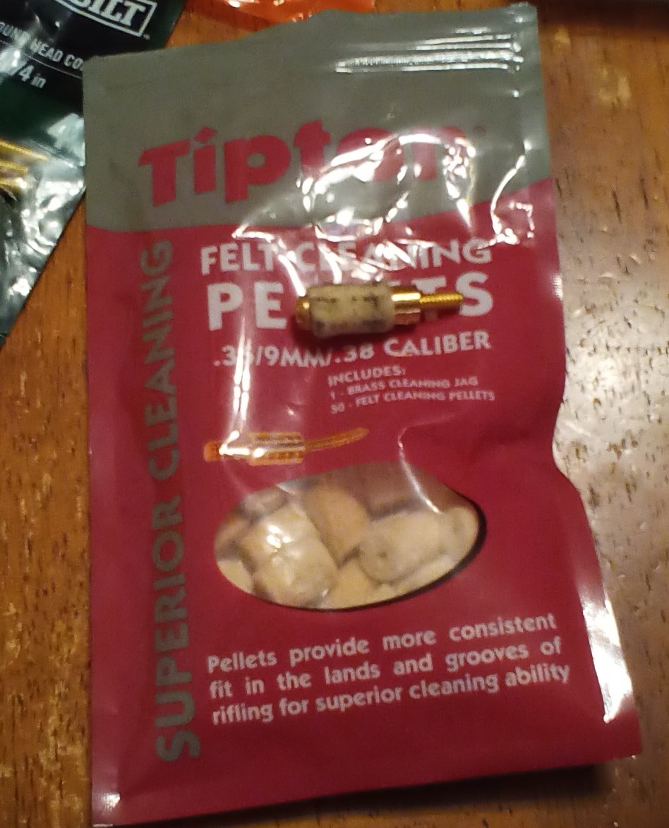

This is a horrible picture, but here is the tool I made for polishing barrels. I was not happy with the stock jag that came with these felt pellets, so I bought an #8-32 brass screw and some brass nuts. Tightened the nuts and put the assembly in a drill. Used a file to cut everything to a smaller diameter because the #8 screw head and nuts were too close to the 357 bore I was working on.
Substitute a 5-40 long screw and nuts for smaller calibers.
