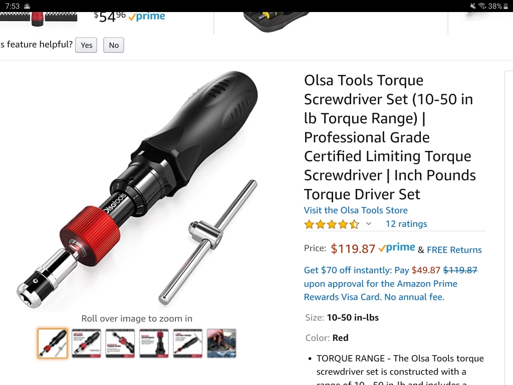

Well, I finally got the tube of Vibratite VC-3 and used it on the barrel pivot bolt. Problem solved !! Instructions say to apply and allow to dry 10-30 minutes. This stuff dries very fast. I went ahead and used it on my forearm and trigger guard machine screw as well. I figured I needed a Torque screwdriver so I purchased this one. Torqued the forearm screws to 25 in/lbs. Trigger guard screw to 26 in/lbs. I got mine delivered for $94. I like it alot.
