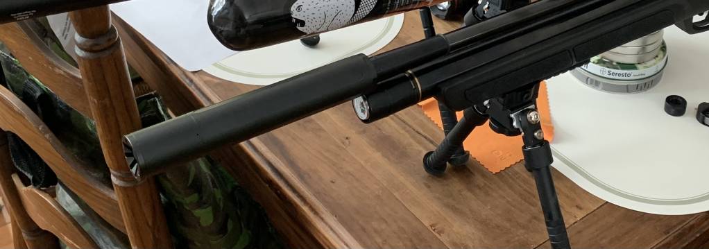

Agree with dizzums. I took the pickle off my Gamo Urban and put a bsa slip on adapter with a dfl koi. Works great and have never had any clipping issues.
