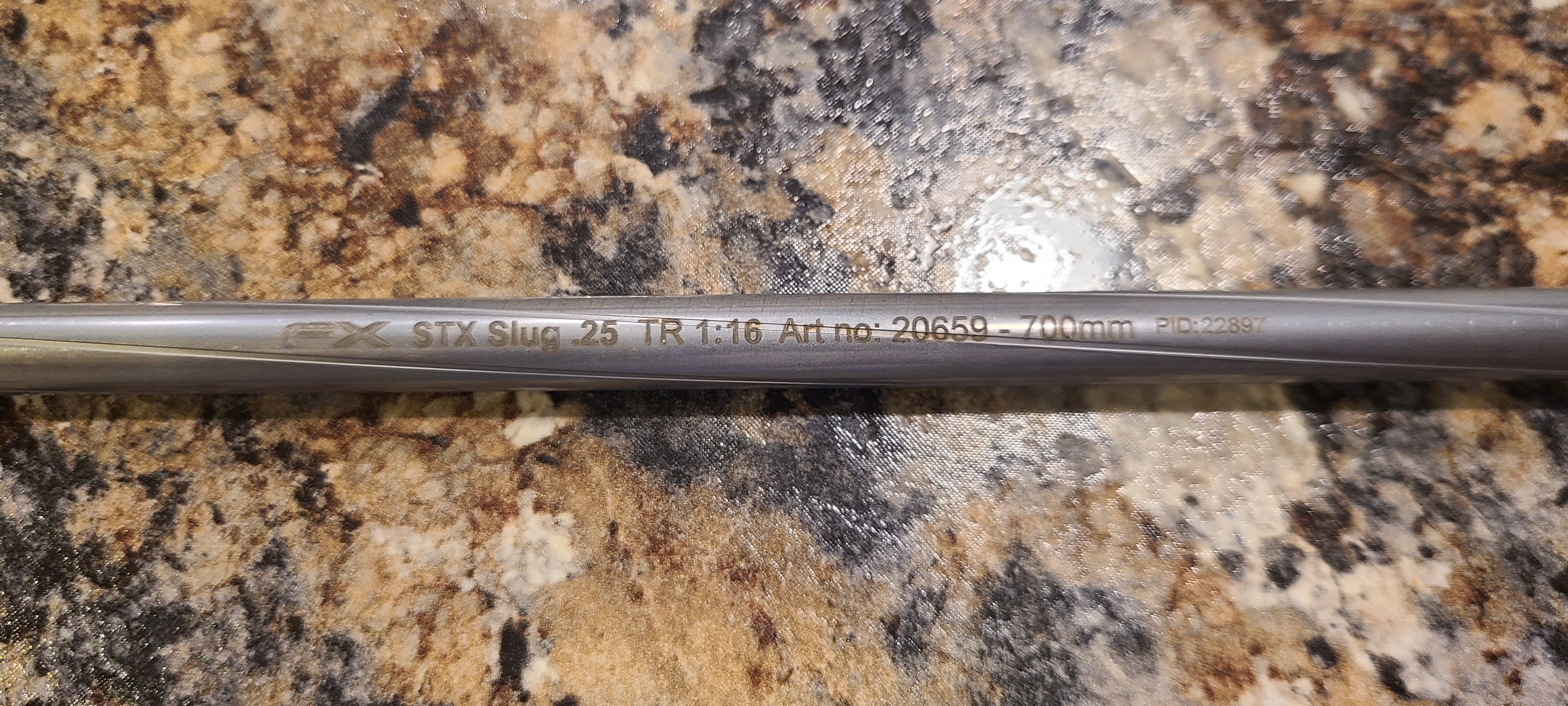

This liner is a tack driver with the 40gr H&N Heavy slugs and with the 40gr Javelin at 970fps.
