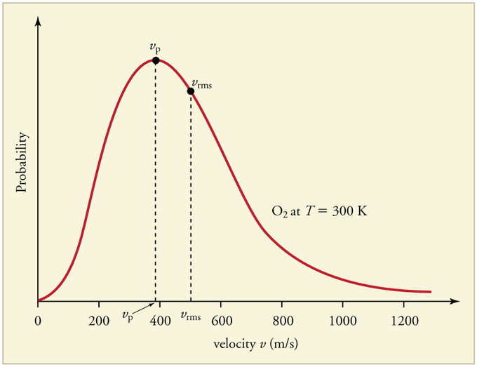

This graph is nice asf and good to know about. But do you have any idea or info what can be the "chamber" what is actually transferport air temperature?To complicate this, the higher you get on the Maxwell-Boltzman distribrution bell curve with projectile velocity, the harder it will be to obtain that potential energy without increasing pellet mass. This is because molecules have a WELL known, theorized, confirmed and proven distribution of probable velocity.
Well under Vp is going to be that approximate velocity for dry air (1250 fps) where you'll struggle to obtain your potential energy increase without increasing projectile mass. V max is 1200+ mps, but to obtain such speeds, you'd need an incredible system shooting incredibly light projectiles that take advantage of the small % of incredibly fast moving molecules in air...
Just for example i have pushed with my .22 impact 800mm barrel pellets at 370+ m/s and looking to this graph for me its hard to believe that impact is so efficient that its able even on the bottom of the graph reach such a speed.![]()

Temperature right behind the pellet before the adiabatic dump into the barrel can reach upwards of 580-600F given the right conditions. I've dieseled pellets and gotten smoke from the barrel in .177 fairly easily and frequently. (Transfer port can reach up to 1.4x that of reservoir discharge in Kelvin, and barrel can reach upwards of 1.4x that of transfer port in K.)
370 m/s is well under the average air molecule speed so with the right pellet weight nearly any pcp with enough barrel and pressure can reach those velocities, to go higher you simply need to go lighter on projectile, there is less and less air molecules traveling at higher and higher speeds the higher you go, and those molecules energy are first to decay and get soaked up by your projectile, hence why lighter projectiles can move the fastest, certainly up at the extreme speed, the need to go lighter becomes exponentially greater the faster you intend to go, till you reach the absolute limit...it boils down to simple probability
