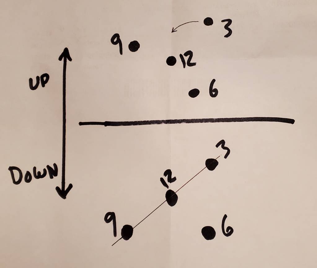

I am about to index the barrel on an M3. I have a question about the indexing process.
12 is the point of aim at 12 oclock barrel position.
The goal is to get one of the other points to be above or below 12 oclock. I will be turning the barrel to 3 oclock, 6 and 9.
My question: will there automaticly be 2 points that are stright accross from each other like in the bottom illustration and then I bring one of these 2 points to be straight up and down?...so 3 or 9. ? or will it be like the top illustration, nothing straight across, and I just pick any of the 3 dots to bring into and up/down position? ...in this case #3. / or am I missing something about the 12 position?... if so please draw or explain. Thank you!

Your 12 o'clock would be where u start where you're all ready sighted in to which was his first dot he put on the paper then index to 3 it can be anywhere on the paper then 6 which can also land anywhere on the paper and so on once you get to the 12 o'clock position again it should be back to where you started or where your sighted in to then looking at the paper I would pick the highest point where the shot landed when indexing if it is off to one side or the other then you would have to index in-between. Say your highest is at 3 o'clock but it's off to the side of your original 12 o'clock point that your sighted into depending on which way it is off you would reindex between 3 o'clock and 12 o'clock or 3 o'clock a ND 6 o'clock so the highest point would be in line or straight above you original point of impact or the 12 o'clock
In my case the POI straight above or straight below to the POA - would result not enough rail + rings adjustment (to the Left) but also moving out the scope optical center as well. The difference would be about 7-8 MILL/MOA.
For this same reason me personally I left the adjustable rings centered also the scope optically centered, and I moved the rail only as much the screws allowed (Impact have a loose rail).
And I call it a done deal. I am not calling this my step perfect, but at least my scope is not stressed.
Perfect! Thank you for explaining that. -Nate

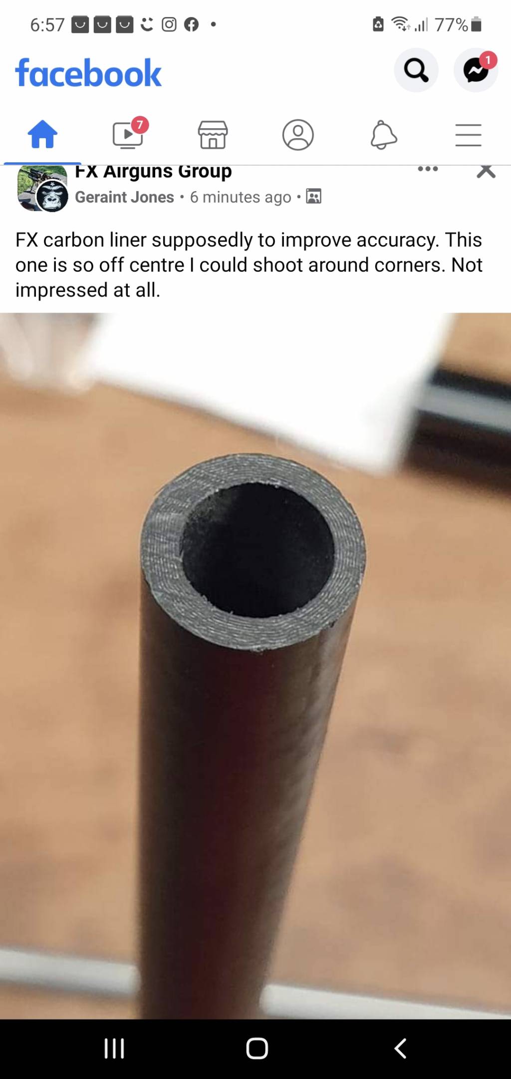

A good FX stx liner with good barrel shell should make a repeatable circle on paper with pellets when you rotate the liner gradually in 360 degree.
A solid barrel does it almost every time.
Sometimes stx barrel doesn't show this phenomenon and that is alarming for me as it means that there is various pressure forces at various points of O rings on the liner.
If a comple circle is achieved by shooting pellets while rotating the liner in 360 degrees then either 6 O clock or 12 O clock are best positions to keep the barrel well indexed.
If there is any issues in the liner, shell or O rings then the rotation of complete barrel at 180 degrees having two holes in TP, one (dual) for slugs and one single for pellets will not keep the POI along the same vertical line.

I have been competing in archery for over a decade and learned the CF tubes = arrow shafts. Also pro golfers and pro fisherman learned their tools.
The blank arrow shafts for competition starts about $450-500 a dozen, and you assemble those for next $ 150 test and tune and filter out the defected, and only then we can go scoring perfect X's. From a dozen finished arrows maybe 80% flying as you aim. Sometimes need tree dozen arrows to test and put one perfectly flying dozen arrows = lets talk about $1500-2000 a cost.
From these view please tell me what you are expecting from a CF tube for $10-20 a piece? Maybe you shall buy a dozen and try every each there would be a better chance.
