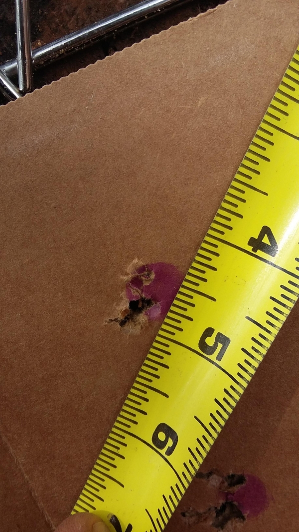

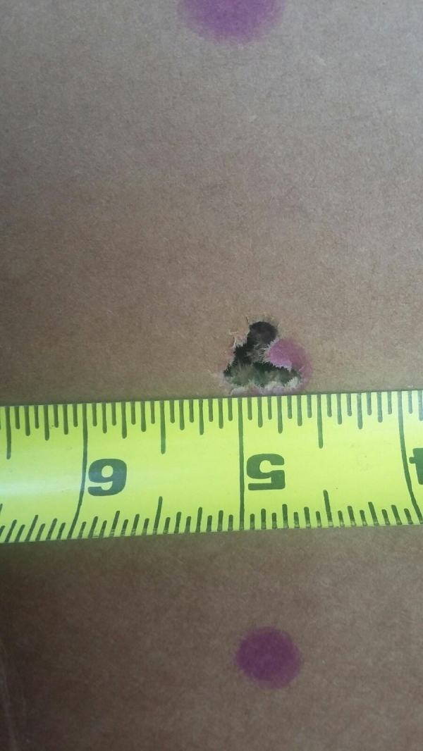

Here's what my .22 LW barrel does in my P15 at 50 yards. 5 shot groups.
I really dragged my feet about doing a LW barrel upgrade. My mind was blown when I realized how accurate it was and it completely transformed the gun. JSAR did the machine work and it was top notch! But as far as the grade, it was just a choked .47 diameter blank with standard rifling.
