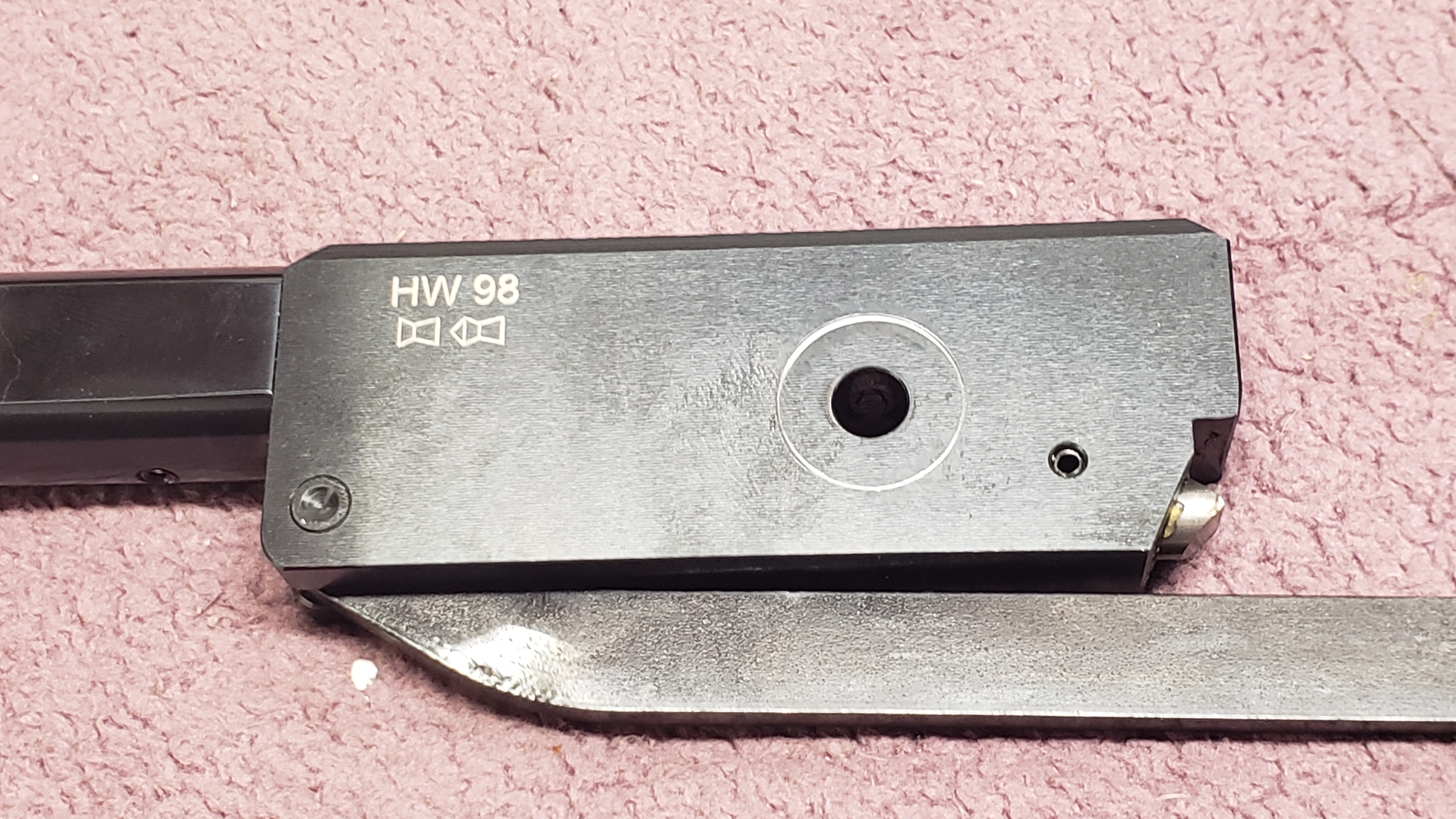

The HW98 is what has barrel droop in this case. How does one “adjust” the barrel upwards without damaging it or causing wandering POI problems down the road? Doesn’t the lockup mechanism have strict tolerances?
You're bending the barrel upwards and not changing anything with the breech block or lockup mechanism.
It wont cause any lockup issues and it won't move over time. It takes a bit of effort to get it to bend in the first place.
I would remove the barrel, put the breech block in a padded vise, and simply pull on the muzzle end. You'll feel it give a little and you're done.
Chances are your cocking linkage is binding on the breech block. The last new 98 I tuned had this. To fix it you have to put a slightly bend in cocking arm. This happens to lots of 95 family guns since 2019. I've probably fixed 6 or 7 for people.
Yeah, I haven't seen this problem (or bent barrels upwards w/o further investigation), but by removing the cocking arm from either the receiver/block and inspecting for barrel/block positioning changes ....... You should be able to see/measure lockup differences.
I would rather bend the cocking arm than the barrel;).

maybe a file to clear that inside corner ?

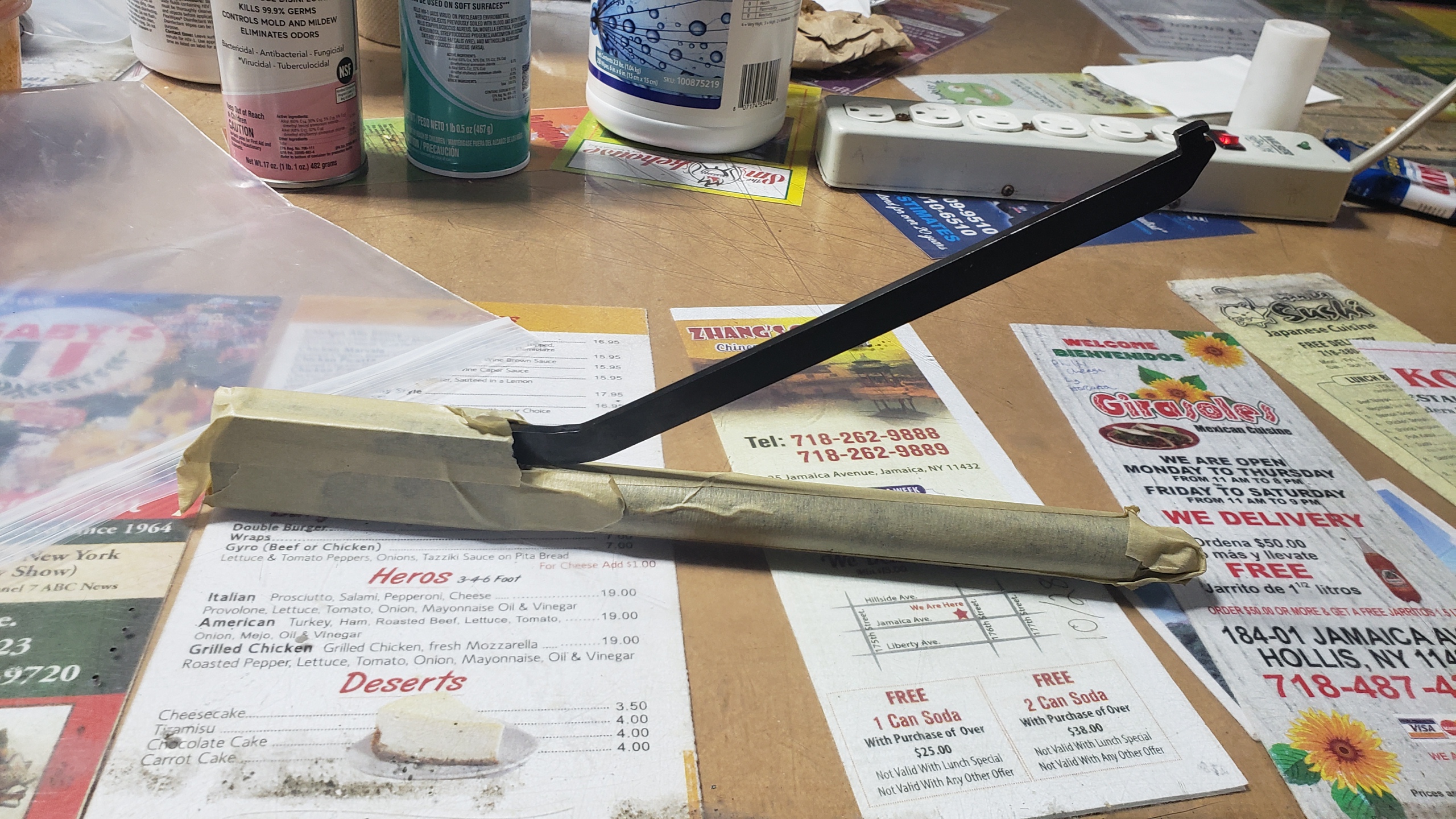

The cocking arm binds on many late model 95 family guns. If the cocking arm can't be wiggled with the gun closed, its binding. It'll create droop or vertical stringing. The solution is to bend the cocking arm up at the midsection so the shoe end is about 4mm higher. I wrote this all up on another forum under my Bayman login and the thread was called Holy barrel droop batman. It took a couple of pages before I figured it out. It's all there though.
I have no problem bending a barrel. I do it all the time. You need to make sure everything else is working as designed.
