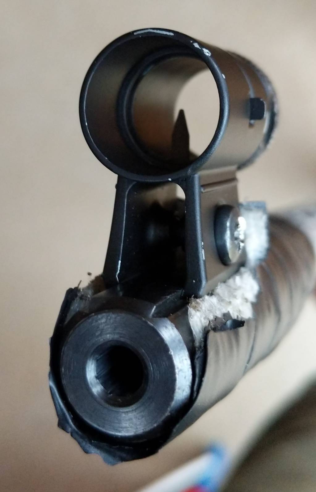

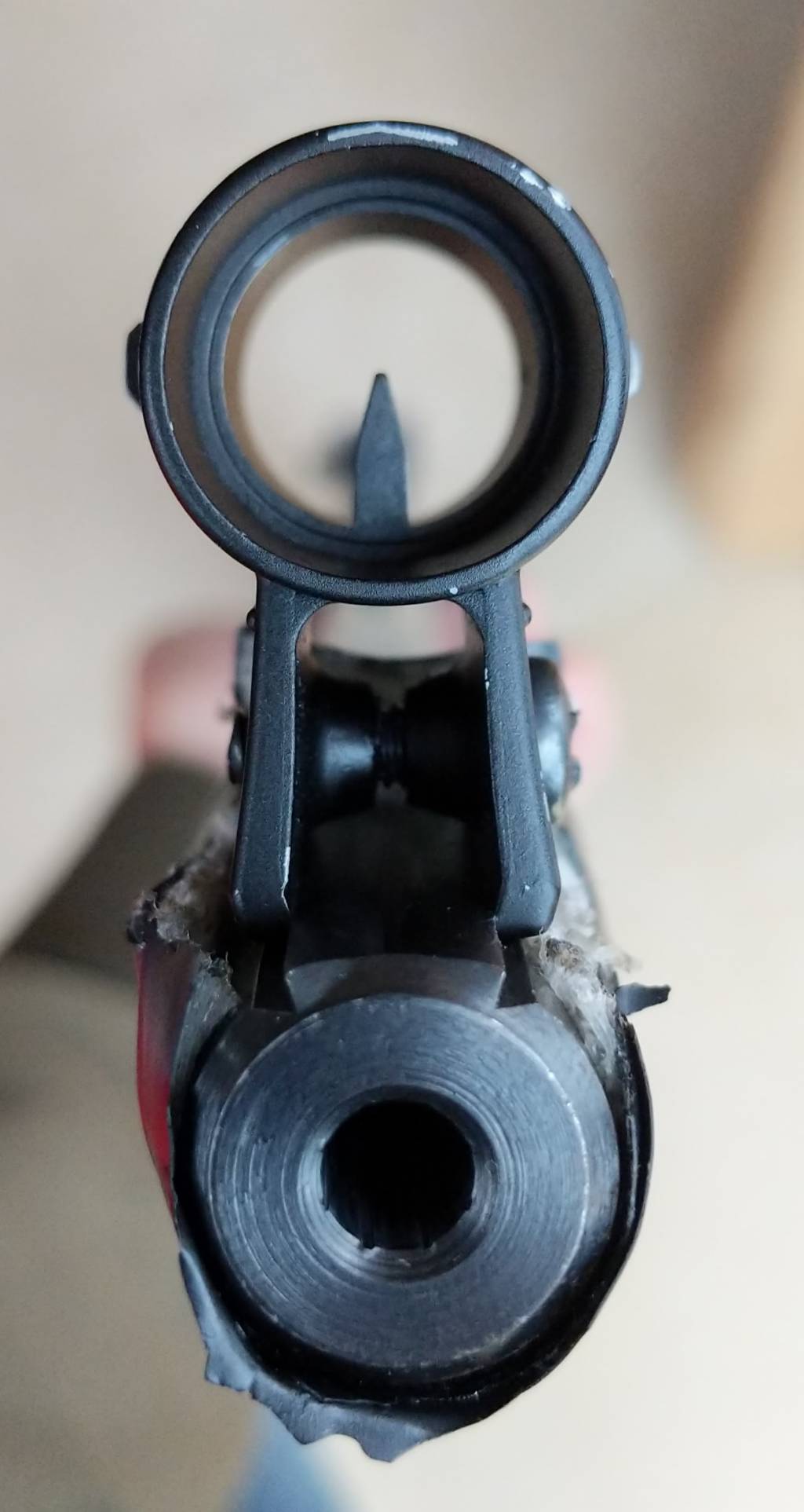

The front sight is the original Diana sight, it looks odd because of the ugly electric tape I added.

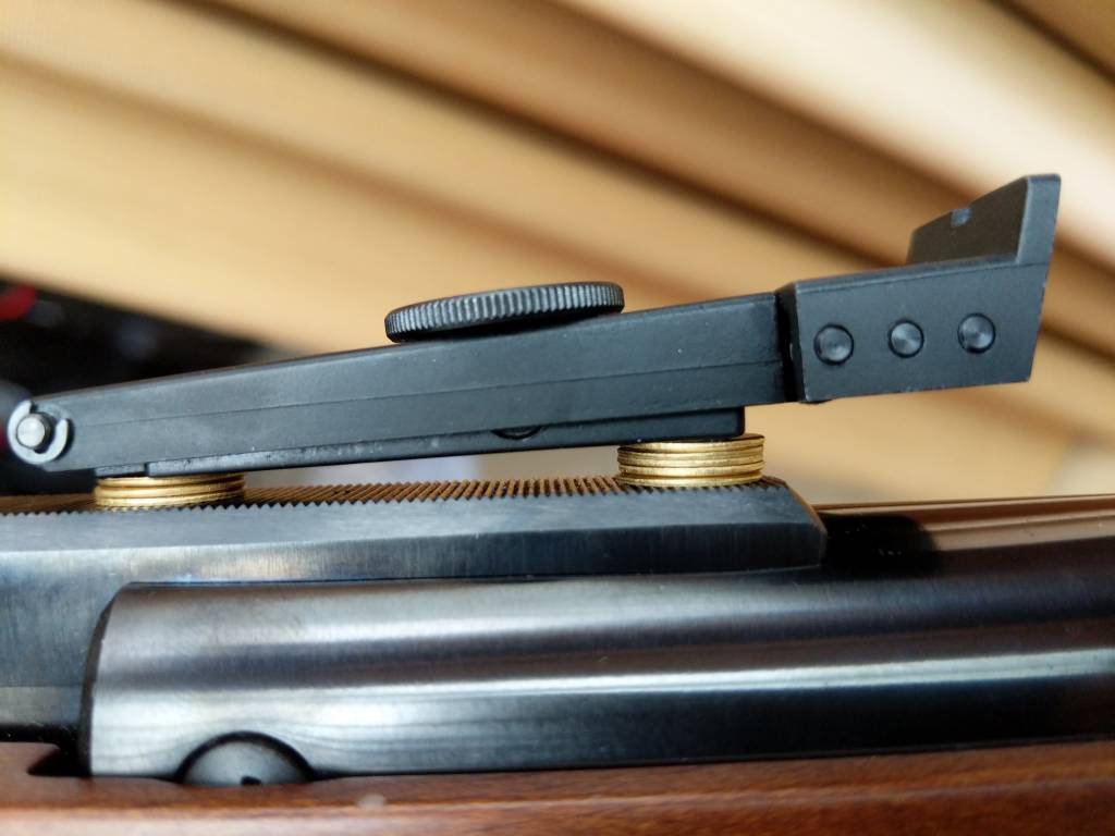

The idea of all those washers is to make the spring tight. If I put the washers at the back only the screws get strained to an angel so washer on both sides to level the whole thing.
Filing the tip of the front sight is a good idea, better than these washers. I'm concerned that it would need to be filed down a lot to compensate though, you can see how high the washers push it and it's also unscrewed about 15 clicks.
ETA: I did disassemble and reassemble the front sight to make sure everything is tight and properly placed, including the insert.
View attachment 111665View attachment 111676View attachment 111685View attachment 111690
you could paint the washers flat black ? if you nut and bolt the washers in a stack then put in a drill and sand the round edges flat it would not look so much like a stack of washers ?
The front sight is too high!
