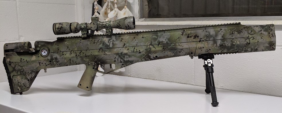

That TERRIBLE accuracy. My Pitbull Mega (plus JSAR SS valve) with NSA 142 BTHP will do right around 1/2" all day long at 50 yards. https://nielsenspecialtyammo.com/collections/357-cal A lot of Bulldog owners also get good performance with the 110gr NSA too.

1555393041_10585910585cb56a111a2411.91257150_Pitbull Dressed 001_1024x1365.jpg
