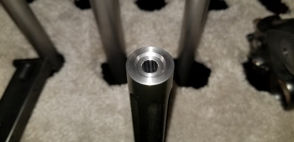

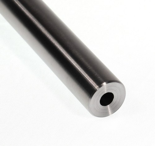

A hunting crown is where the crown is recessed significantly from the end of the barrel to provide a bit of protection to the the lands and grooves from the inevitable bumps and bruises a hunting rifle will endure.
A target crown is not recessed, with the end of the barrel being cut at a flat 90 degrees from the bore, or recessed slightly, affording little protection to the lands and grooves.
Attached are a couple of pics that should help you see what I'm talking about. One is a hunting crown I cut on one of my rifles (black barrel), the other (stainless barrel) is flat, target crown.
