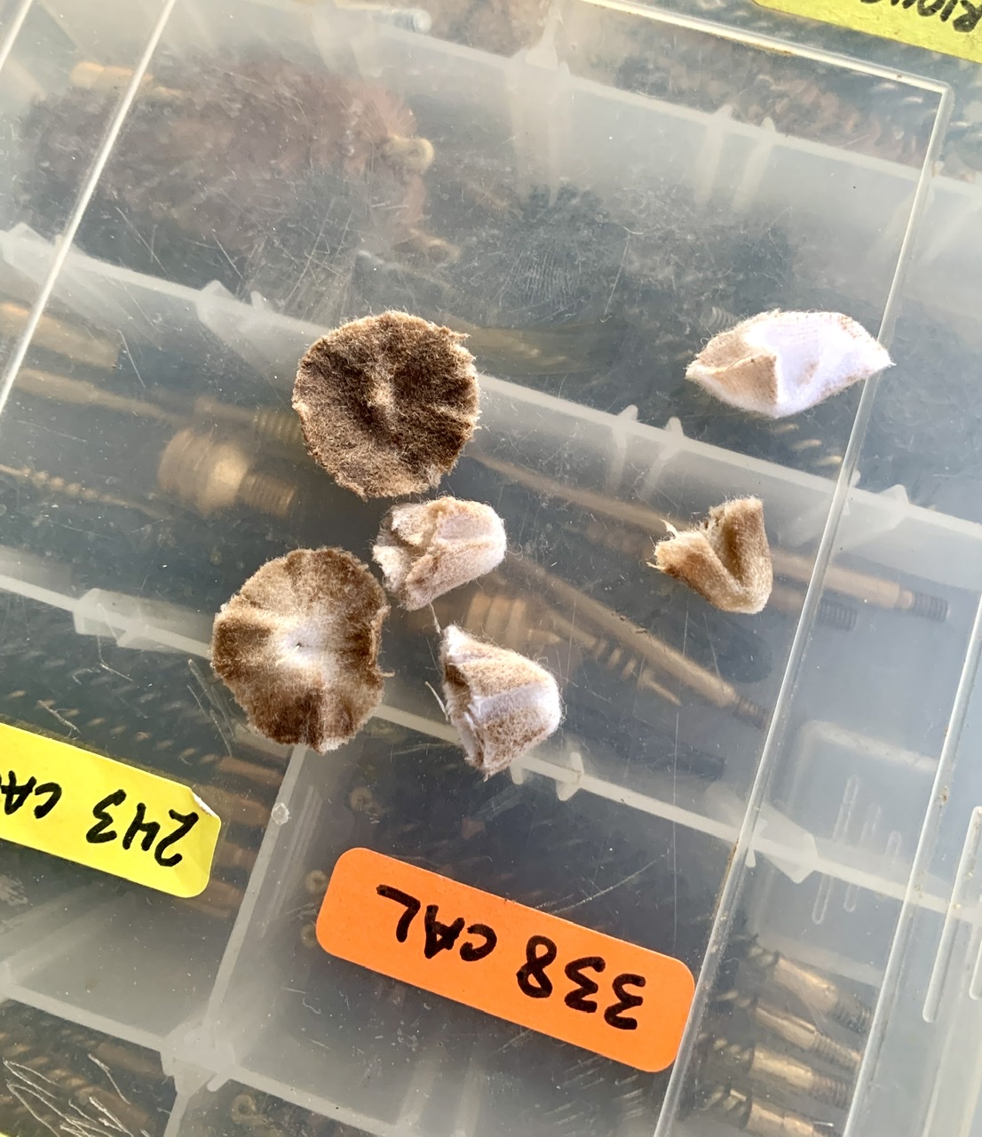

I just got my first pcp rifle and did not clean it before shooting out of the box because I had Pyramid Air do the 10 shots for $10 before shipping it. I think they clean it first? Maybe not... Anyhow, I only shot a couple cleaning pellets down the barrel here and ther during the first 150 rounds or so.
I finally noticed accuracy started faltering a little bit and i witnessed one pellet kick sideways pretty hard in mid flight. Definitely was not stable. So I decided to a full cleaning for the first time.
Initial patches came out black and cleared up, but kept getting a full brown. Then I started scrubbing with a brush and patches were coming out a really dark brown. Tons of grit and grime. Looks like rust residue. Although I live in a dry climate, I know air still has moisture in it so figure that may be what I’m seeing.
Is this normal when cleaning a brand new pcp for the first time?
I do have a borescope and might check it out tomorrow but just wanted to know if this brown residue is normal. Thanks for any input.
Pyramid did not clean your gun. That’s cosmoline. A rust preventative for shipping from far away places. I always clean a gun the day it arrives. Can’t establish baselines with a tainted gun. How often to clean? That depends on the barrel and projectile. Cleaning intervals when you have a ton of guns is a curse unless you’re a record keeping fanatic. I have a TJ slug barrel that’s been polished and it’s still essentially no better than a muzzleloader. That thing gets filthy and accuracy goes south faster than my other TJ that only shoots pellets by a large margin. FX liners are another confusing bunch. Some say 2-300 shots and the very next guy will say he never cleaned his in 5,000 shots. So in the end, just like most everything PCP, your gun is your gun. Learn it.
Thank you. That cosmoline is pretty nasty stuff to get out of a barrel. Did some digging for info on it and seems that the best cleaner for the job might be “Goo Gone” adhesive removal spray. I’ll keep at it til I get it all out. At least its not rust like I initially thought!!! Lol
I’ve only built custom centerfire rifles for the last 18 years so it’s been a long time since I’ve used a factory barrel. The brown patches kinda threw me for a loop. Thanks again.
