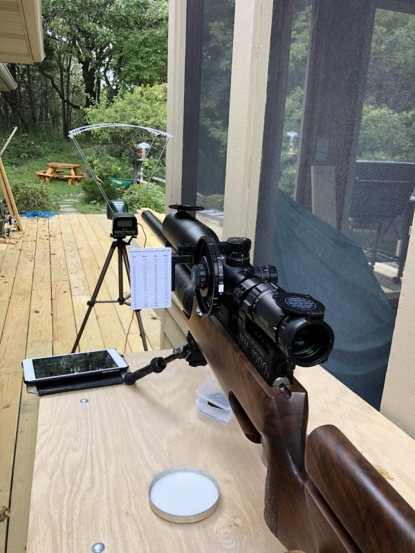

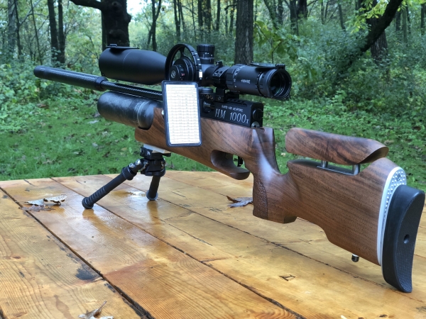

Equipment:

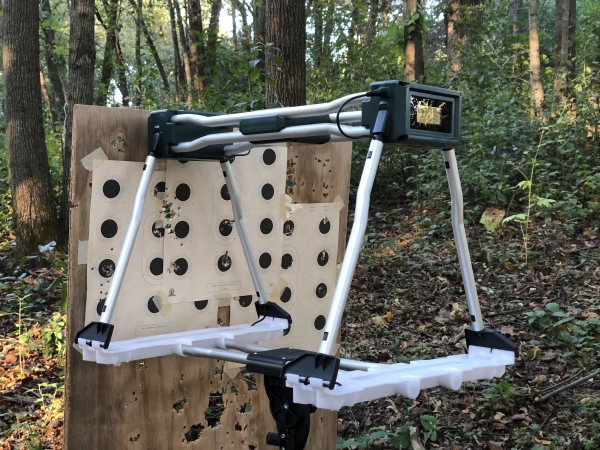

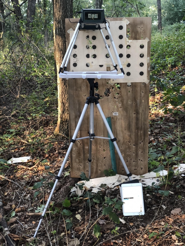

RAW HM1000x in .25 cal with factory polygonal barrel (made by LW). Hammer spring basically set to its lowest position (shooting ~ 60 fpe), and left completely alone for this comparison. Testing done with this gun's favorite food: JSB Heavy, Mk I pellets (33.95 grain), all testing done with pellets single shot loaded into the gun.
Method: Same as Usual...
Measure the velocity of two common pellets at 1 yard and 50 yards, averaged over a string of 12 shots, compile the results and calculate the BC of each combination. I use Chairgun Pro (desktop version) for the calculation of BC and use the GA form factor for diabolo pellets. I capture the data using two Caldwell chronographs (that have been calibrated to each other) and then compile the results in Excel. I record the local weather conditions using my Accuweather app-but only as a double check of the weather conditions the Caldwell app pulls in from its source (not sure where-but they match pretty closely). I do use the average humidity over the shooting session and look for any changes in pressure or temperature during the session-and then use the averge value of those numbers (from the Caldwell numbers).
At yard: (Distance is set from the end of the moderator to the center of the rearmost sensor window)
At 50 yards: (distance is set via Nikon laser rangefinder to target)

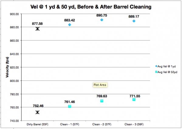

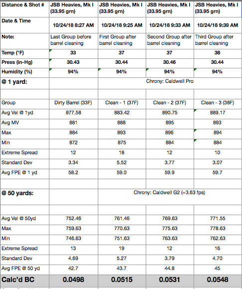

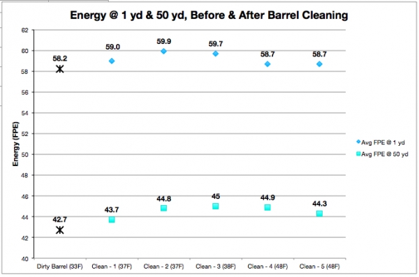

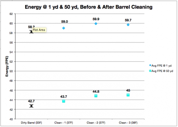

Plots of the data:

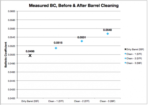

Conclusion(s):
As it turns out, I was indeed NOT imagining things when I noticed what I had suspected to be my barrel leading up-the data clearly shows the results and, interestingly, the process of re-leading the barrel after a good cleaning. The column furthest to the left shows the 'dirty' barrel's 12-shot group performance, and the 3 columns to the right show three 12-shot groups, after cleaning the barrel (after waiting for the gun to come back down to ambient temperature again). Based on what I see above, and at the target, I would say the barrel isn't fully settled back down again after the 36 shots as the BC was still climbing back to it's more typical 0.056 reading-having said that, it's nearly there with the 36 shots taken. Had I known that there was still more data to be taken to show it settling out fully, I would have shot another 2-3 12-shot groups to show it settle out.

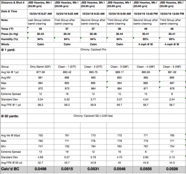

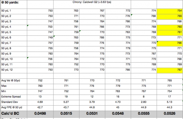

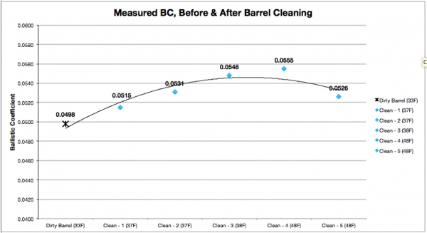

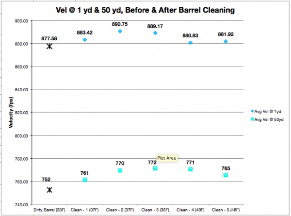

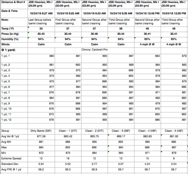

So after posting the data, I did run out and shoot two more shot strings-despite the temp having warmed up further from this morning's testing-just to see if the BC's had stabilized. Bottom line: It looks like somewhere around the 4th dozen shots (call it 50) is where the barrel seems to have settled in, since the BC on the 4th string came right back to where they it normally is for this combination: 0.0555. This afternoon was a little trickier because the wind is blowing lightly (cross wind) by the time I was shooting the 5th group, causing a bit more standard deviation at the 50 yard chrony, and dropping the BC down slightly to 0.0526. In any case, it's pretty clear that the BC's have stabilized by about the 4th dozen-or, call it 50th, shot.
Note: there's a lot going on with that last group and the BC lowering back down below what I would expect. I have seen it before and it usually happens in conditions where the wind pushes the pellet laterally as they near the 50 yard chrony (think of it as a slightly 'angled' path between sensors-and therefore being slightly 'longer', resulting in the shot showing a lower velocity). I had a few of the shots show low velocities at the 50 yard chrony-and that dropped the average 50 yard velocity down enough to drop the BC in the calculation. I'll post the actual shot strings so you can see the data directly to see what I'm referring to (I've color coded the cells that I'm referring to). Anyway, I'm stating that only to say that I'm confident that the BC is stabilized back where I've seen it routinely in the past: ~ 0.0555 for this combination.
Here's the updated data with the 4th and 5th 12-shot groups added. I've also added the RAW data down below for each shot, and highlighted the cells where the 50 yard vel dropped below the min velocity of the entire 12-shot group that was shot just moments earlier. Note: date and time stamps are shown for each shot string also to show when they were shot relative to one another.
1540407748_19467905885bd0c1c45af8c9.16553229_Shooting Data Expanded - Cleaning.jpg
1540407760_14875044085bd0c1d0812233.63220987_1 yard Shooting Data Expanded - Cleaning.jpg
1540407770_8752364725bd0c1da9ec8e3.22868257_50 yard Shooting Data Expanded - Cleaning.jpg
1540407795_17158689495bd0c1f3c450d2.68699110_Vel Chart expanded- Cleaning.jpg
1540407805_19680883965bd0c1fdb07de4.56742968_Energy Chart Expanded - Cleaning.jpg

A big +1. Thanks for sharing your data. I have two FX guns with the original ST barrell. Like many folks I clean when I notice my accuracy diminish, usually in the ballpark of 300-500 pellets using various JSBs. Like your data suggests there is a distinct period of about 40-50 shots after cleaning before the airguns settle back down with the JSBs. There is one notable exception, out of my guns they only shoot H&N Baracuda Match pellets well with a clean bore.
Awesome job of identifying a problem, forming a hypothesis, developing a means of testing your hypothesis, then carrying out the testing to verify or disprove your hypothesis. Many of us glean bits of knowledge by reading this forum, and sometimes we just take it on faith when somebody says "it has been my experience." Nothing wrong with that. If it works, no explanation is needed for it to work for me like it does for you. But some of us are a little more thirsty for the whys and hows of it all, and airgunners like you are a Godsend for us. Thanks for putting forth the time and effort to test your theory, and for sharing it with us. I still have so much to learn, but what a fun time I am having while learning! A big +1 from me to you!
Thanks-I really appreciate the feedback and comments! It wasn't as obvious in my original post, but the references at the beginning are all different links back to specific posts with data covering what I stated in the intro. I've now edited the text to have underlines below each link so its a little more apparent. I have other links to other data as well-look in my profile, under 'thread started' and you can dig up more BC data as well as scope comparisons (and soon a bipod comparison as well: Accu-Tac, Atlas BT-10, Atlas PSR, and 'Fake' Atlas-but that's a bit 'off topic' for this thread...)
Sean
