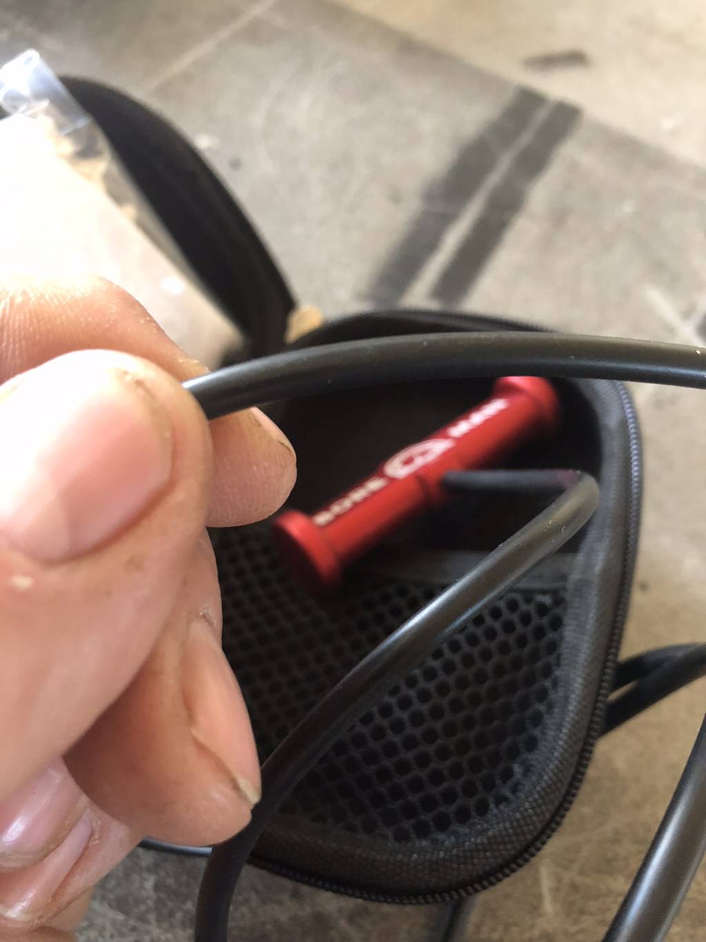

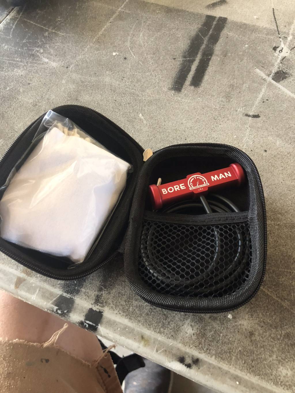

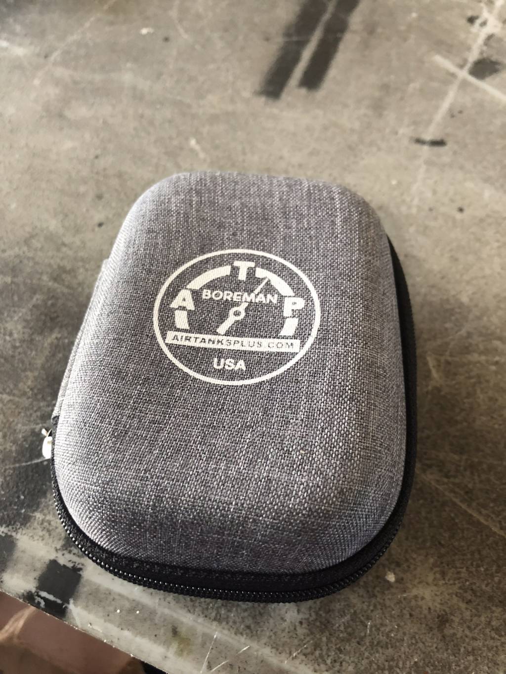

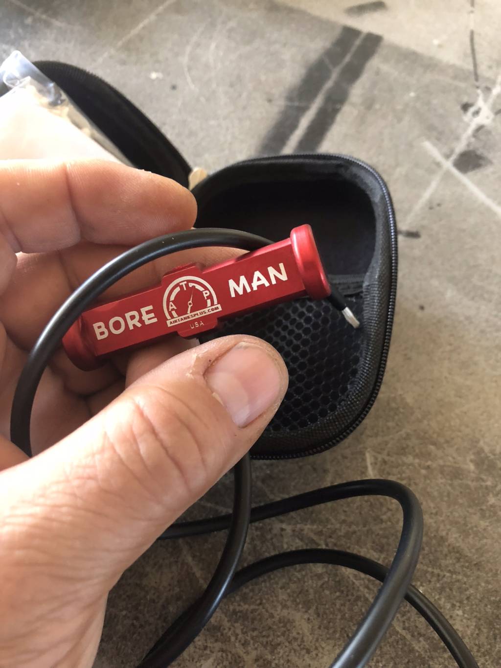

Tom, I typically pull a barrel out and clamp it on a padded Vice and do the whole shabang with a Dewey rod every chance I get, but for those times when I don’t have time to re sight in or don’t feel like doing the full shabang I rely on my BOREMAN pull thru from airtanksplus.com. Really well made, nothing cheap about it in parts. Cheap meaning crap parts. It’s actually not a bad price, especially for the quality you get and the convenient case. Really easy to throw in the kit box.
For the actual cleaner it’s a mix of Goo gone then a finish off with FP10, same product I use to lube my pellets with
