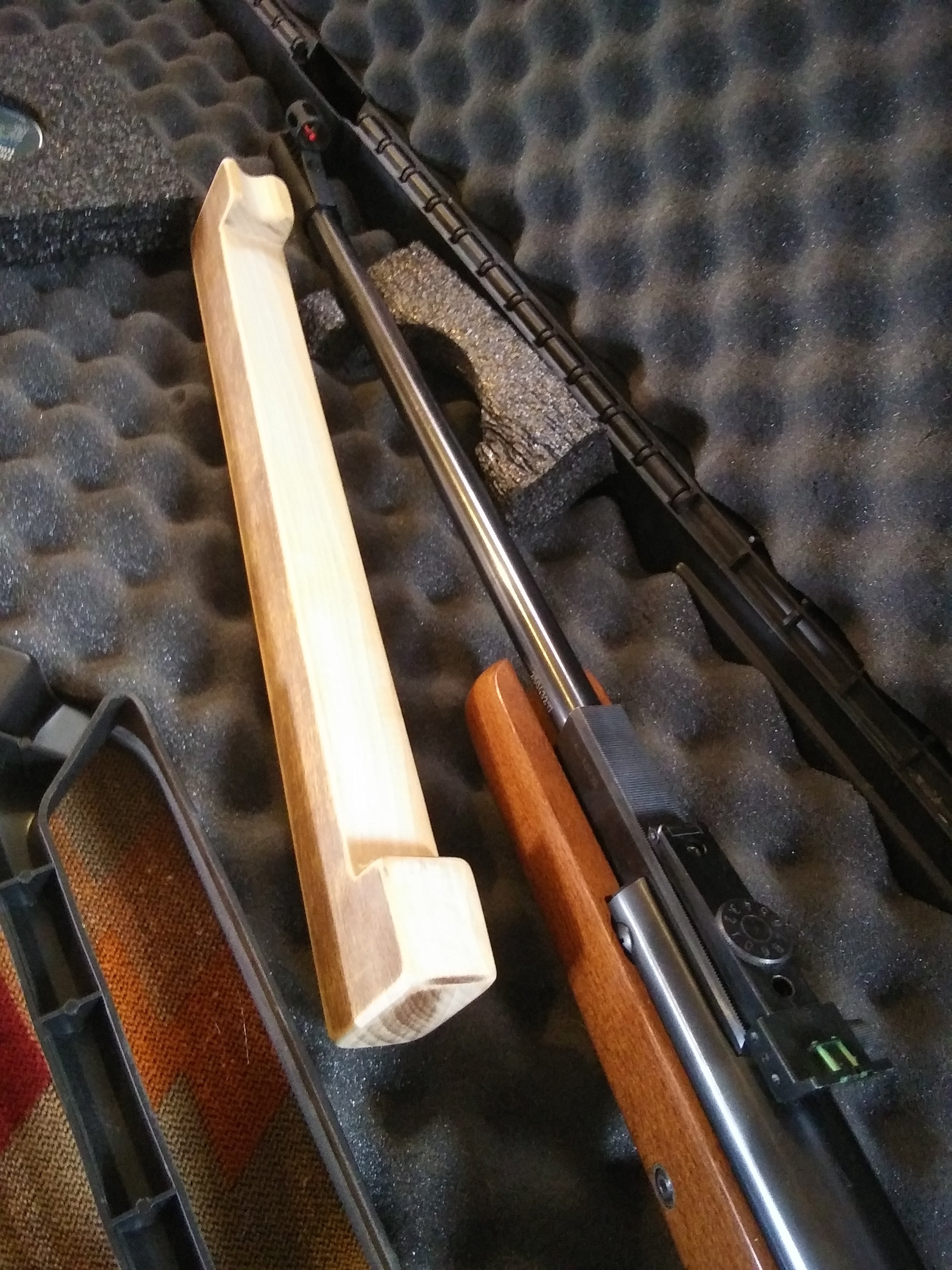

Attached is a photo of the rifle and the jig I made to straighten the barrel. Just a piece of maple cut to length with a lug at both ends. I cut a saddle in the front lug for the barrel. The rear lug is square and rests against the pivot block. It's as simple as clamping it in a vice and turning the handle until you think it bent a little. Then test firing and repeating until the rifle's POA and POI are in the same spot.
I do hope you removed the shroud and spring around the barrel before that.
I didn't remove anything. I took the action out of the stock to bend and re-assembled to test fire.
There is no shroud nor spring around the barrel of this rifle. You can see the muzzle in the photo. There is just a front sight up there.
The maple jig fits around the barrel behind the sight. The pressure is on the barrel alone.
The Hatsan has some baffles in a plastic lug. The barrel does not extend very far into that assembly. Again I put the saddle over the barrel. Not the "suppressor" assembly.
It takes a buttload of force to bend a barrel. If you rested that jig on a plastic part and torqued it you are going to break something. Common sense dictates that the jig apply force to only the part that needs bending.
Sorry my mistake. I mixed it up with the 48.
