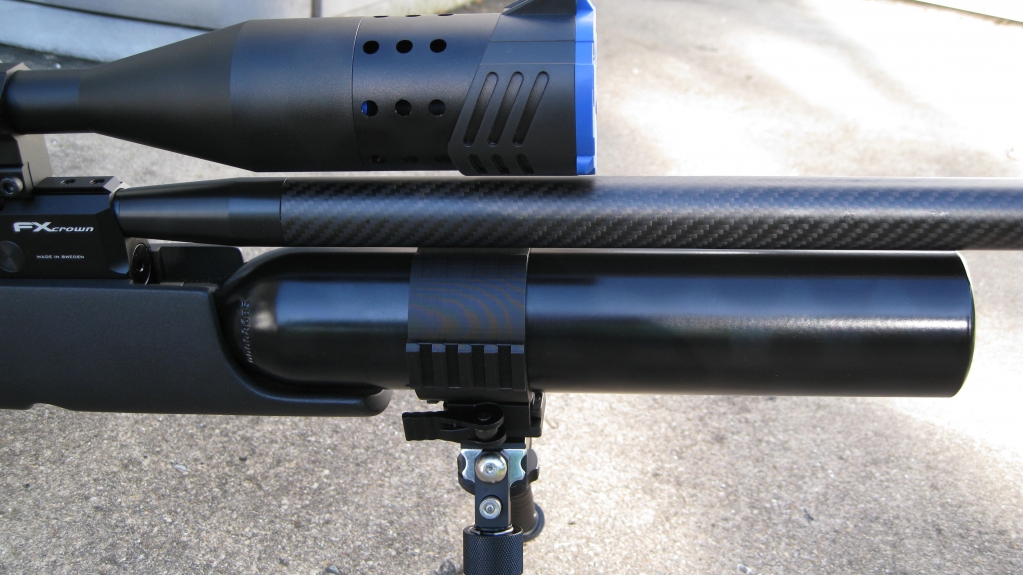

Barrel band for FX crown
I found this does anyone have one of these and would it create a problem i have a wildcat and it seems the wildcat and impact have more points where the barrel is secured i love the impact but dont like all of the o rings and places for problems i like the crown but the barrel has only one point of support could this be an option for more support on the crown ? I think it was matt duber that had a video on the way the barrle flexes after its shot ?
If only shooting pellets, I personally think a Crown with an original smooth twist barrel from a Royale would be a superb rifle. Nice solid barrel with all the features. Also none of the smooth twist barrels I have had needed cleaning to stay accurate while the STX barrels often need regular cleaning so the POI doesn't change or the groups open up.
Barrel bands bring their own set of problems with them. Your gun's POI becomes temperature dependent and pressure dependent if you attach it to the bottle. During shooting the pressure in the bottle drops and the bottle deforms to a slightly different shape and drags the barrel along, temperature does the same thing.

Guess the grass is always greener....... Many folks with rifles having barrel bands try to get rid of them. On average, it the barrel is sufficiently supported at the breech, I think it's better to remain free floated. In bench rest competition, you will see rifles that come with shrouds being used with them removed. In the current world of marketing gadgetry, makers are hanging more stuff from the barrel and its contiguous components, and they are all points of potential accuracy problems. Like most air rifles, the Crown should be handled carefully to avoid POI shifts, but I think adding a band might exacerbate that problem rather than fixing it. Part of the theory of free floating a barrel is, the harmonics (movement) of the barrel can occur consistently with each shot. Anything touching the barrel will be subject to changes in pressure from atmospheric conditions, or, in some cases the support of a rest or bipod. With many rifles, it's a bad idea to use any support on the bottle, as the barrel or shroud may touch the bottle when the rifle is fired, and any support on it can change the consistency of those movements. I would not attempt to "fix" any POI problem with the Crown until you know you have one.
I have to be honest, I now have two Crowns and have never had this problem. I don't think I treat them particularly gently, but I also don't throw them around by the barrel. There are a few things of note though which may cause perceived POI shifts that aren't actually the fault of the barrel/mount.
The factory shroud causes POI shift, retracted or extended. If you rotate it, you can watch your POI walk around on the target. I can only assume this is why it has an alignment pin for the extended position, and FX's assumption is that you'll transport it with the shroud retracted and extend the shroud and lock it in with the pin before shooting it the rest of the time. I personally prefer a moderator, so I simply moved the shroud stop rearward until it locked the shroud fully back in a single rotational orientation.
Rifle cant is another one. We're all familiar with how rifle cant works, however our flexible (by firearm standards) airgun barrels exacerbate this when we put extra weight on them. Meanwhile our popular brands of moderator are actually quite heavy and flex the barrel SIGNIFICANTLY. I test a lot of airgun silencers, and so watch them cause downward POI shift all the time, not due to velocity changes, but due to them flexing the barrel downward. That is all well and good, but now lean your rifle over a bit. Instead of your usual cant-related-drift, you've added a compounding factor of the moderator now flexing the barrel in a slightly different direction as well. So keeping your gun dead nuts vertical is important.
