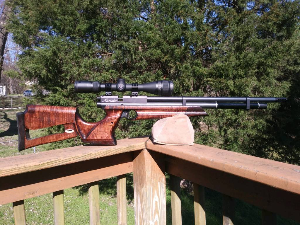

I have an original Varmint and a Diana Stormrider that I've added barrel bands onto. The added bands absolutely make the barrel much more stable to any impact or even light pressure, which previously could move the barrel quite noticeably. But I still wonder how it might change POI with change in tube pressure. I haven't tested it as I believe that shooting around a narrower pressure range would not cause such a change and shot count is not a major concern for me-I shoot as needed and keep pressure high. But many certainly have expressed the belief that added barrel bands might cause such an issue with pressure change over a broader range.
