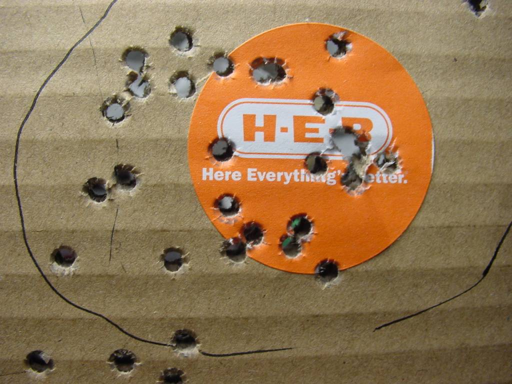

My Superior Heavy slug barrel looked even worse. Only thing is, it shot even worse than it looked. I was told to contact FX USA and I did. Never heard a word from them.
I removed the choke which was .005" Huge choke! (Far too much choke), and polished the bore.
Here are before and after pics.
Knife
This at only 50
 yards.

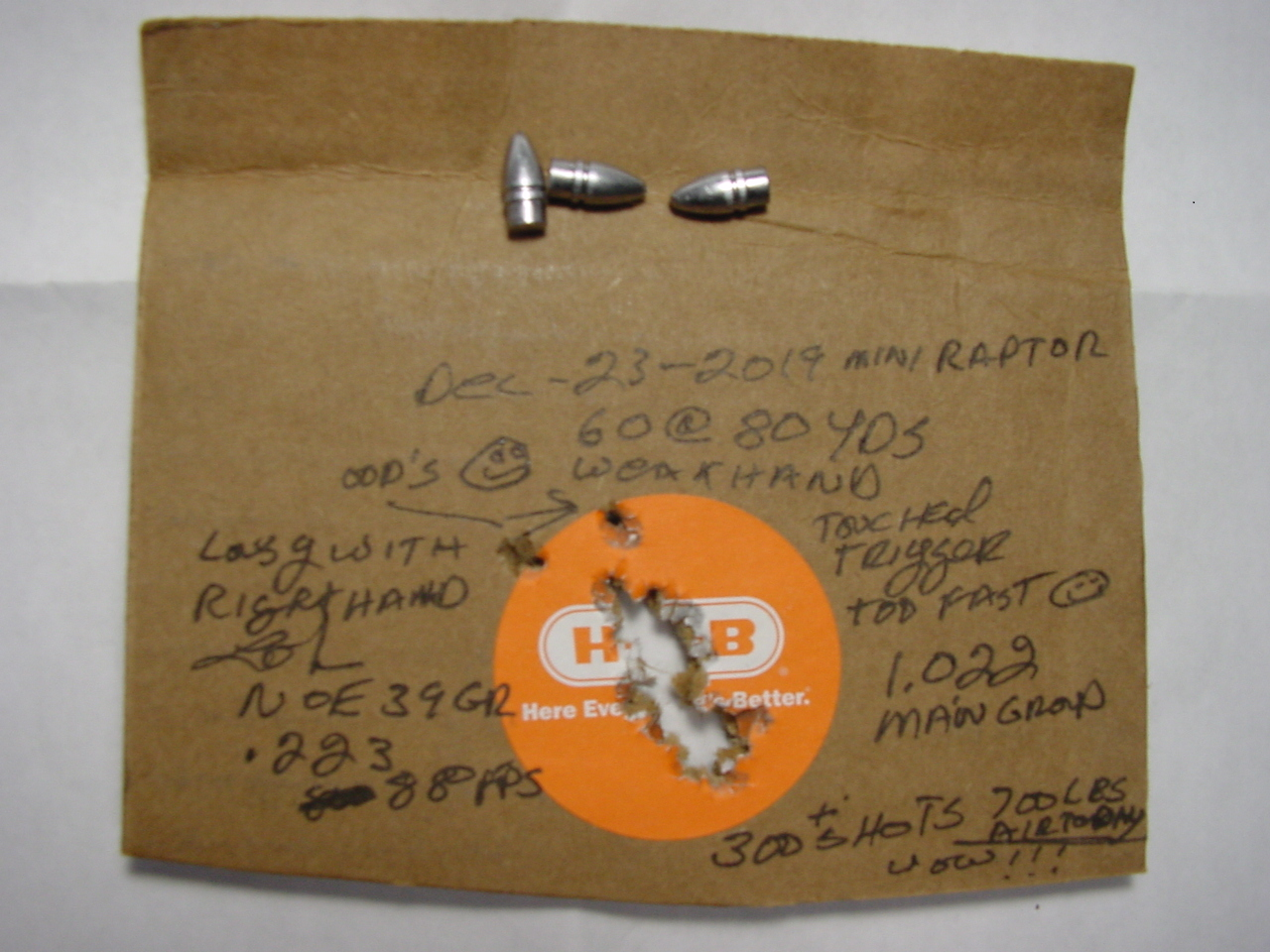

Now, 80 yards. View attachment DSC02497.1610764171.JPG and a 11 shot group. One to settle the reg, 10 on target.
OK I went ahead and installed the ugly liner and drove out to the range to shoot it. No wind at all today that never happens. There was a slight drizzle of rain falling most of the time though. Spent the first hour shooting what I thought was 18.3 JSB's but finally figured out that I had put the wrong lid on the tin and they were actually 13.4 pellets. Went from lower 800fps to lower 900fps and the best I could do was a 3/4 inch group at 50 yards.
So, then I shot some Air Arms, FX, and Polymag 16 gr pellets they did not do that well either although I did get some nice 4 shot groups there was always a flier that opened things up to 3/4 inch.
Started the 18.3 grain JSB King Heavy pellets out at just under 800fps and raised the fps up a little every five shots. I started getting some clover leaf one hole 3 shot groups pretty regular at around 830fps. But they opened up mostly 3/4 and a few 1/2 inch groups with five shots. Doesn't look like it can do better and I think it should.
I tried some of the NSA 20 gr slugs at around 830fps too and they printed 1.5 to 2 inch groups.
For a barrel that is posed to shoot most things well this one has failed miserably thus far and shoots as bad as it looks. I will try one more time before I see about sending it back.

That 80 yard group is what I expect out of my FX barrels and guns. Both my .177 and .25 liners/barrels do that often. But they came from the factory that way.
Great job you did on that barrel for sure.
