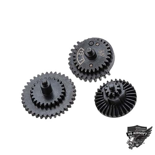

Im making a parts list to upgrade my 400E for higher rate of fire and accuracy. Im going to be using 13:1 gear set instead of the stock 30:1,a reduced power spring to get to 250fps, and a mosfet for better trigger and pre-cocking function. This will improve the lock time of the shot and a faster RPM
