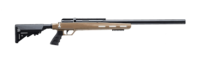

Gun looks awesome to me. Air tube over the barrel. Rear cocking bolt. Seems lightweight and tunable with adjustable regulator and hammer spring adjustments. 22 and 25 caliber. Says the 25 comes out of the box at 50 fpe and you can adjust it up or down from there.
Best part is it's a Barra so I can probably afford one when it comes out. Poor man's FX DRS!

Kinda looks like the artemis/snowpeak M30C that has been out for a while now.... Here is a photo for reference...
well, it certainly does
Slightly different stock but easy to see it's the same gun with minor modifications
Assuming it is the same, I would like to see a higher fill pressure than 3600 psi. With a regulator I don't see why any gun shouldn't be 4500 psi.
230 cc air capacity... a little on the low end there as well.
But I have been looking to add a regulated .22 caliber to my collection. If the price is right and it performs, still may be of some interest.
Now that you've got me looking at Snowpeak I like this M30B with the wood stock! But again 3600 psi. I would probably buy a "cheapo" AEA Challenger SL wood stock with the regulator, get a lot more power and 4500 psi fill, still inexpensive.
