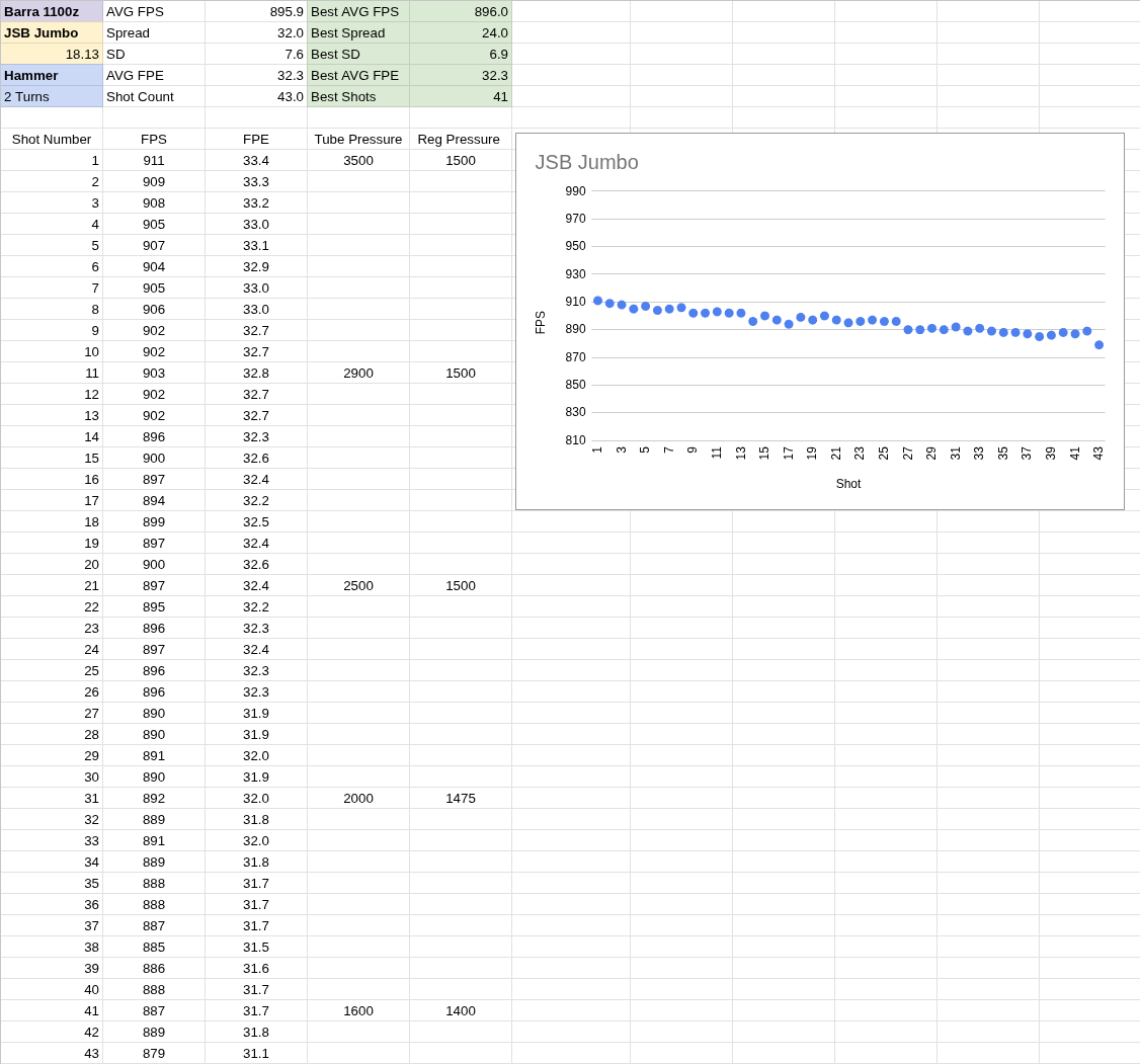

I'd say my biggest observation is that I can't seem to reduce power enough to get the 18.13 grain JSBs flying under 900fps. My hammer spring was 7 turns from flush from the factory and in my opinion way over tuned. Even at only 2 turns from flush I'm still sending the 18.13s at over 900 FPS for the first 12 shots then 890-900 for the next 28 shots before falling off the regulator. It is grouping pretty well at 40 yards with the occasional flyer and honestly I've been firing quickly being more focused on tuning it down than really trying to get the best groups. None of the heavier pellets I've tried have grouped any better despite getting them in the mid 800s or lower. So far I've also briefly tried JSB 15.89, the JTS 18.1, 22.07, and 25.39 as well as H&N 18.13 and 21.14. I've not tried tuning for any but the JSB 18.13 so maybe some of the others might group better with additional tuning later on.
