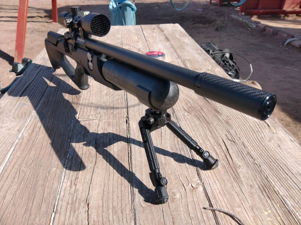

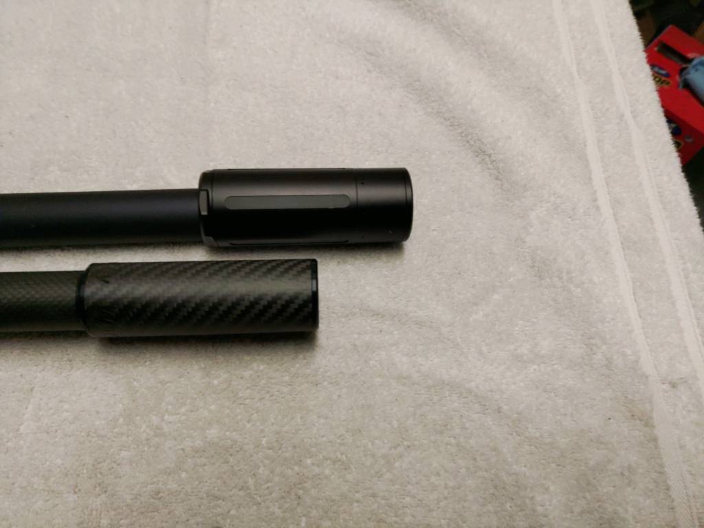

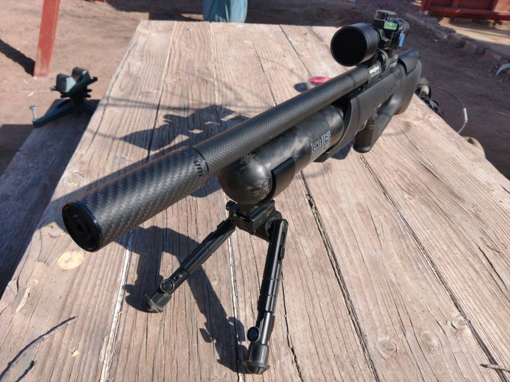

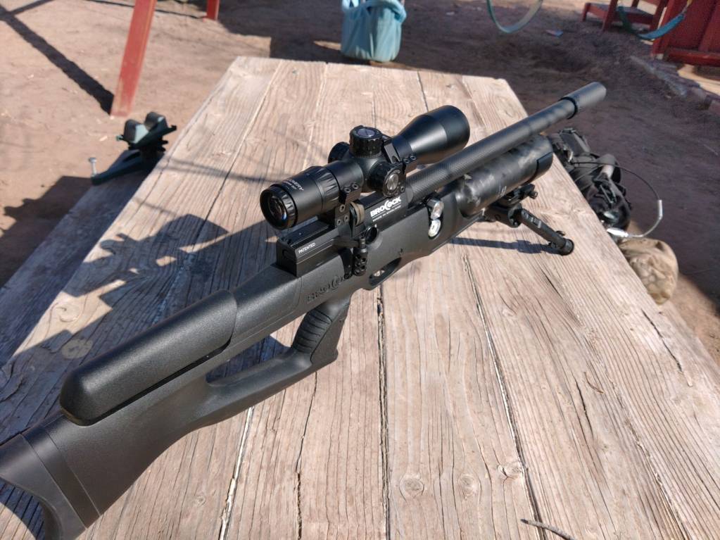

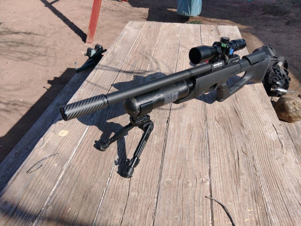

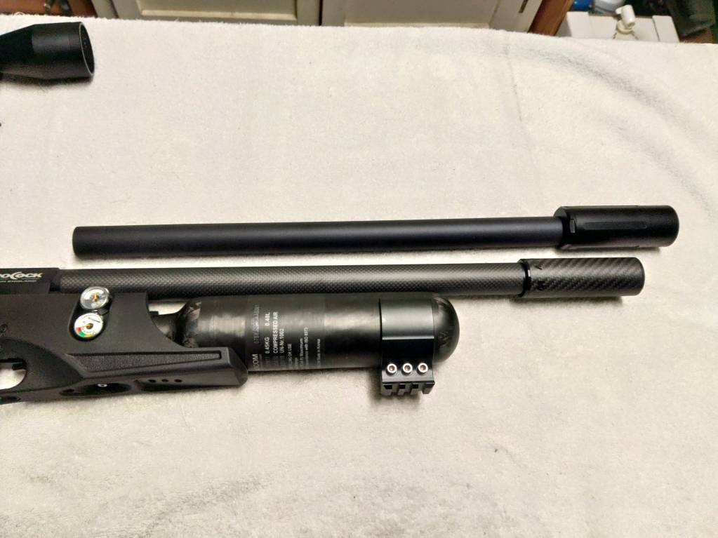

I received a new to me Bantam XR December 28 and after my first shooting session in the back yard, I went inside to look for a shroud to quiet the bark this pcp has. My neighbors are over a hundred yards from me but I still want my pellet guns to be a quiet as possible. After looking for several hours, I came across an ad by Bullysyclone. After talking with him for several minutes of what I wanted made for the bantam, I sent him the Bantam. Just yesterday i received the bantam with a custom shroud and it's awesome. The shroud totally changes the look of the gun, the shroud is shorter than the stock shroud/tatsu combo, and more importantly, the shroud is slightly quieter than the tatsu and night and day quieter than the stock shroud. I highly recommend Bullysyclone if you are looking for a shroud for your pcp.

The tip of the barrel and the tip of the stock shroud is empty and the end piece looks to be sized for a .30 cal. which made the XR very loud. I can't speak why your Sniper is quieter the XR. I did purchase mine used so maybe it had baffles. IDK.

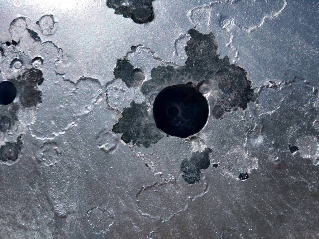

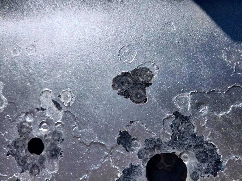

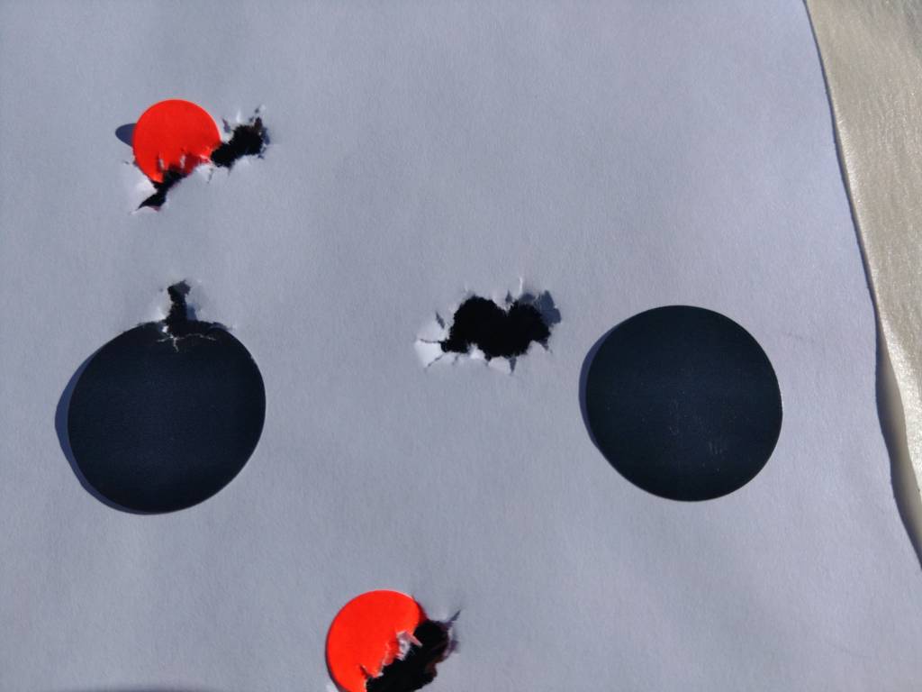

Three days ago I put over 20 cleaning patches through the barrel and got it as clean as possible. Warmer temps and zero wind outside, I quickly checked zero at 30 yards and started shooting to 50 yards. I can say this barrel needs to very very clean in order to shoot great. This is a first for me because every pcp I've had needs the barrel leaded up to have accuracy. 30 yards, the bantam is back to single hole groups and 50 yards is about 3/4 inch with a full mag which is good enough for hunting. I was able to shoot a full mag (10 shots) in to a 1 inch circle with no problems.
30 yards full mag:
50 yards full mag
1 Inch hole 50 yards:
I'm glad this was all that was needed and I can stop eyeing several pcp's in the classifieds.
30 yards full mag:
50 yards full mag
