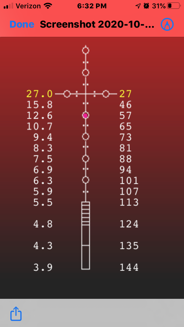

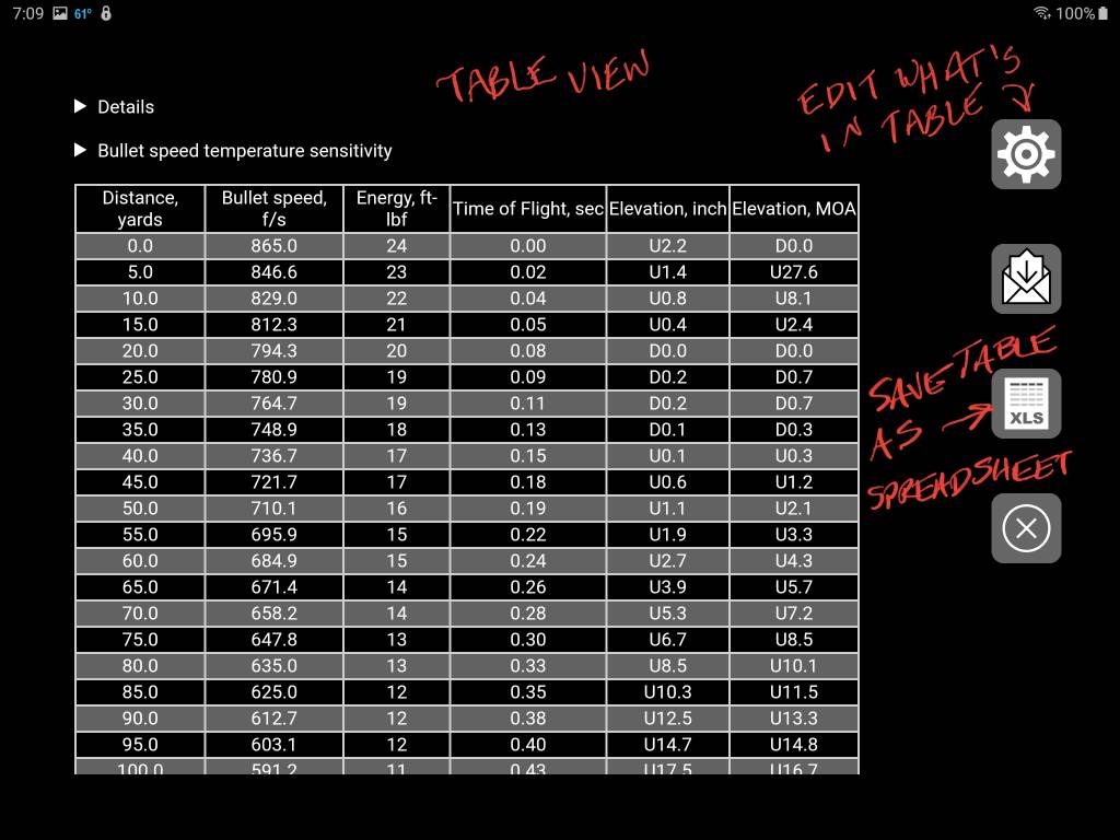

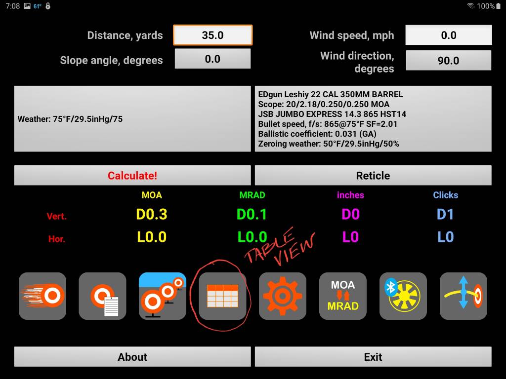

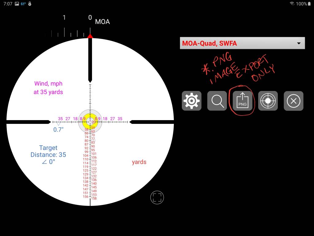

I have been playing with "chairgun" and I like it but wanted to be able to print my reticle with hold overs for my scope. Like the screenshot bellow. But in a file format that I can change data. So I downloaded the "Strelok Pro" and it is more complicated to get around in. I havnt figured it out yet there is a lot you can do for sure. I tried to show what I want the .png is how it comes out of chairgun. I like it but some of my hold overs are not actual, so I messed around with a the photo and added the correct numbers shown in the jpeg. I notice in Strelok you can sent files and print. Is anyone familiar with what I am trying to do and straiten me out. thanks in advance
