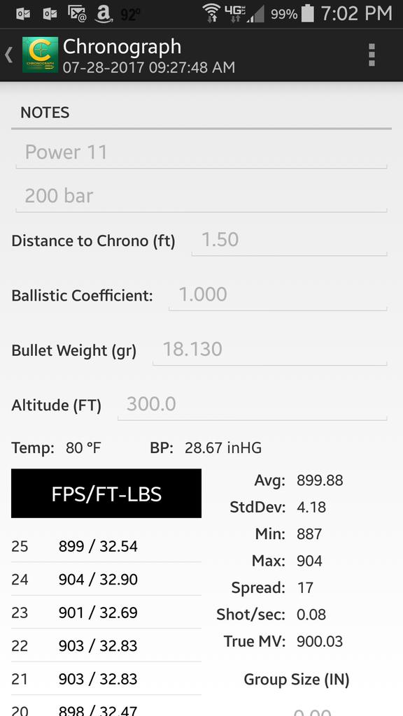

I have G1 and G2. The G2 works well sitting on my table about a 1.5 ft from the barrel. I have to use the led lights most of the time due to the unit being inverted and shading the shot. My G1 I never needed the lights. I have never ran out of charge with it though. I do shoot more than an hour.

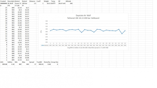

I use an android and sometimes/recently (maybe firmware update) it crashes after shooting more than 80 shots (I do this when others want a shot count per fill). I wish it held them in a memory instead stopping and starting over. Also I wish I could merge two together so if it did crash (large count) I could save say 50 shots at a time. Like stated above it would be nice to a have a Caldwell software to easily make a graph. Ya I do it on excel but it would be nice to hit a few buttons and have it do it for me.
My bluetooth always connects, no problem there. Super easy to use app. It comes in a nice soft case. Overall for the price it is good ($150 sale at Cabelas) I use it every time I shoot at the bench. Overall I would recommend it, just giving the negatives I've found. Also in the past dealing with Caldwell customer service has been great.
