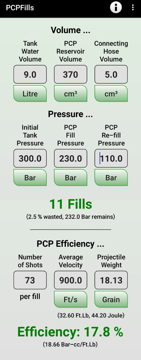

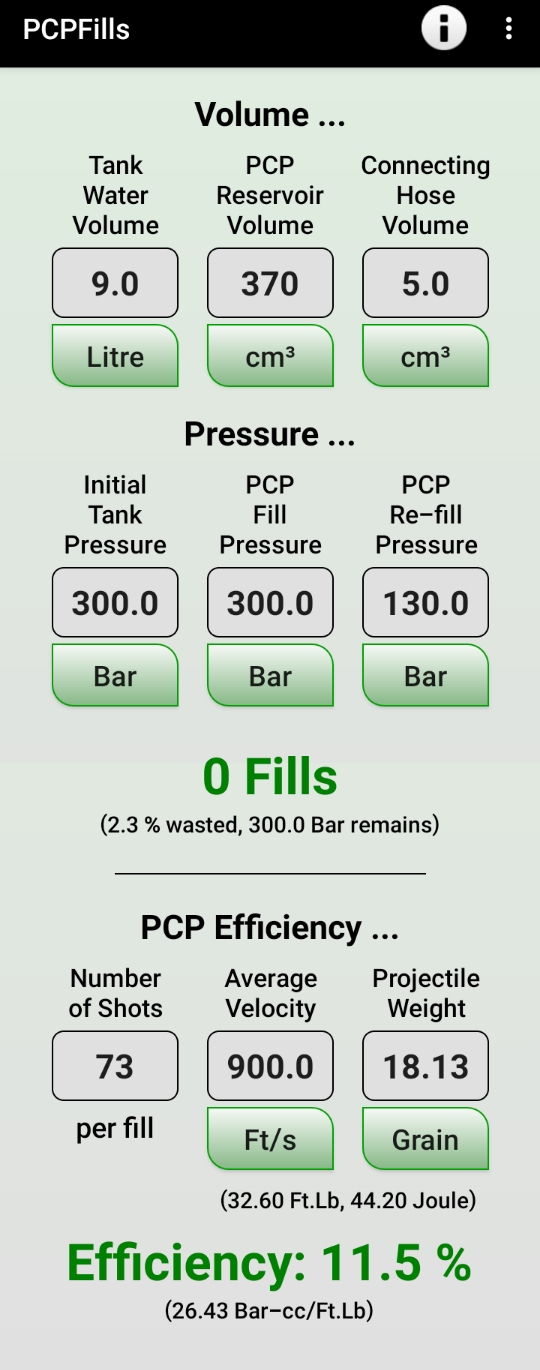

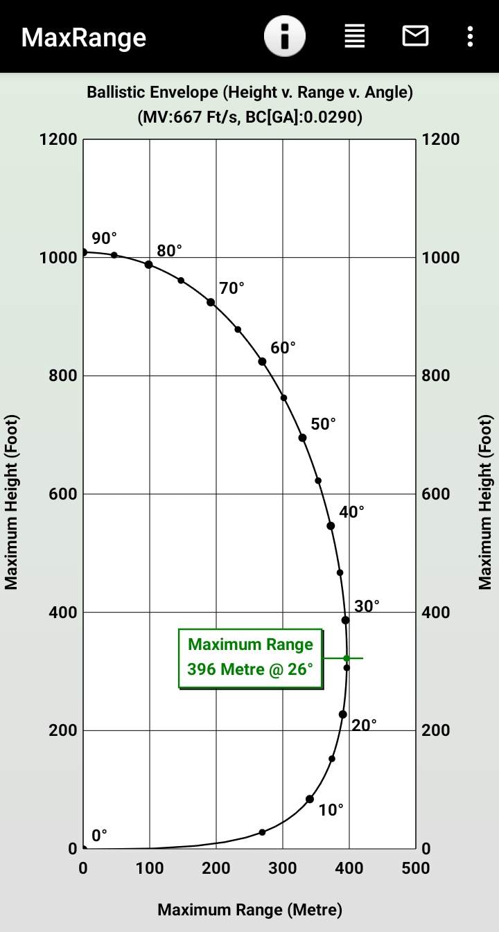

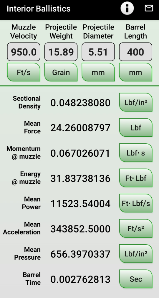

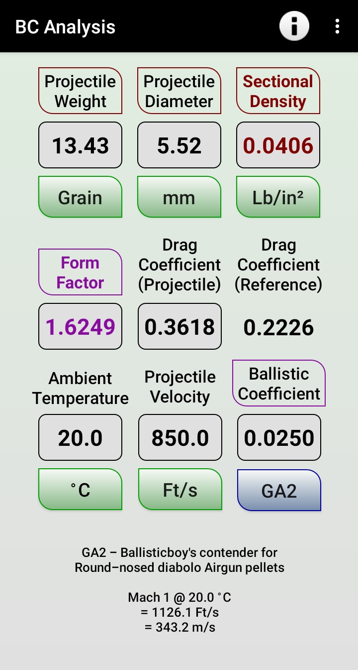

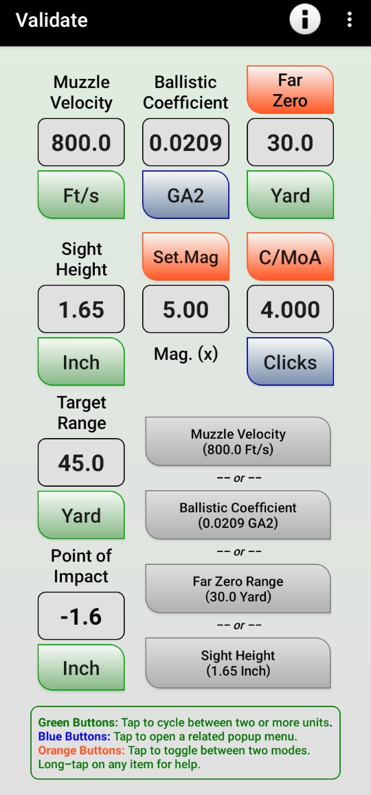

🔸The new kid on the ballistic calculator block is an app by an airgun enthusiast from the UK, G. P. Conway: GPC Ballistics Applications.
It's a full suite, for Windows, Android, iOS, Linux.❗
Free! 😊
He did the app for the fun of it — and it has some functions that Strelok Pro sorely lacks, for example, BC calculations using the GA drag model, interior ballistics off PCPs, and other goodies, cf. screenshots below.
Link for the download:
Matthias
View attachment 281284View attachment 281287
