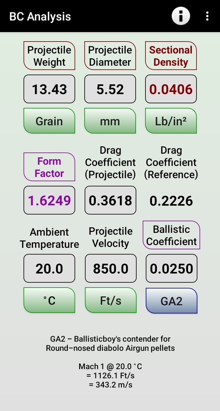

▪ Extraordinary feature for longe range shooting — that require precise BC data: The app allows you to either enter your own custom drag profile (derived from your BC testing, this is Labradar's playground). Or, you can enter up to 5 different BC's — each cued to a different projectile velocity (cf. Bob Sterne's BC tests showing the BC variations with the GA drag profile when using JSB domes, for example).

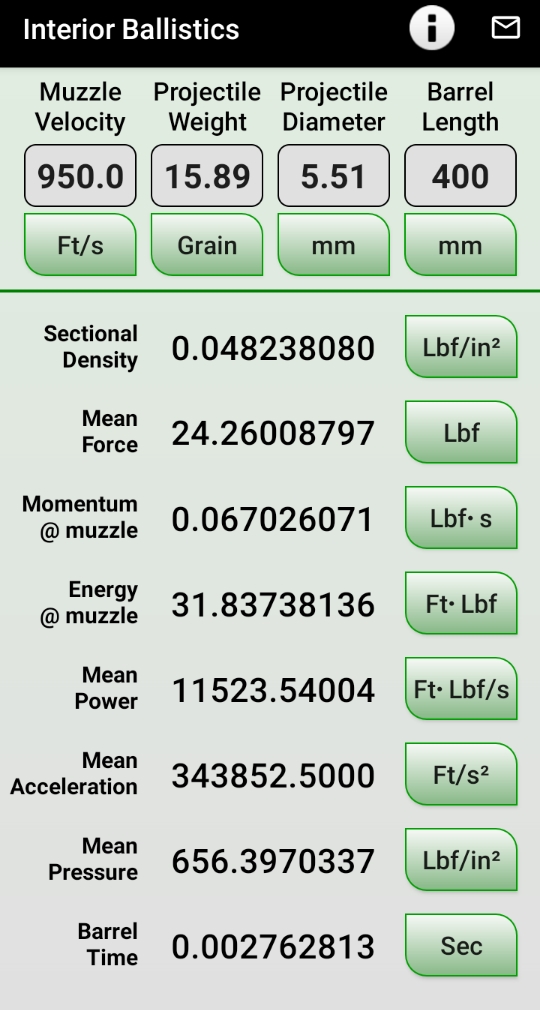

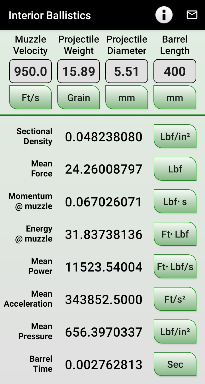

He did the app for the fun of it — and it has some functions that Strelok Pro sorely lacks, for example, BC calculations using the GA drag model, interior ballistics off PCPs, and other goodies, cf. screenshots below.
