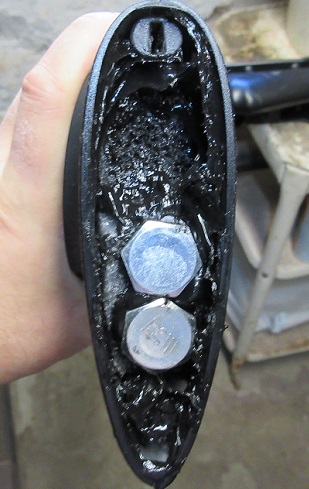

I've used PA pellet foam cut in chunks and crammed in as tight as it can be in case I ever want to sell the rifle. On rifles I know I'll never sell, I've gone so far as to use the black 100% rubberized Silicone to coat the pieces, jam them in, let dry overnight and if I did want a little weight, poke holes in the foam and shove 3 inch bolts in the holes. Only tried that trick on a couple since it's messy and just the PA foam works well on it's own.
