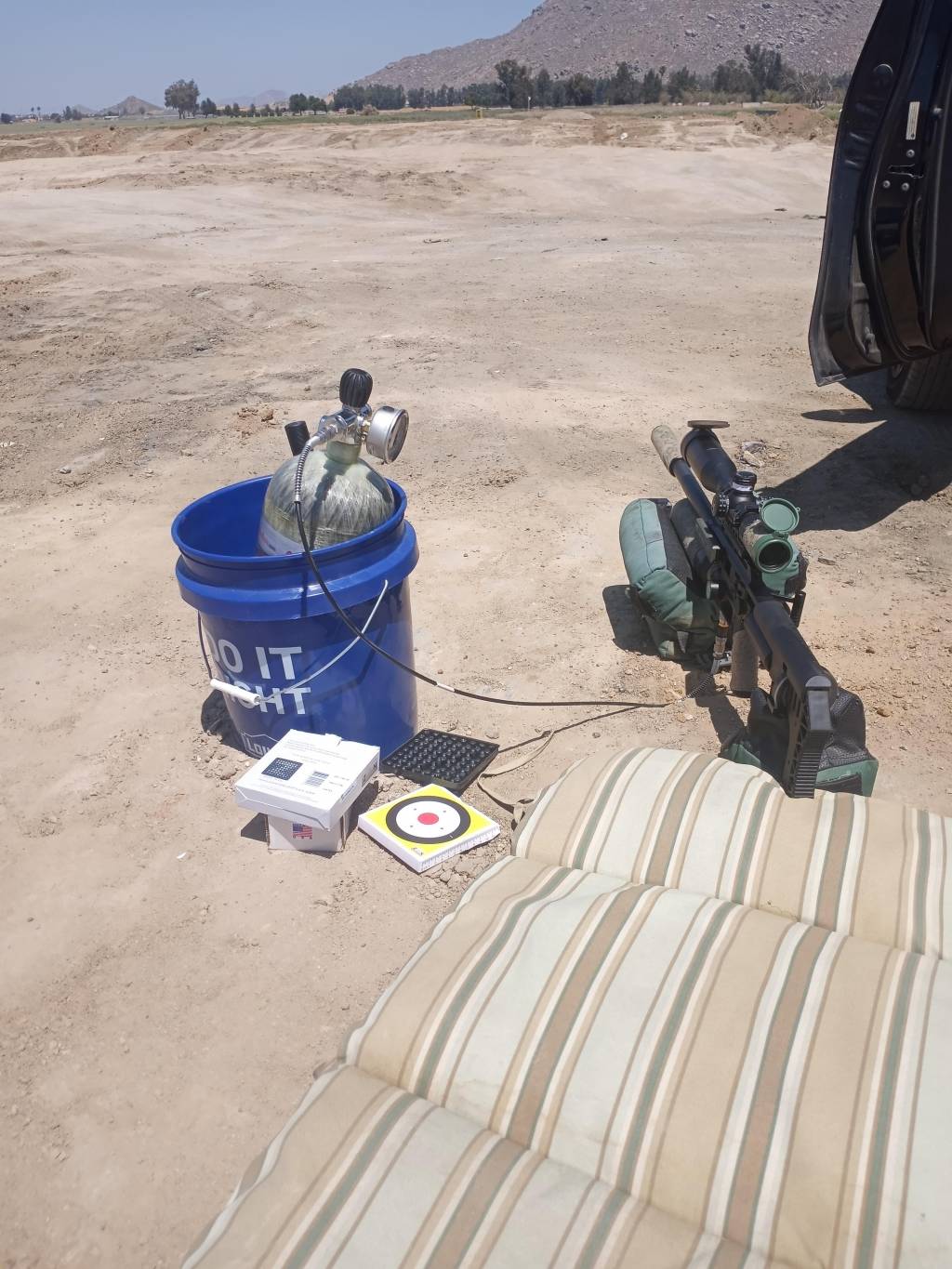

You can raise your first reg or just get reg delete.I ended removing it due to you only have 50 bar of reg. I don't want to get 300 bar bottle. I'm getting go results with zan 54 gr at 935 fps reg 162 bar. . Heavy brass hammer hits too hard so I have my power wheel at 1. And brought in front knob for better shot string. I'm thinking I don't need Heavy hammer. I be testing 59 gr zans next week .I'd show targets but shredded adjusting for good shot strings last one.. It was windy .midday. half inch groups 75 yds. Have heavy barrel. . 49 gainers were duds.
