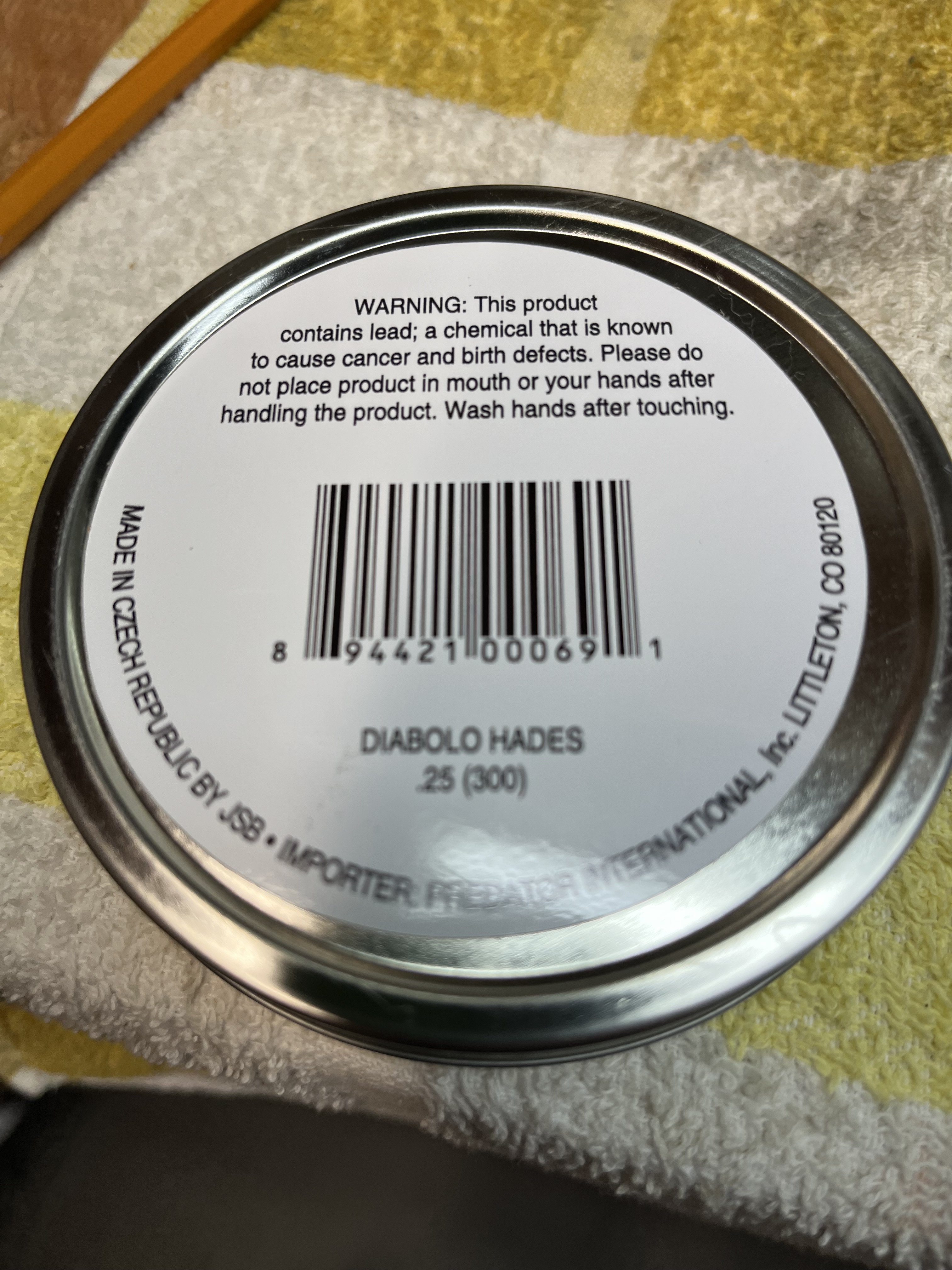

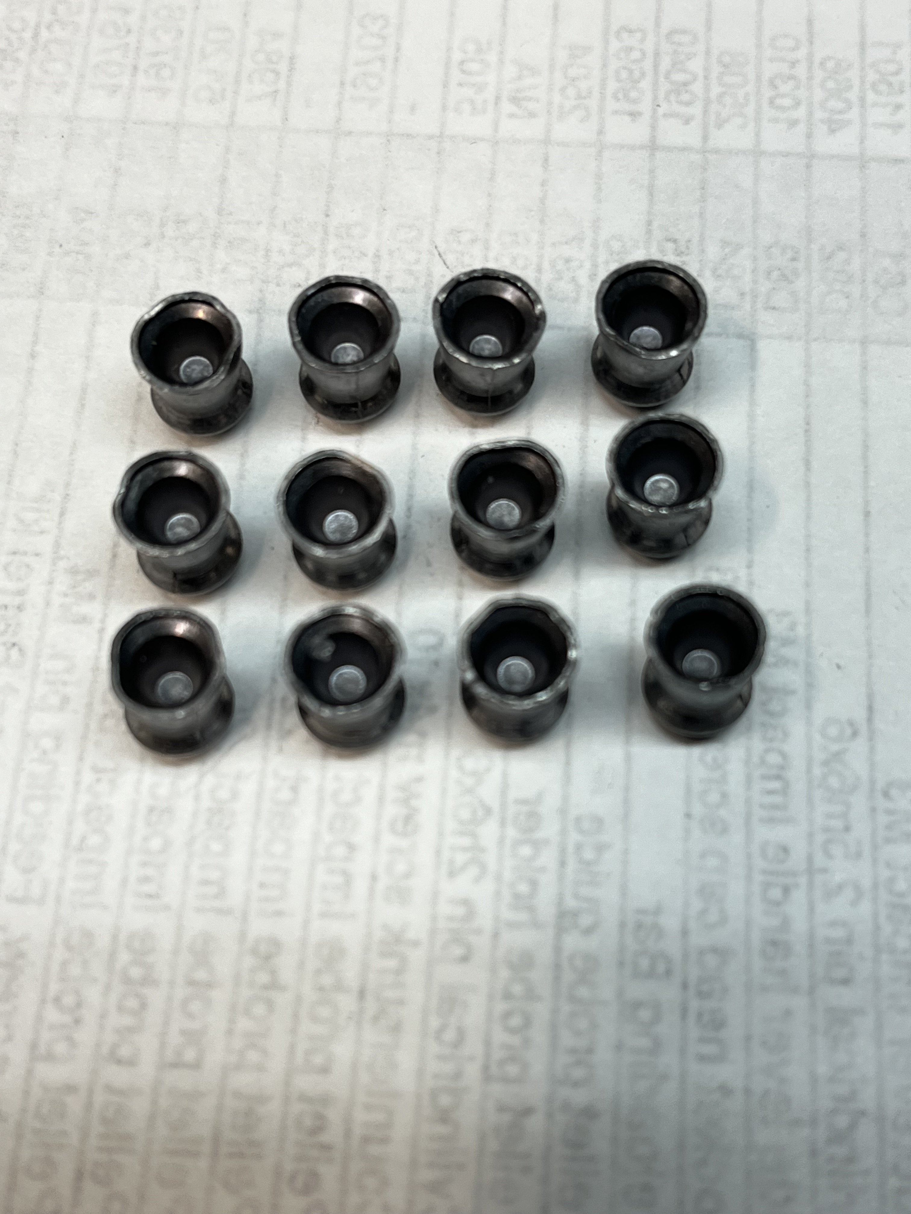

I usually buy my pellets 4 or 5 tins at a time. Bought a supply of JSB Diablo's in .25 and .22. Did not have a problem. I also bought some JSB Hades. The last couple of tins of the JSB Hades have been absolutely horrible. I then opened a couple more just to check and they are the same, terrible. Problem is I bought from a couple different sources so I don't want to mention anyone specifically as it's probably not their problem anyway. Anyone have a contact or can point me to someone at JSB in the USA to send them photos and photos of the can lot number. These might be a year or up to two years old sitting in my basement but I didn't get the only bad tins from this batch. They have had to have had some complaints prior to this. Ideas please. Thanks

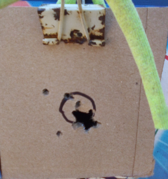

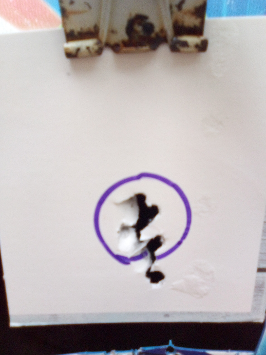

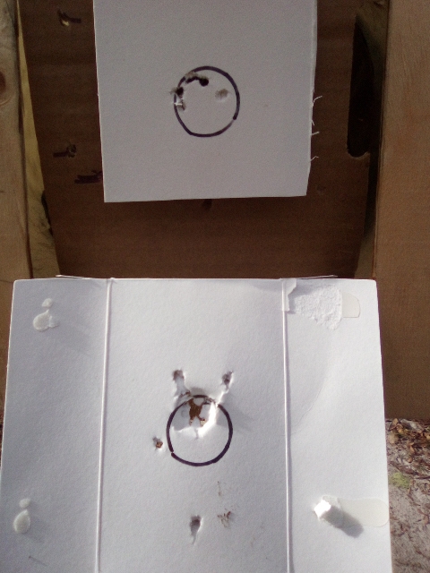

Them pellets are pristine compared to the several times shot pellets I reuse.
I'm amazed how a chewed up by rifling , beat to heck skirts after shot several times in to a trap recollected and reshot again do .. ya, there's a flyer or 2
Pretty much lost count of how many times shot
And still get this at 10m
I guess that gun ain't picky ... lol

Well as an old fart I am going to have to eat a little crow. On the tin I posted I read the Importer was Predator International. I called, they answered. I sent them photos of the cans and pellets and spoke with Joseph Iturralde. After viewing photos and tins he is sending me replacements without being asked. That is a business I can deal with. Stand behind your product and I'm yours!
Those fliers are probably the bent skirts. Lol.
His are definitely a bit extreme and Crosman skirts are also harder than JSB so that may come into play. When I tested JSB bent skirts they did decent enough at 30m. If you were using them for some longer range hunting it wouldn't be advisable but 50yd plinking, go for it.
Ya, you'd think being softer the jsb skirts would "self fix" as soon as the hard blast of air pressure hit and conformed them to the barrel wall so to say .
