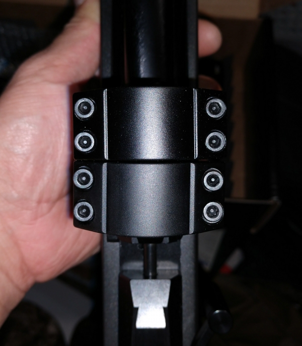

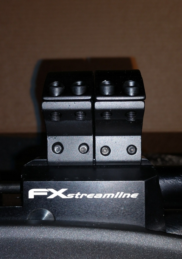

Turns out they were severely out of alignment, and don't give enough clearance for the factory Streamline magazine. So I'll need to order high mounts.. Here are some pics to show the problems.

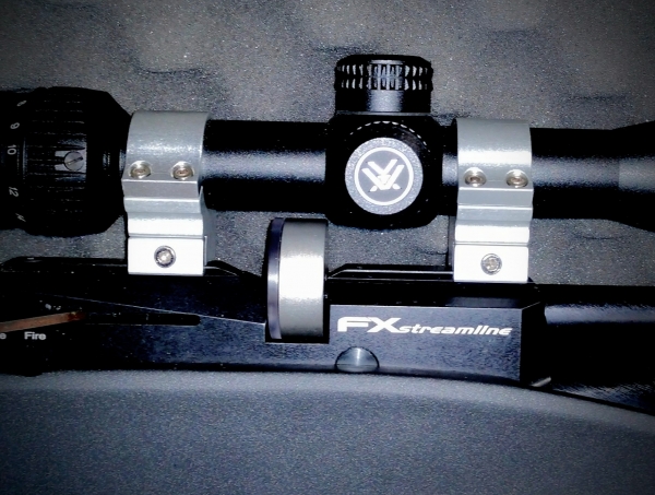

What I might do is just take the whole scope with mounts off my Benjamin Maximus and put it on the FX just so I can start shooting it. The scope I have on there is decent....a Vortex Crossfire II AO 6-18x.

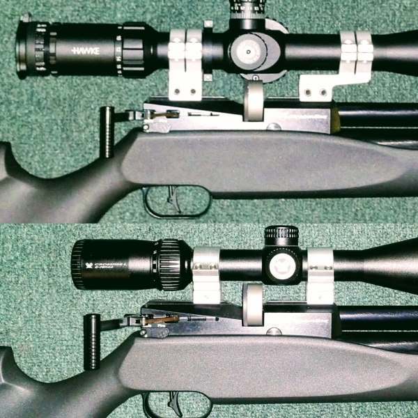

I finally got some time to mount the new scope. Here it is with the BKL mounts compared to the old set-up. I went with the offset forward mount so the clamp would be further forward on the scope.
You can see that the new mounts are a little higher, which makes the scope clear the magazine completely, and afford me a scope position for proper eye relief where it's comfortable. With the previous mounts, I was forced to mount the scope where you see it.
