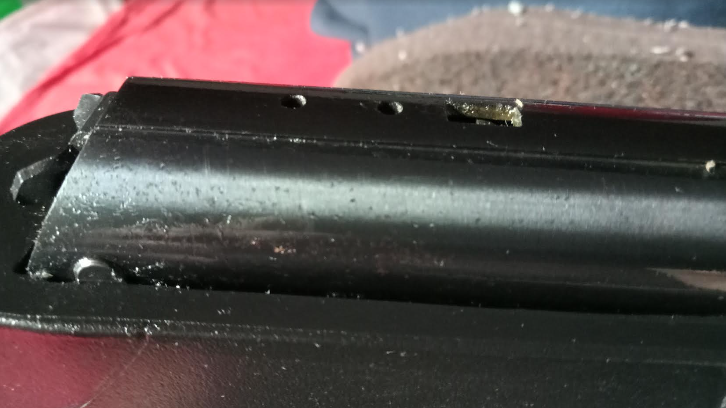

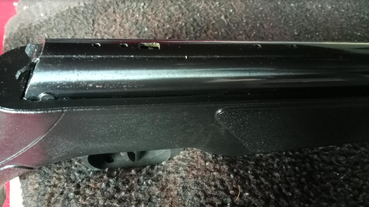

I can't understand how a spring guns compression chamber/cylinder "explodes" unless it diesels to the extreme. Do you mean the end plug popped off or something? Hard to believe any airgun would explode under any normal conditions.
Mine did not diesel, it couldn't since it wasn't lubricated/splashed with oil inside the compression chamber... Here's the link to the images:

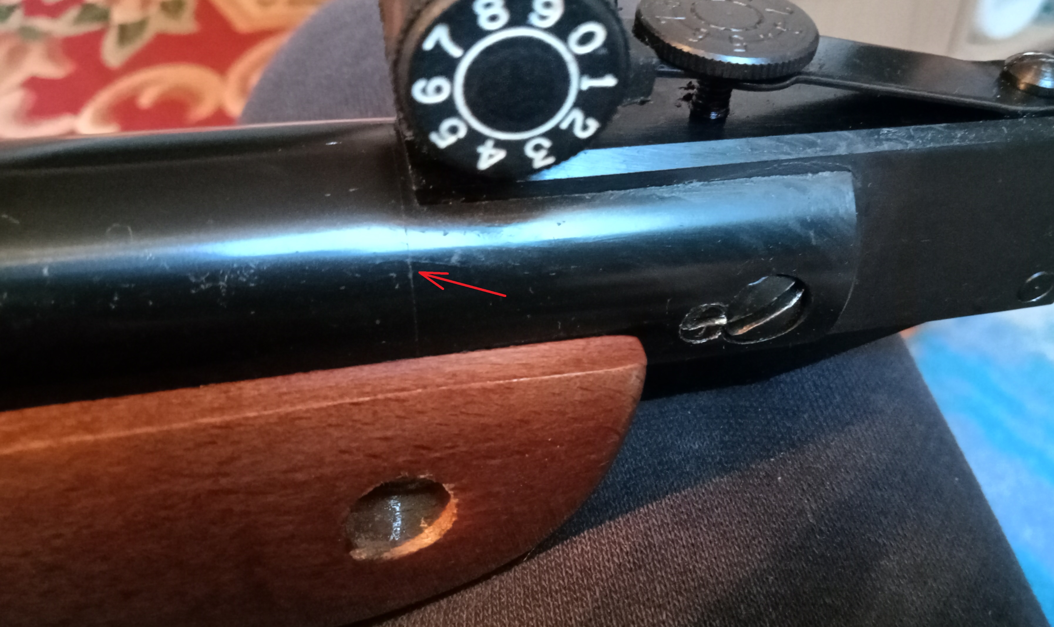

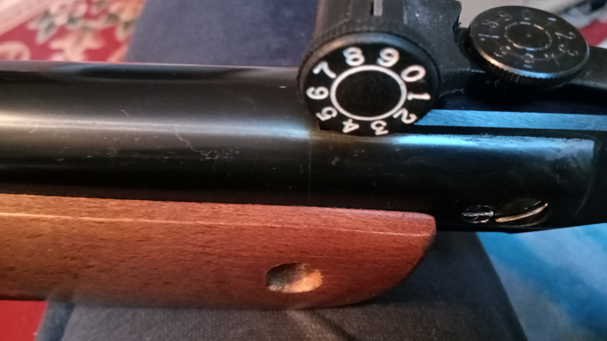

Hey, I got the photos of my friends' Cometa 200 and as I've already said, there is a clearly visible line/seam, where the front portion of the receiver, or cylinder if you will, is protruding and being offset out of the rear part. Cometa has had these issues for a long time it seems...
There is a seam between the compression tube and barrel fork. Some manufacturers friction weld these together while others use a different method. Some guns are more noticeable than others. My FWB Sport (probably my favorite gun) is quite noticeable. Theres a bit of a brownish color change where the heat was applied to combine the two parts
Yes, my Cometa also had a brownish "belt" around the place where the two parts of the receiver were merged together.
All I see is a line. No gap.
Fair enough.
Yes, it's a line which you can hit with your fingernail, or stick the tip of a toothpick into, because even if it seems small or even barely noticeable, there's still a protruding piece of the front part of the receiver there. I'm pointing this out, because that's the exact spot where my gun ruptured.
Oddly enough though, my friends' 200 still works and hasn't ruptured, even though it's probably got some 10.000 pellets through it. I guess only the outer shell there got separated? I'm just guessing here, but the bottom line is, the inside of the cylinder/receiver is still intact!

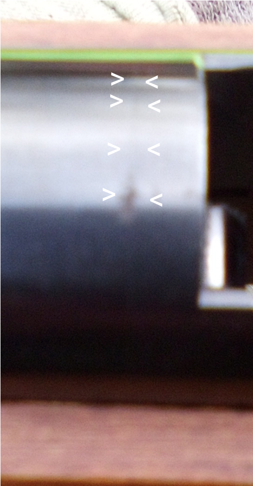

Had this hw/R9 out and thought about this " ring" and it's there .
Seems it's the mark from how the transfer port plug/ end was pushed in and electrowelded and the ring seems to follow that ..
I'd assume cometa must of had there welder just a tad too hot and caused more a burn through..
My cam suks but I tried to show it ... Sorry
Thing is if I did not see this thread and went to nitpik looking I'd probly never paid it any mind or noticed it ...🥴
( Notice that one rust spot that started from it )
Don't be sorry; The image actually tells the whole story and makes everything clear as day, even if it's blurry and all, because we know what we're looking at.
It makes me wonder though whether that ring or belt, if you will, in that exact same spot on my Cometa 300, was a rusty spot left by the over-burn of the electrowelder, or just an instance of case coloring from the welding process 🤔
