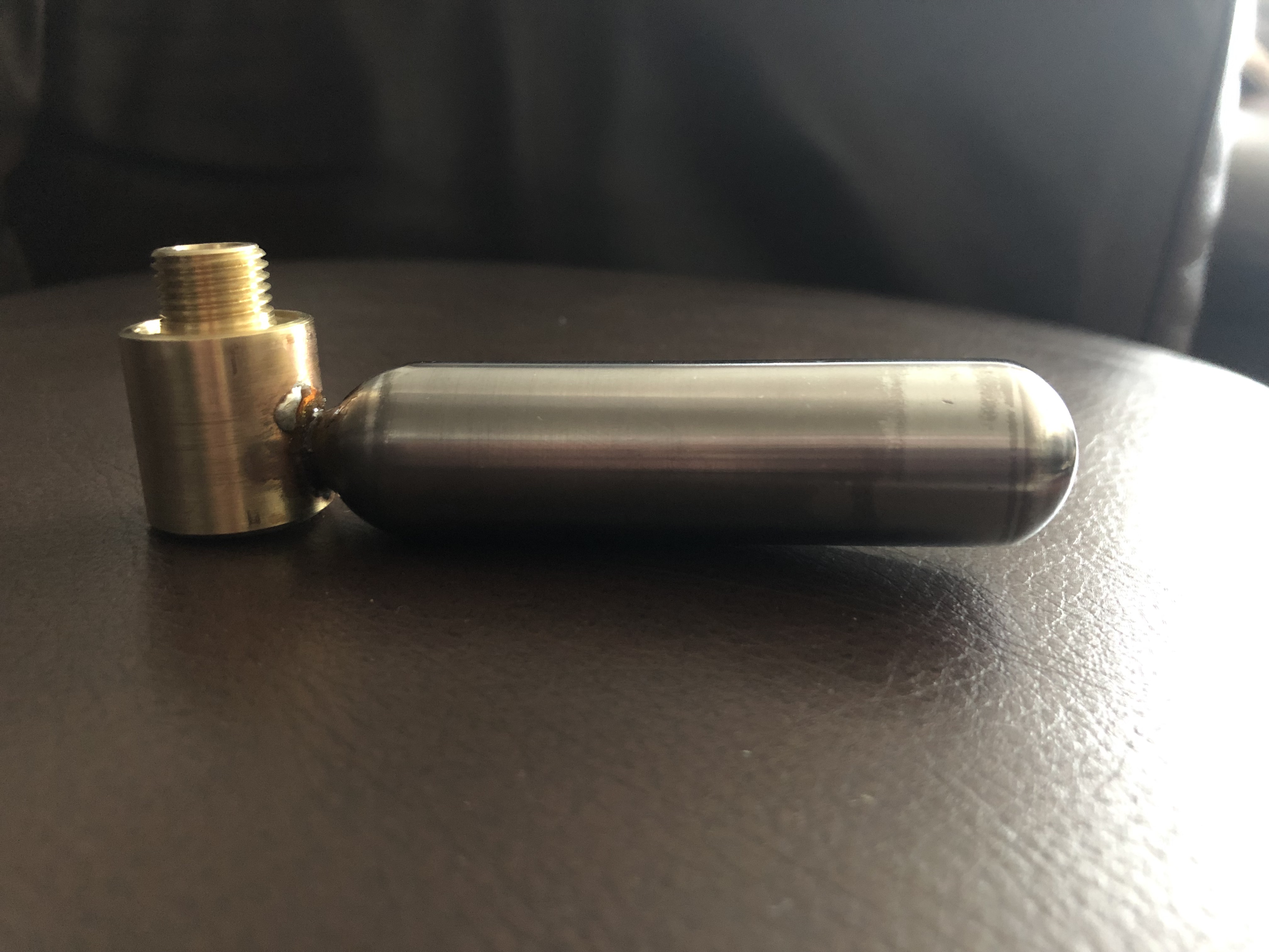

The only Plenum I'm using is this:

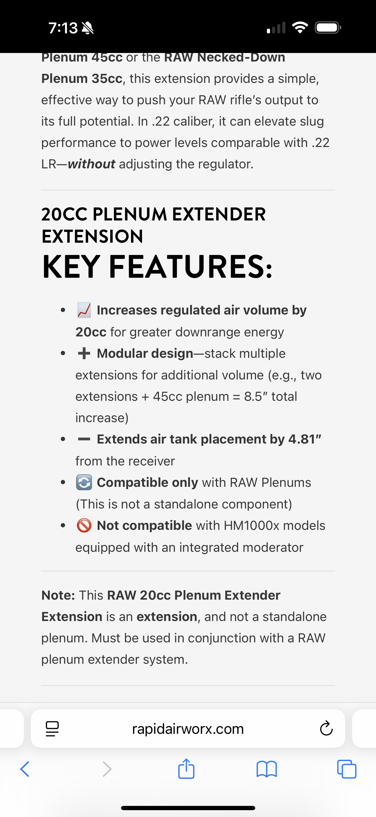

You are missing the part that goes between the reg and the plenum extension. Both the smaller and larger plenum extensions are designed to be used with the adapter part that goes between the reg and the plenum extension.
No this isn't correct. There are two plenum extenders (35cc & 45cc) that can be used alone on your gun. The 45cc is full-size and the 35cc is necked down to fit the LRT stock. The plenum screws into the action body, and the regulator will screw into the end of this plenum extender and you're good to go. The 20cc Extender Extension is just that; it will screw into the 35cc or 45cc plenum extenders and add an addition 20cc of volume to each.
I read through the pages for the 35cc and 45cc extenders and the 20cc extension, and they seem very clear to me. I don't see anything that is incorrect.
As I stated above: There are two plenum extenders (35cc & 45cc) that can be used alone on your gun. The 45cc is full-size and the 35cc is necked down to fit the LRT stock. The plenum screws into the action body, and the regulator will screw into the end of this plenum extender and you're good to go. The 20cc Extender Extension is just that; it will screw into the 35cc or 45cc plenum extenders and add an addition 20cc of volume to each.
The 20cc Extension will NOT work on it's own.
HTH
Thanks for clarifying. I was going by what AF told me over the phone when these first came out.
I wish the 20cc extender would work on it's own, just so the bottle wouldn't stick out so far. The 35cc and 45cc extensions really push the bottle quite a bit forward, which I'm not a fan of.
