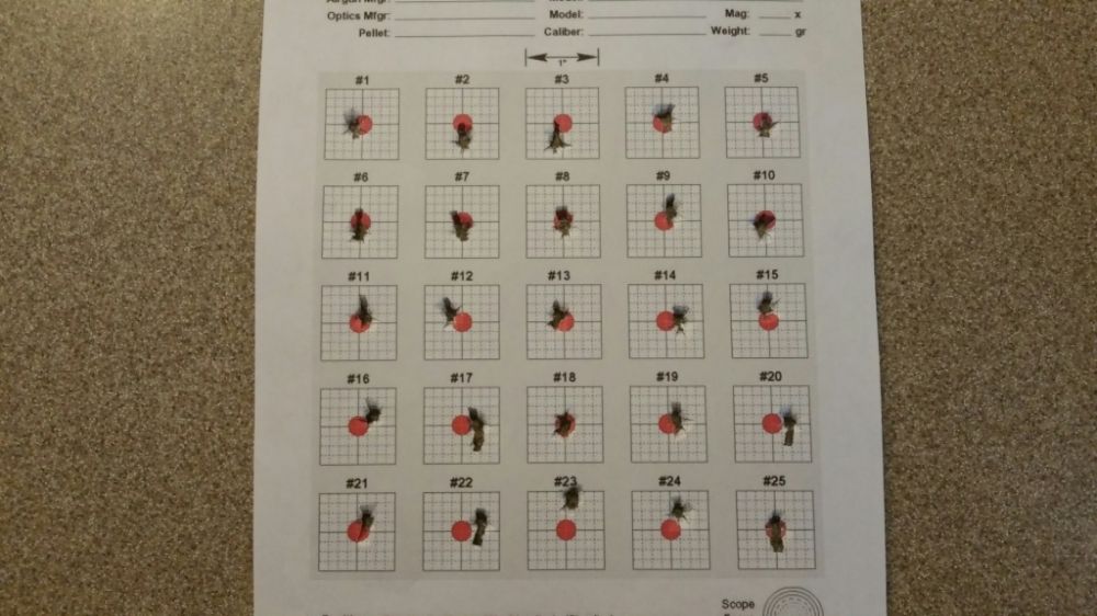

New Pellets, Sidewinder back on, and a good cleaning. Here it is at 35 yards. #23 and 24 are no shooting grip, just a pull back on the trigger to test my grip difference. All shots within 7mm of center except #23 at 10mm. That is 1/2 inch group (minus #23) at 35 yards on 25 shots. Feel a bit better now. Ill shoot that again and then take it out to 50 after the Holiday.
Looks good, consistent, curious how the 50 turns out but seems like no issues on the 35. May be some pellet check for consistency. I am happy also with my latest groups as part of my go-to pellet search quest, but now that I have a couple of good ones I will try to sort my pellets again for weight as a minimum. At 50 it may not make much difference but at 100 yards it will. Need to also double check head sizes.
