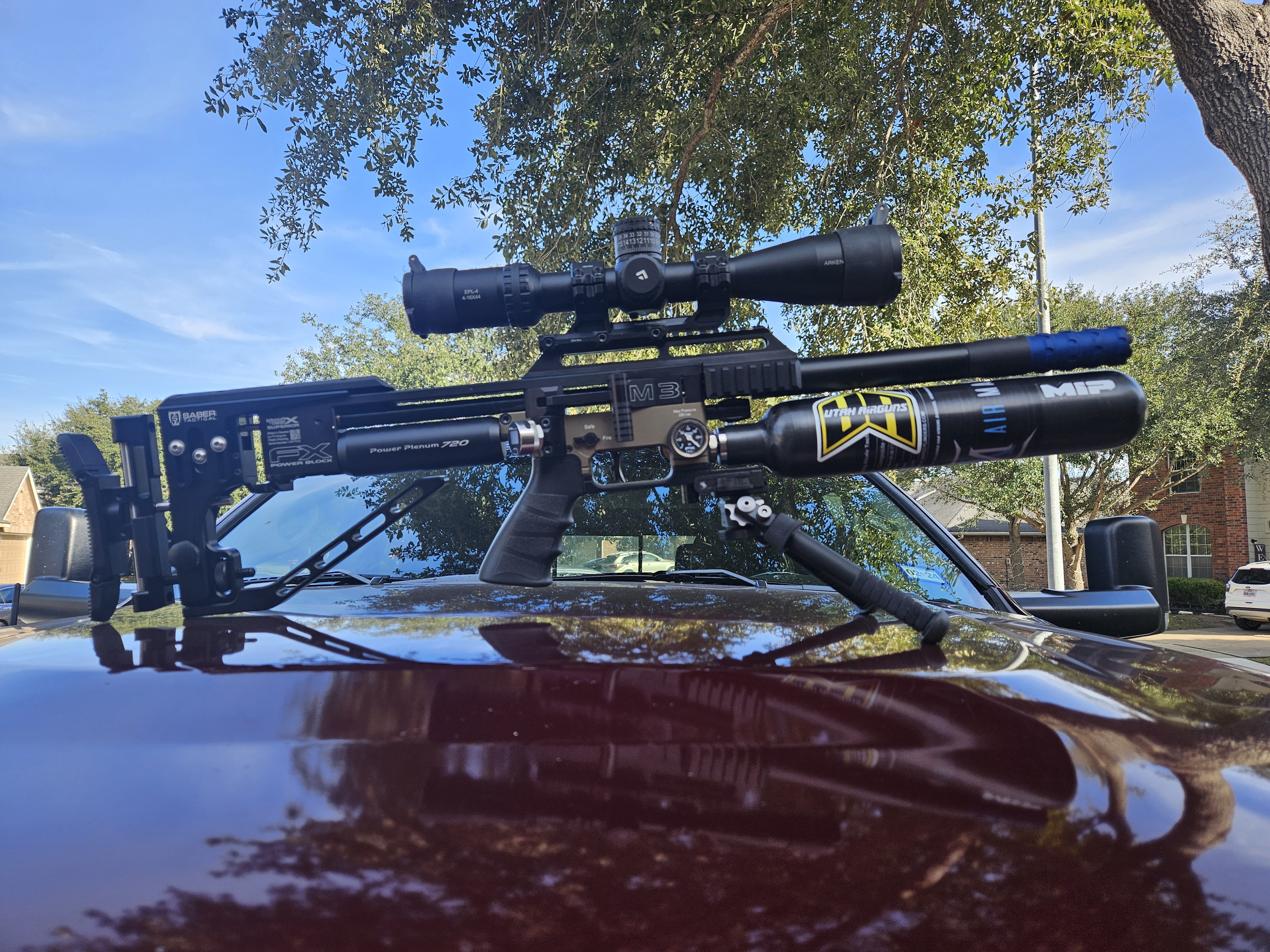

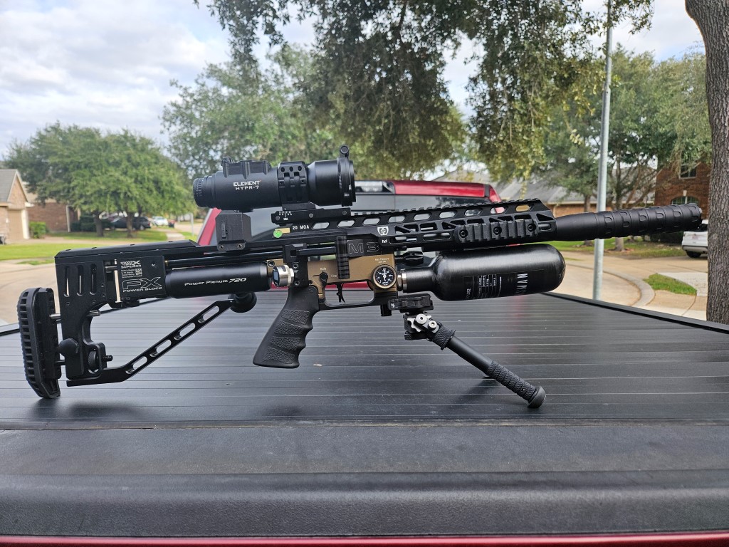

So I finally got dream build finished for close range pest control. It's my original M3 Compact in a .30 cal 500mm config and a Element HYPR-7 prism scope. I tried out a few LPVO's with tactical turrets and turned my interest toward a 4x-5x prism sight. The only problem was they all had BDC recticles for 5.56 or .308 drops. The HYPR-7 was the solution for that.
So this is powered by a Air Marksman 300 bar bottle and the only internal mod so far is a FX tungsten hammer. It's pushing a JSB .30 44.75g pellet out at 878 FPS. I have three Impulse Air mods and I really like them. With just the shroud it sounds like a .22 going off. The Impulse 1350 with two extra baffles makes it really neighbor friendly.

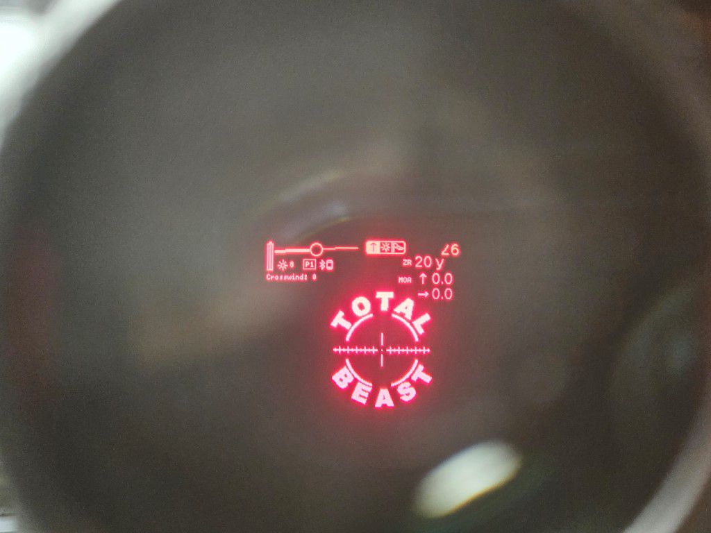

The HYPR-7 prism sight was everything I was expecting and more. The glass is amazing and the digital HUD shown on the internet does not do it justice. The text and recticles were crisp and clear. I just had to make my own recticle for this beast :)

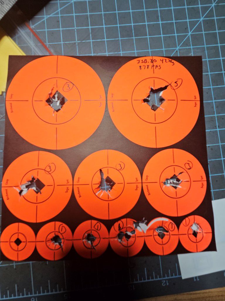

The digital zeroing on this scope is sooo dam easy. I took one shot and hit paper. Then fired off the rest of the mag and punched these holes. I'm really proud of that top right with it's 5 round group. You can see the single sight in round on the bottom row where there are two holes in one of the small bullseyes. Most of the 3 round groups were a little larger that what is shown. When I laid the target flat some of the blown out paper folded back in the main holes and makes the group look tighter than it really was. Still, I'm pretty happy with the result considering it was done with a low powered prism scope. This was shot at 25 yards.

If you don't need the energy or wind bucking capability of the .30 I would stick with the .22 or .25. You really have to push a stock M3 hard to get the 44g pellet moving past 870 FPS and it eats a 380cc 300 bar tank in about 30 rounds. You could get a full 21 round mag off in a stock 380cc 250 bar tank but I think you would need to pull back to around 830-850 fps. This is with a short 500mm barrel. I'm sure a 600mm or 700mm barrel and a 580cc tank would be so much more efficient. I just hate when my dog corners a possum and I'm running though the house with a 700mm barrel + 6 inches of moderator, and pop that long ass floppy barrel on a doorframe. It makes me cringe.
A great all around configuration, IMO, is the Compact .22 with a full size 580cc bottle. Below is my other M3 which I shoot most of the time. Now without a mod, the bottle extends way past a 500mm barrel. I could have just gone with a 600mm w/o a mod but I needed it quiet. So I found that the Impulse Air 1200 series mod is small enough in diameter to fit side by side with a bottle. The bottle on it is an Air Marksman 580cc @ 300 bar. I can shoot all day with that thing without refilling. You could do this on the M2, your friend has for sale, as you don't need the big 72cc plenum for a .22/.25 pellet.
