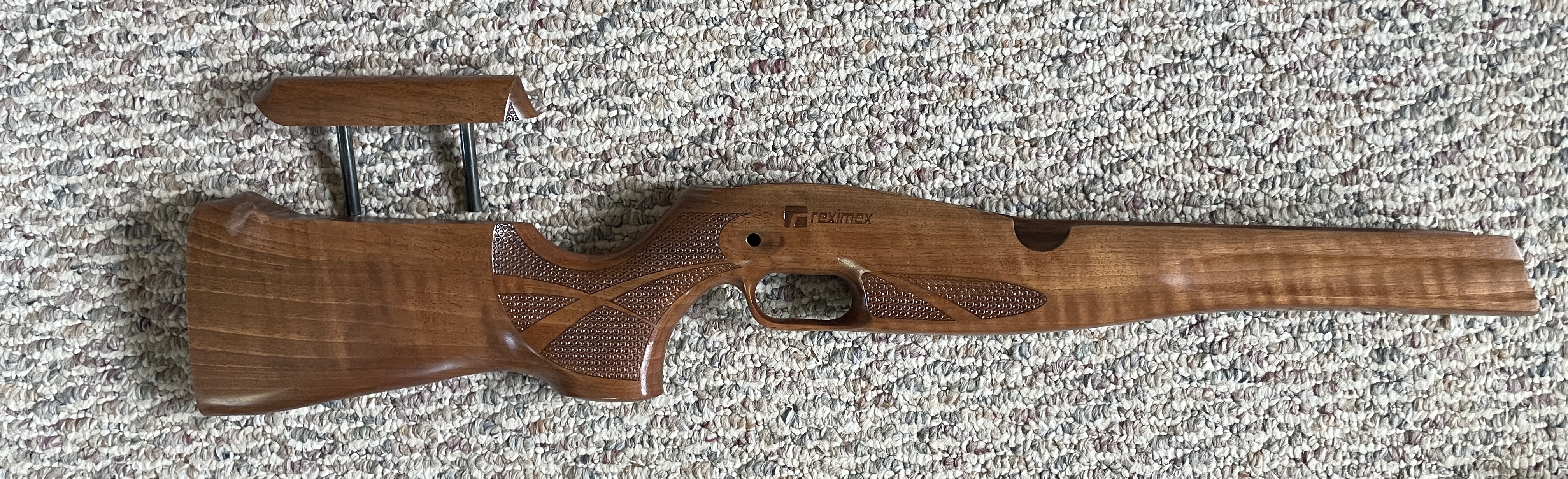

Nice looking rifle........Why can I not find a picture of the other side?

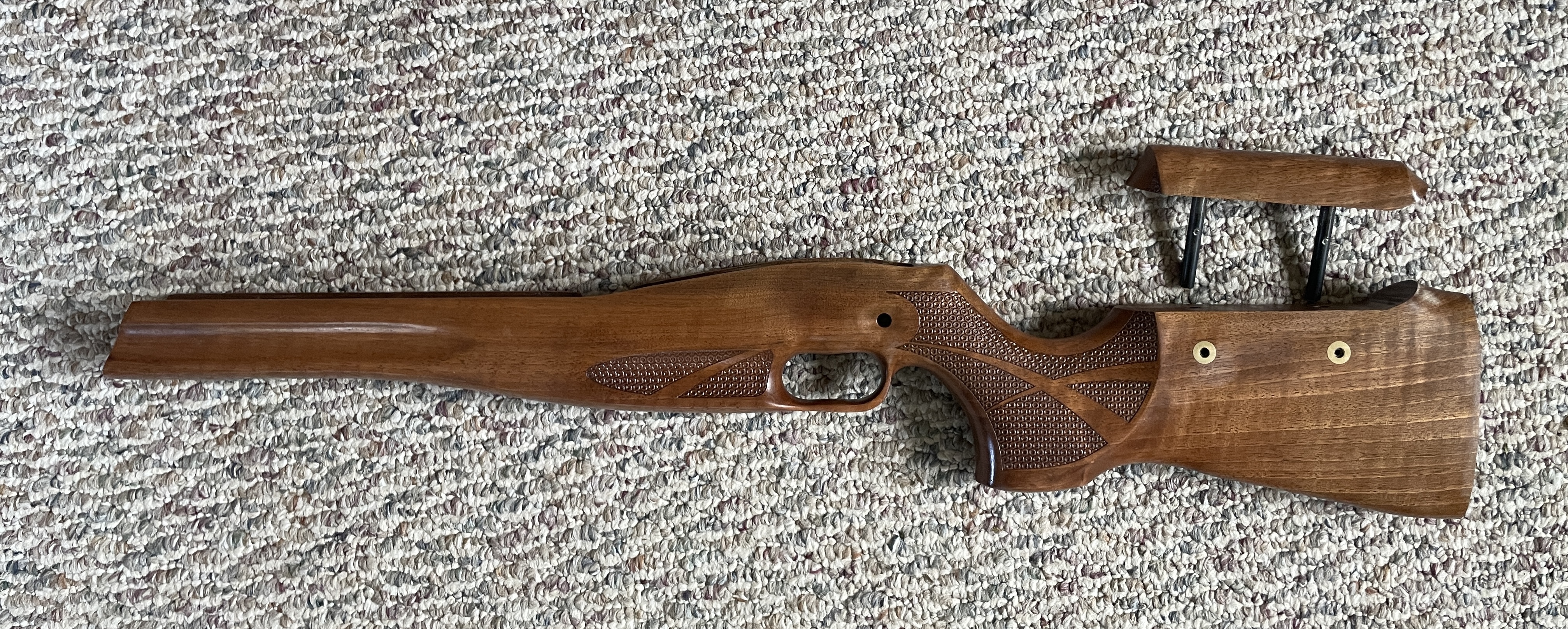

I’m currently refinishing the stock on mine - stripped factory stain and rubbed in Tru-Oil.
This is both sides of stock. Pressure gauge is on side of rifle - otherwise the action is identical to Benjamin Cayden - with a bit better fit n finish than Caden on internal parts as well as a prettier stock.

Thanks for the pics.
