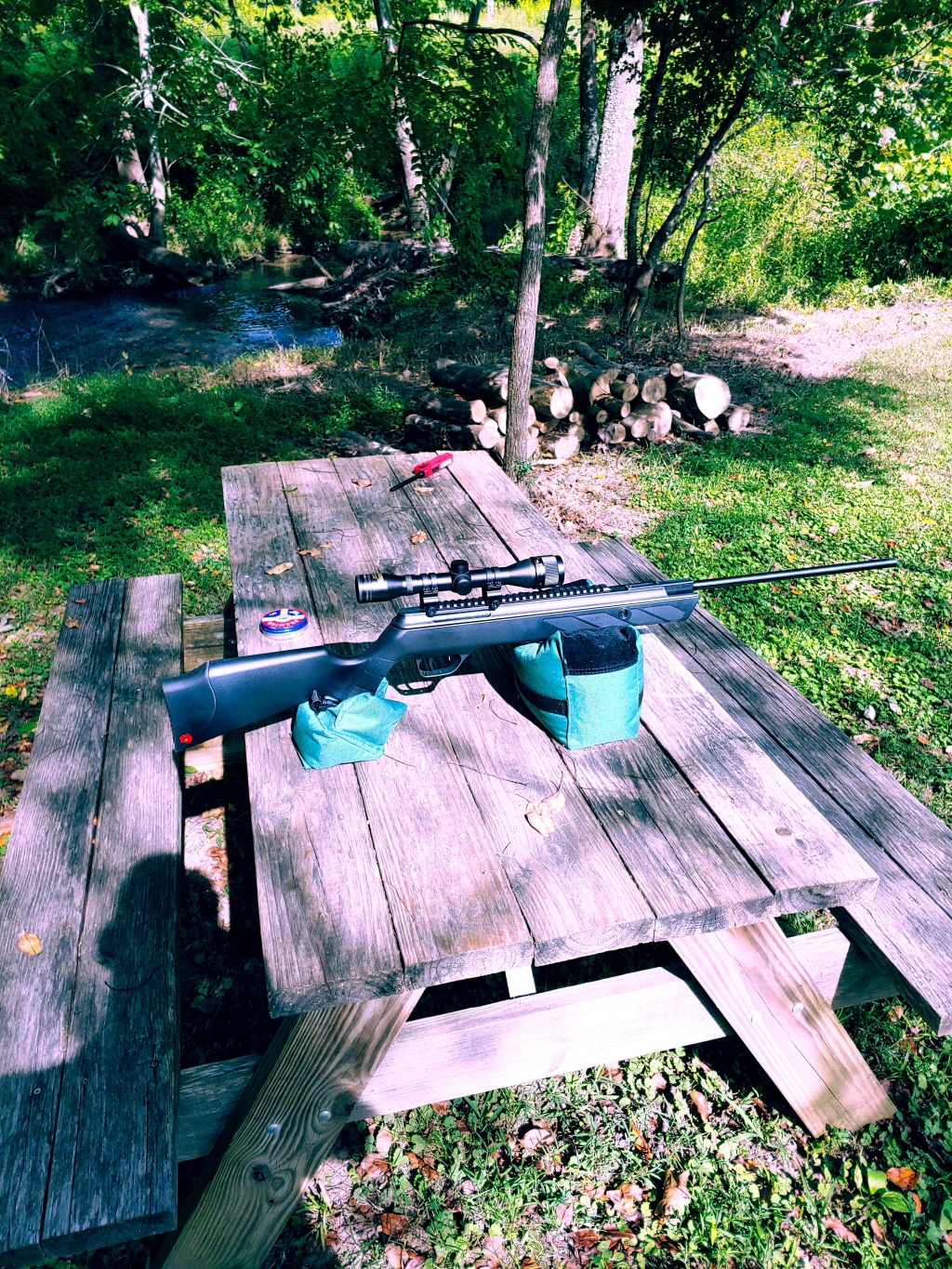

I ended up tuning a Ruger Air Hawk. Pic at bottom.
1 inch groups at 50 yards, I cant complain. I paid 58 bucks for it. I got the trigger down 2.2 lbs, did the seals and few other things to smooth it out. I put a Winchester by Daisy on there. I have been able to hit soda cans at 100 yards with H&N sniper mags. I'm getting 778 fps out of the 15 grain .177.

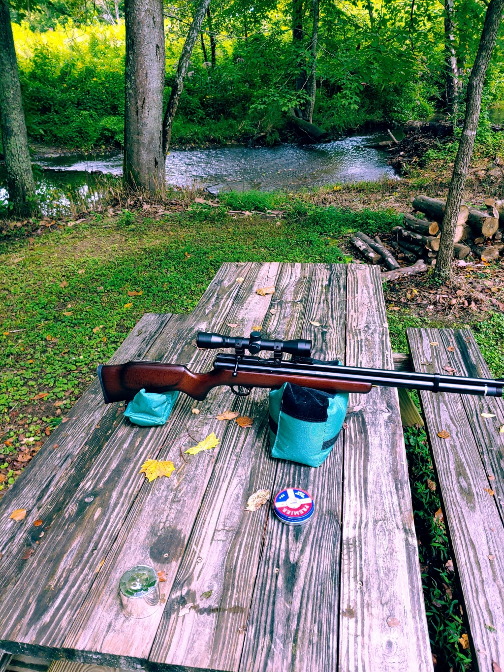

Sorry for the delay. I did alot of buying selling, trying. Watched ever video review by Steve. I tried the Gaunlet, Stormrider and finally settled on the Chief. It took some work but after cleaning it up and installing a regulator. I love this gun! 35 shots at 1500 psi, with 3,000 psi fill. H&N baracuda 895 fps with less than a 5 fps spread. .8 inch groups at 50, 1.6 groups at 100 yards.

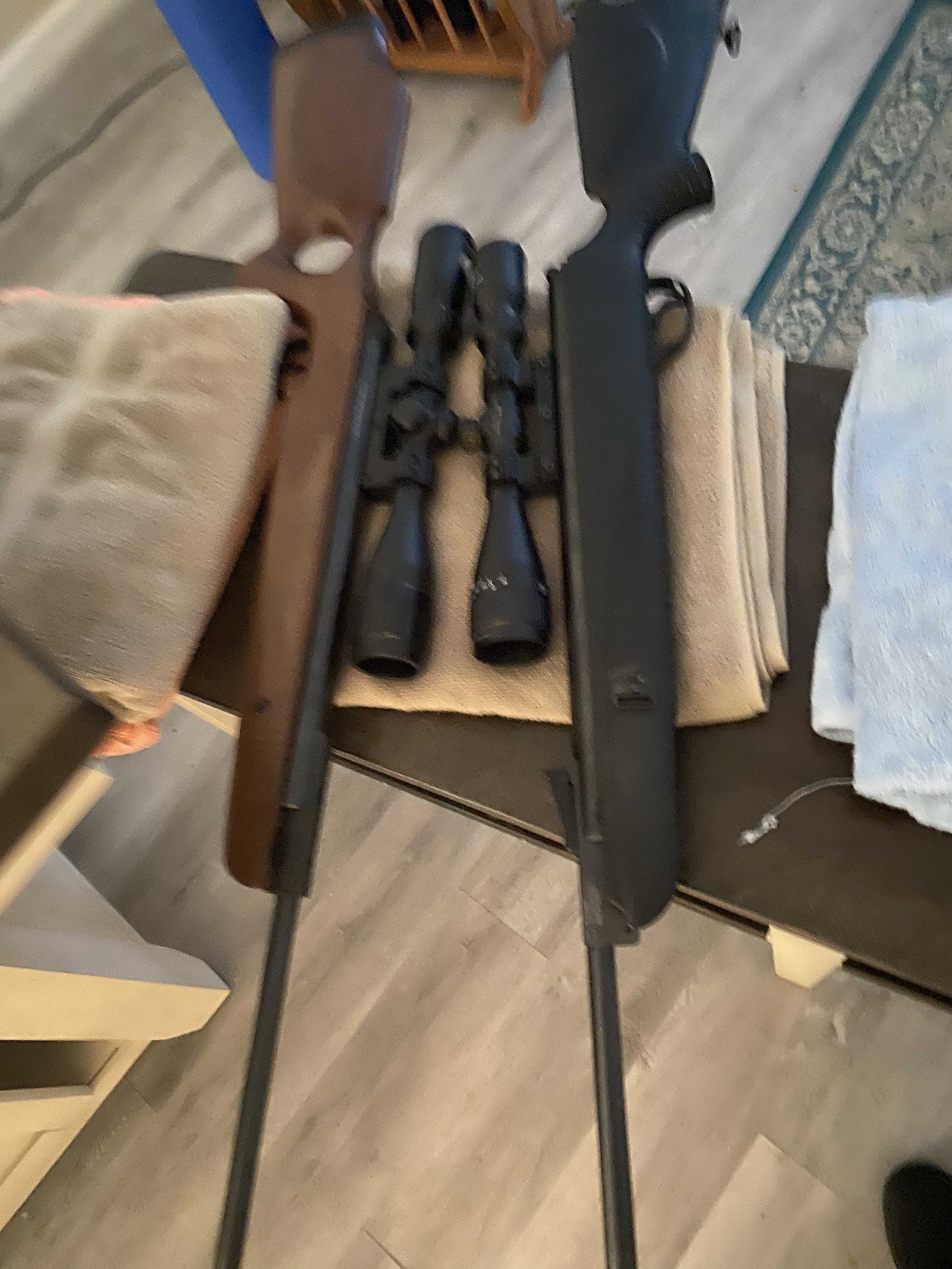

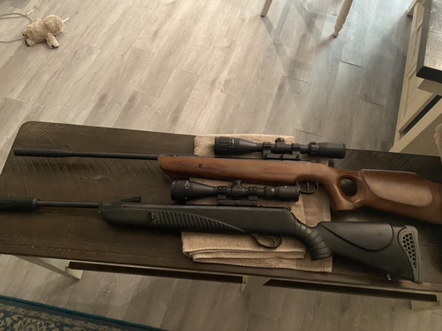

Shoot I just got back into it after 10 years
Unearthed a first gen air hawk elite with ruger 3x9 and a black synthetic Hatsan 95 w a 3x9 40 CP scope.
both .177
Both still sighted in at ten yards ...
They join my tuned custom bull barrel Gamo 220 and a tuned Webly Tomahawk
I’ve always liked the hatsan 95 Very accurate Great trigger
