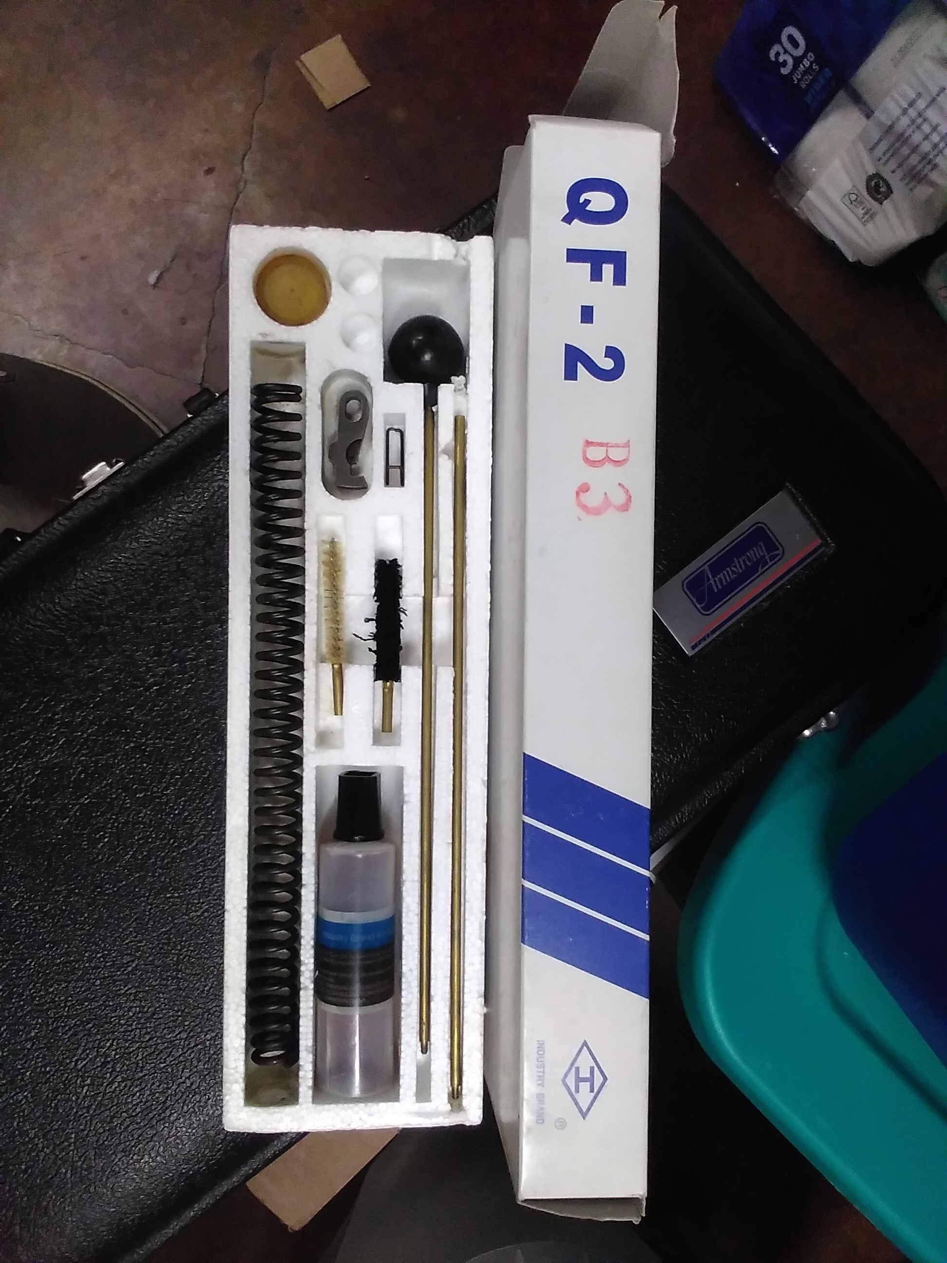

I have recently worked on 3 B3 air rifles and was starting to feel pretty cocky (pun intended) about my understanding of these warhorses of the airgun world.
But the one I recently snagged for $20 as a "parts" gun (because it was missing parts) surprised me...
As it came, when I stripped the action, before removing the infernals, I tried to cock the "bare metal" (no trigger group installed), and it seemed to be totally seized. However, it came apart with no issues (I didn't notice that the spring was too long!), and when I cleaned and deburred nothing interesting showed up.
When I put it all together, I should have noticed that the free length of the spring was a little long. When I tried to test cock it it felt seized up... I really leaned on it and discovered that it was just extremely stiff - Impossible to cock. Took it apart and noted that the free length was 2-3/4". By my ballpark estimate that's roughly 100 lbs of preload! That works out (to my estimatin') to about 50 lbs just to get the underlever started!
My suspicion is that the previous owner had replaced the spring and got in over his head, and passed his fun project along to me.
Easily fixed by trimming a few coils, but gave me fits with it being so stiff that it felt totally seized up! I'll get back to it when a few days have passed and I've forgotten what a PITA it was...
Live and learn!
