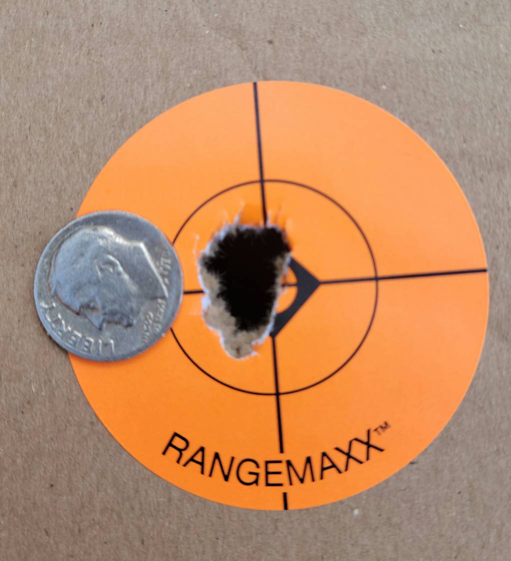

It must be that something is wrong with the rifle, I’m remembering pictures of groups that L.Leon has posted and the groups show that they can be very accurate rifle’s. Impressive at 100 yards even. Last year I ordered two LW .20 barrels and had them sent to AZ because he was going to build two hot shooting .20 caliber guns, one for me and one for him. Both barrels were far less than perfect, the first one he tested could only get a 3/4 inch group at 60 yards, same with the other barrel. They would be ok for hunting but definitely worthless for target shooting. That’s two brand new LW barrels that preformed like that. The LW barrel on my Rapid .20 is incredibly accurate, but not those two. I’m not bashing LW barrels, just saying there are some mediocre ones, maybe you simply got a dud barrel. It almost seems like it could be clipping pellets too. Best of luck working it out.

My Brocock Bantam MK1 .25 cal (unregulated) was pellet on pellet at 25 yards and 0.5" at 50 yards. That is until it took a header off the table. Then it went to 6" group. I checked the moderator and it had bent the inner steel disk. Tried a buddies Tonto, which is shorter, and we are back to close to what it was, but something is still "OFF". I've sent it back to AoA for checks and any repairs needed.
