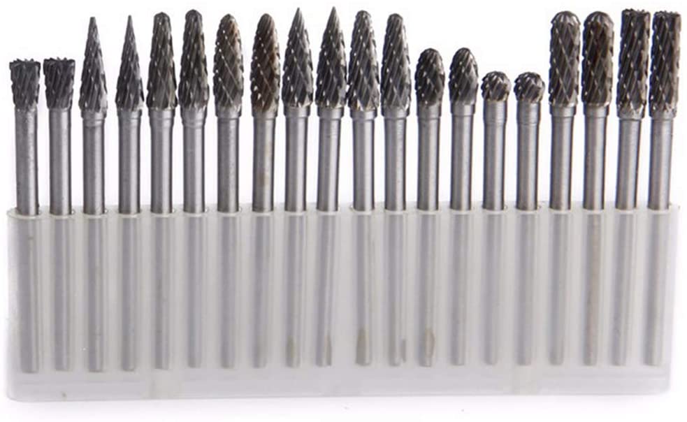

No need to drill out threads just open it up with a carbide burr in a rotary tool like this. I've never come close to running the battery down even on long jobs.
Go slow with a firm grip and a light touch. Don't try grinding stones on aluminum they just pack up with aluminum and become useless.
