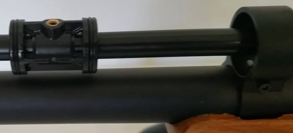

Well, here's the opposite experience of what one would expect;
Synthetic stock accuracy = great, but switch out to wood and gun shoots 7-8 inches lower at 40 yards and group size doubles... Tried different torque values on the action screws, but so far no joy.
Can slip a piece of paper from front of action to barrel band without any snags.
Receiver to stock fit seems great.
This situation has me baffled.

The barrel is supported inside shroud just forward of the band.
I've switched from the plastic stock to the wood stock, and have added the DonnyFL adapter + a moderator. The gun's POI still tends to hop around for me. This weekend might be research time - I have a few scopes, a couple of guns, and a ton of pellets, so I might swap them around a little bit and see if I find a pattern.
As for accuracy, I shoot the wooden one better now than I did the plastic one then. Plus it just looks better.
