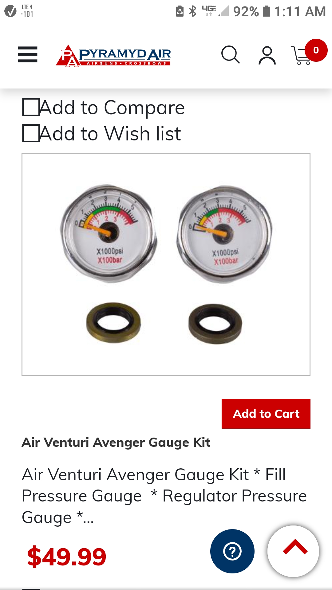

Mine does the same thing just not that extreme. I talked to Stacey at Air Venturi and she said it was probably the guages. They are not precision guages and may be reading higher/ lower than actually showing. You could try ordering a replacement for the pressure side. The new one may match the regulator side better. Or order both and see if you get lucky.
Not saying this will correct your problem. But may be worth trying. You can always give Air Venturi a call.
