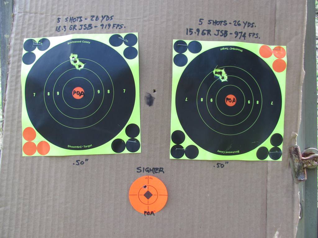

Avenger .22 shooting JSB 15.9 GR and 18.1 GR at 26 yards. Rifle zero is 50 yards, but only could shoot 26 today.....Baracuda Match 21.14 gr went all over the place.
That's incredible shooting 15.9gr that fast. How does it do at 888fps max?
I'm going to adjust Hammer spring and test over chrony/target. I think one full turn reduces FPS by 100. ? My Marauder shoots .25 Kings lights out at 860 FPS and I have another rifle that shoots 15.9 gr JSB at 940 no problem....So I plan to reduce speed by 50 FPS.
Ok backed off hammer spring adjustment think near half turn...Net reduction FPS was 35 for the 15.9 GR...and 33 for the 18.13 (For those who may want to adjust theirs)

Not a big difference but then there was only 2.3 GR difference in weight. Wind was nil....I just now measured from red bull to bottom of each group and there is 1/4" difference.
The windage looks like maybe a half inch; I guess Barracuda's don't like the speed or maybe the gun doesn't do well with them? Thanks for doing this and posting it - I've been very interested in this gun for a while.

Right about windage. I have not tweaked it yet. I have 4 new tins of Baracudas so I;ll give them another chance later on. Maybe in the DAR when I get it back.
